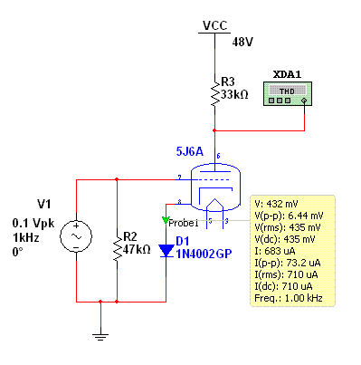

when I built this the THD% using the 12AU7 model I have simmed the same as the one I breadboarded. I've used LED's on the cathode for a number of SY designs but here you are really constrained by low plate voltage:

You probably won't have much distortion from the diode (that's something I've never been able to measure in a wide variety of circuits), but you may very well have unexpected distortion from grid current, which usually doesn't show up in sims. Many tubes of that class start showing significant grid current at Vgk < 1V or so.
Sorry, I misread the data. 6.44mV of signal across the diode is pk-pk, not pk or RMS. However, that would still give a few % of 2nd? (assuming a diode behaves something like a BJT Vbe? Vsig pk = THD 2nd % ?) Would be reduced because it is only a small part of the total signal. So 3.2mV gives 3.2% 2nd, but the diode signal is only 3.2% of the total so I make that about 0.1% 2nd due to the diode.
If the valve model includes grid current (some do, some don't) then you can check for distortion from this by adding some impedance to your signal source.
Tony said:
I realise that with the forward biased diode, you are limited to an input voltage of 0.7 volts peak if you are to avoid getting the grid in positive region
No, fortunately it is better than that. Most of the signal is developed across the grid-cathode so the diode only sees a fraction.
However, it is not the grid going positive you need to worry about. As SY says, grid current can start well before that. I seem to recall that the books warn that positive grid current can start anywhere between -1.5V and -0.5V, and the threshold varies not only from valve to valve (even of the same type) but can also change with ageing. I try never to have a grid more positive than -1V.
OK, I straightened out the SIM by using the Leach models and setting the coefficients such that the VI curves look like the 19J6 datasheet.
With the diode and the sections of the 19J6 in parallel, the THD% was 0.31%, with a 2K resistor per the Starving Student schema it was 0.052%

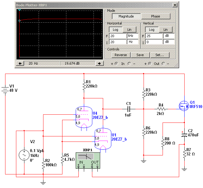

Here's what I'm driving at -- gain is just a hair under 20dB. THDsims out 0.015% @1V out. The resistor R8 represents the heater impedance of the 20EZ7 high mu triode. I adjusted the Leach coefficients until I got something resembling the 20EZ7.

Made a couple of changes -- R1 =55k, R5 = 2k2, R3 =110k. Did away with the CCS. The output cap is an Elna Silk 220uF/50V, the coupling cap that shown in the design 0f 100nF.
Changing R3 biased up the MOSFET a bit higher, while loading the amplifier a bit more. Gain is 19dB. The 5% THD is ~5V out.
The above is with the 20EZ7 -- filament voltage is spot on at 20V.
