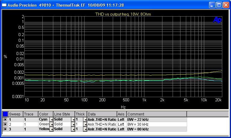

A test of 49810 with Class A output stage shows THD < 0.005 % for 10 W into 8 Ohm. The harmonic structure is more important than the pure THD number.

Agree on harmonic structure. Though at O(0.001%) THD I'm unsure how much details matter since everything is really small. 😛
10W is pretty loud, particularly for triamped nearfield listening to computer speakers---assuming 90dB efficient drivers that'd be roughly 109dB at the listening position. 60dB is probably more typical; that's roughly the SPL of an animated conversation. Power wise it's in the vicinity of 500uW per side, with around 225uW into the mid and bass and 50uW into the tweeter. The numbers'll obviously shift around some based on the speaker design and driver choice, but the power range of primary interest is likely the 10uW to 10mW space. That's usually comfortably within the class A range of a class AB.
Does pure class A offer benefit at such powers? I've seen 3886 and 49811 class AB measurements which go that low, but were done on equipment with a THD floor of 0.003% and hence could only report the 49811+STD03 was below the noise floor. In comparison, the 3886 was around 0.6%. Not aware of any data for a 49810.

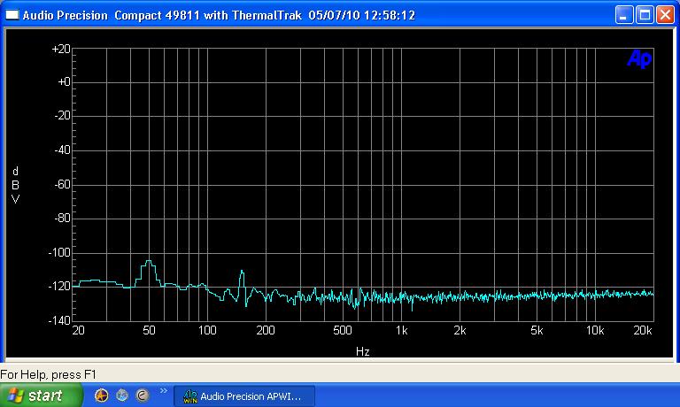

output noise from a 49811 amp
The output noise from a 49811 amp (Compact 49811 with ThermalTrak) is measured. Note that the amp is not placed in an enclosure. The input of the amp is shorted to its input ground. The measured noise level is 32 uV (BW=22 k) or 40 uV (BW=30 k). The FFT is shown below. The gain set resistors are 5.6 k and 240 Ohm. Their thermal noise affect output noise level. Low resistance should be use.
The noise level shown in 49811 data sheet was measured from the Fig 1 circuit. The gain set resistors are not optimized for low noise.

Why do you say it's thermal noise and not voltage or current noise from the 49811? The 1.8k input impedance National uses is a pretty reasonable tradeoff between resistor size and preamp drive current requirements, but in my experience that means the dominant noise term's current noise through the 56k. With a 5.6k gain set I'd guess the dominant term is probably still current noise from the 49811, but a 240 ohm input impedance is not a terribly practical configuration due to the input current requirements.
Not to sound like an op amp fanboi, but this is another reason why combining a unity gain stable op amp with output transistors looks attractive for low power amps. Current and voltage noise from the chip is lower and, since all gain set resistors are the same size, it's possible to choose resistors in the 1-2k range where the voltage and current noise terms are comparable and the drive current requirements on the preamp are reasonable.

Unfortunately, the LME498xx data sheets do not provide parameters commonly found in opamp. Without those data, how can we minimize noise? One approach is to use as low resistance in critical parts as possible.
You have been suggesting using unity gain opamp with transistor buffer stage. Where do we get the voltage gain?
We're generally in agreement on resistor sizing. But one can also model things. And when I've done that thermal noise is usually one of the smaller terms in the noise figure.
As Thorsten just reiterated, for a 10W amplifier per the OP's request no voltage gain's needed; parts like the LME49710 and 49990 maintain good linearity to 10V. Reduce that swing by the STD03s' Vbe and you get about 10W RMS into 4 ohms (if you look at my first post in this thread you'll see I ask the OP what impedance they wanted 10W into for precisely this reason). Similarly, an LME49724 based H bridge---or fully differential amplifier, if you prefer to think of it that way---goes to 40W into 4 ohms, also at unity gain from a differential input. For power levels above that the 49811 is the best part I know of. But, as I've observed already, 50+W is not required to make a pretty good racket for home audio purposes.
