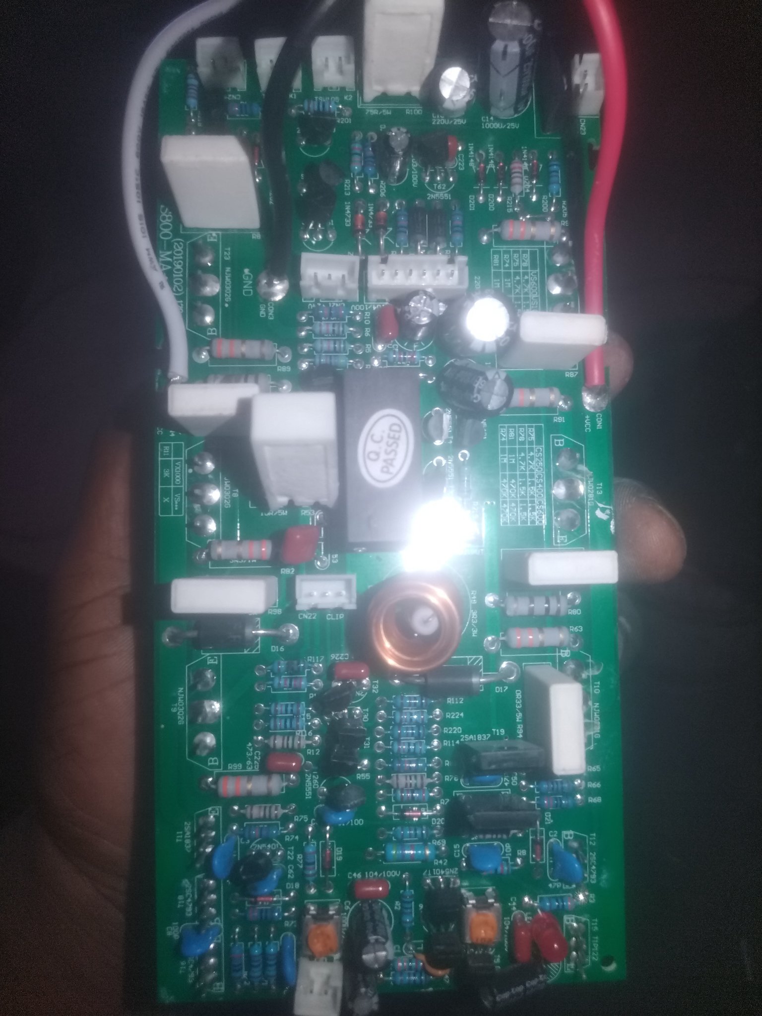

I bought new hybrid b1200 j-vs800-ma-a5 after connecting it and connecting speaker I have low sound
There is low sound coming out of the speaker and flashing red limiter light so I want to know what could be the problem

I plug it on the other channel and come out for some minutes and it burned next to white wire Resistor and next to big diode
Symptoms like this can happen if you're driving a defective speaker load (shorted speaker or wiring) or driving a dual voice coil speaker with the coils in parallel but out of phase.
