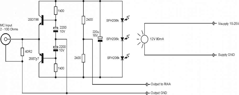

Generally I am not that slow....but I really can not figure what that circuit in post #7 is supposed to do. So, please enlighten me. Thanks, E
I have to admit I've stared at it a bit and can't convince myself that it can work, nor that it can't!
Conrad: How could you possibly know that it works (or doesn't) if you don't know what it is supposed to do! E
the photodiodes will be supplying a order of magnitude or two too little supply current for good noise performance at the indicated low source Z
🙂It is a mc headamp build on Marshall Leach principle and with optical powersupply.
It works perfectly well by the way, and has been used in several versions since the mid 80s. sounds pretty good too🙂
😀Right now i am planing some experiments of using infrared led`s instead of lightbulbs to avoid the light coming out of all the openings of the cabinet.
