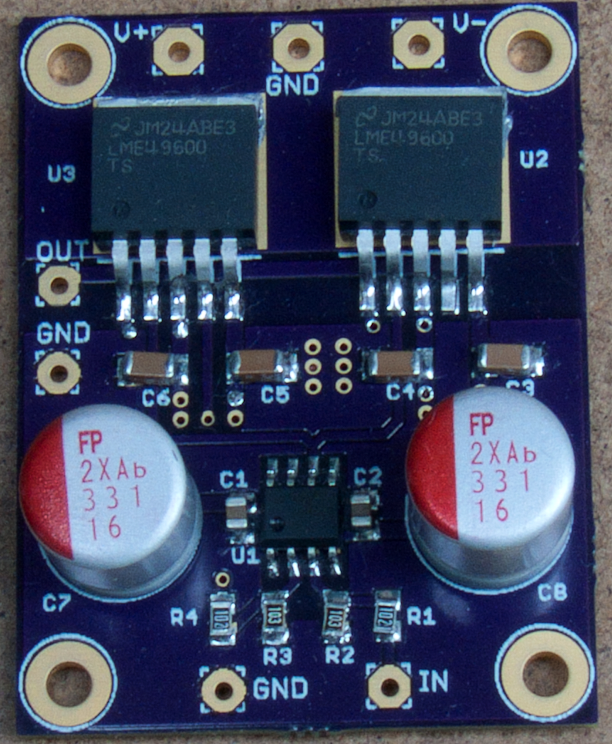

Yes.
But you can use a high quality opamp with a current buffer in the feedback loop to get higher current without any noticeable increase in distortion.
Something like this?

If you want an easy build without having to do a lot of research check out the Sunrise II from garage1217.com. I built one to use while I'm working on a more difficult headphone amp project and it drives my 55 Ohm Audeze LCD-2 cans just fine. It sounds good too.
Looks an awful lot like a The Wire...
Is that bad, is that good, is that wrong or what is then?
Looks fine to me.
It looks more like:
Or is "a high quality opamp with a current buffer in the feedback loop to get higher current without any noticeable increase in distortion." a "The Wire" when you use a lme 49990 and lme 49600?
Gr GJ
The Wire by OPC is a no compromise design that he spent a large amount of effort on and that has measurements that nothing else compares to (and isn't crazy expensive either). It is capable of driving down to 8 ohm loads.
Boards don't appear to be available at the moment because he's busy designing the next revision, which promises to be even better. You could always design a copy of it, try your hand a board design. It might not measure as well, but it shouldn't be too hard to make something that sounds great. I made some for myself with a couple of compromises to make things simpler (such as one board with power supply and two channel amp), but I would never sell them because that's just disrespectful.
"The Wire" Headphone Amp Build Wiki - diyAudio
http://www.diyaudio.com/forums/head...igh-performance-headphone-amplifier-pcbs.html
RE272s were measured as follows: 21 ohms @ 1 kHz (quite constant actually), 29 mVrms or 0.04 mW for 90 dB SPL. That's ~131 dB / 1 V, or ~104 dB / mW.
Aside from their lowish impedance, they are not particularly hard to drive. Actually noise performance should be of at least equal concern. Keep noise across the audible range under 10 µV or so, preferably a fair bit. (That already rules out, say, the FiiO E6 and E11.)
Note that "The Wire" merely is a headphone driver module, intended to provide a headphone output inside an existing amplifier or whatever. It does not constitute a complete self-contained headphone amp. Input impedance also is a bit on the low side for direct connection of a volume pot, you'd rather be driving this one with a preamp of sorts.
I'd look at an O2, arguably the most prominent DIY amp when it comes to low noise (almost 20 dB quieter than the E6, and among the very quietest headphone amps full stop). A configuration with low gain = unity and high gain = 2.5 ought to be just right. This one is a self-contained amp.
