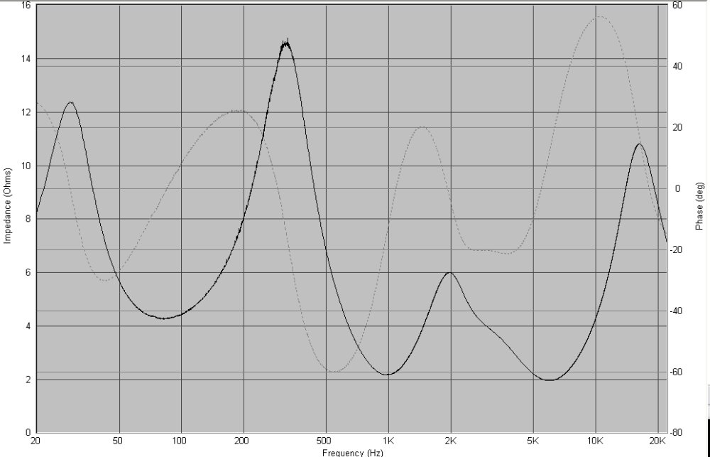

I recently finished my prototype open-baffle center channel speaker. It ended up being a three way using Dayton RS 8" woofers, Neo3 PDR dipole tweeter, and 3" Tangband bamboo midranges.
Crossover points are 500Hz and 3.5kHz, 2nd and 4th order L-R acoustic slopes.
The ONLY thing I don't like about the finished design is two low points in the impedance plot at 1kHz and 8kHz. With the exception of crossover point peaks, the average is around 4 Ohms, which was the target.
Those two aforementioned dips go down to 2.5 and 2.2 Ohms, respectively. It is a pretty steep dip, it doesn't linger down there.
My first thought is panic and redesign the crossover so I don't cook my amp. But then I'm thinking because it's at higher frequencies, even a low impedance won't demand a lot of current (and it's the current and heat that kills the amps)
Any advice on this? Am I being too paranoid? Ideas to fix it? Would a Zobel on the woofers or mids help?

Here's the impedance plot in question:

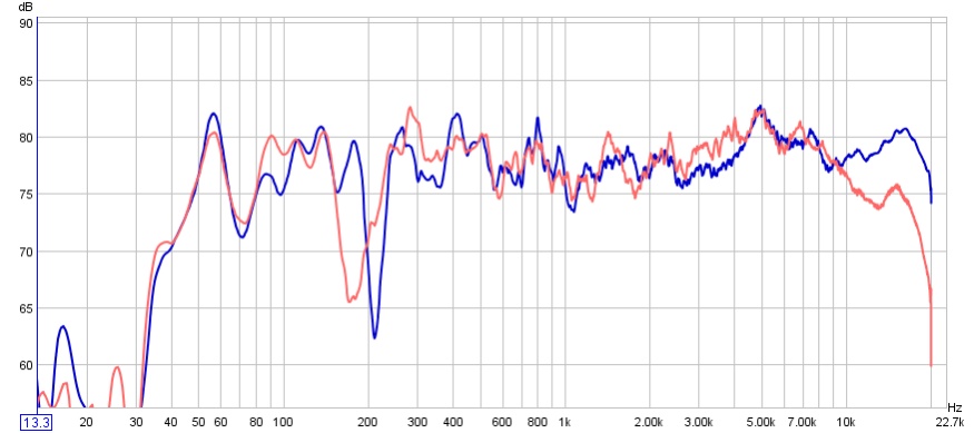

Well, I'll be the first to admit, I'm over my head here, but I would be curious to see the frequency response graphs. I think that would give the Impedance graphs more perspective.
Also, the precise model numbers of the speakers would help.

Sure thing, here's the REW measurement (non-gated, in room). 2m, on axis (blue), 30 degree off axis (red). BTW, 30 degrees puts this well outside the seats of my HT.
There's a room anomaly at 200 Hz. It shows up on measurements of my Magnepans as well.

I isolated this phenomenon to the tweeter crossover. The notch filter is doing the higher drop and the crossover itself is causing the lower one. I am attempting a redesign now to fix it.
My first cut got the lowest "theoretical" (PCD from the FRD tools) impedance at 3 Ohms. I believe this because my old circuit modeled spot on at 2 Ohms at the same frequency.

Most amps will survive an impedance dip down to 2 ohm, but at your plot you also have a big negative phase. Then the amp will stroggle more.
At about 750hz, you have 3ohm/-50 degrees. That shouldnt be the goal for an xo 🙂
Are you sure your measuring setup is 100% correct?
The SW setup and calibration can be hard to get right........
My measurement setup is non-ideal.
I can only measure in-room, with a pretty narrow gate. Plus I found out my test amp (MOSFET) shows a nice rising response in the top octave (as compared to the Outlaw amp). And I forgot to put my ECM8k correction file (also problems in the top octave).
so I was sort of chasing a ghost with that notch filter, since some of that rising response was amp+mic. However, I know some of it is real, since the Adire DDR design and other measurements of the dipole Neo3 show a large hump in the top two octaves.

First off, the Neo3 in dipole is a real bear to dial in. The notch filter that makes it work ends up dropping the impedance below 2 Ohms. That was for the 4th order crossover.
I did, however, design a crossover that was 2nd order for the low and high pass (500 and 3.5kHz). It's impedance drops only to 3 Ohms at two points and the impedance phase minimum is at 6 Ohms at 450Hz, otherwise, it looks very well behaved.
I had to use some resistors on the midrange crossover to help adjust the slope and keep the impedance up. Thankfully, I had efficiency to spare in the mid.

So bottom line: I trust my impedance measurements, I do not trust my acoustic measurements (completely).
I've already admitted this problem is over my skill level, but I have to ask, is 2 ohms really that bad?
From the discussion, this is functionally a 4 ohm speaker, is it that odd for impedance to drop that far for a 4 ohms system? I recall a commercial speaker system rated at 8 ohms with a side note that impedance could drop as low as 3.2 ohms.
I'm speculating that most Amp manufacturers know that rated or nominal impedance is something of an average; the speaker, in every case, will drop below the rated impedance. Further, this low impedance occurs twice, once at 1k and once at about 6khz for a very short span of frequencies. But I don't see any corresponding aberrations in the frequency response graphs. So, it may affect your amps, but it doesn't seem to affect your sound, and I think the affect on the amps would be tolerated unless you are abusing you amp in other ways.
As to the Zobel networks, they would certainly smooth out the peaks, but I don't think they would raise the 'dips'.
It will be interesting to find out what the final resolution to this problem is.
steve/bluewizard
can you find/calculate the phase angle plot for these combinations of components?
If 2ohm is resistive then don't worry.
But if 2.5ohm (either side of the impedance dip) coincides with 50degree phase angle, particularly capacitive, then you must design the amplifier to be capable of driving that severe load.
