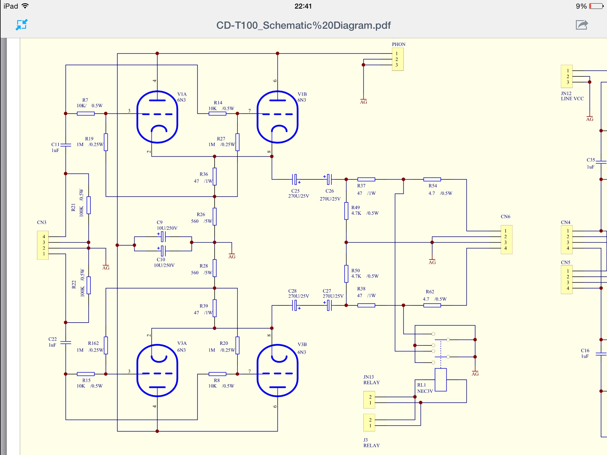

Can you post a schematic of the equipment currently in use?
