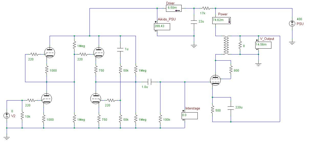

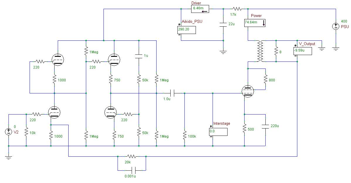

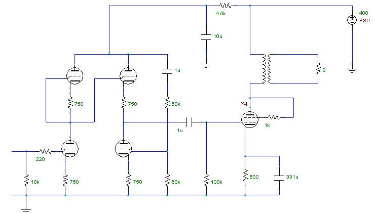

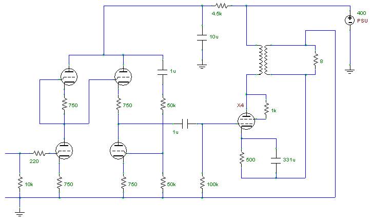

(4) D'oh! It is possible to use cathode feedback using ordinary transformers. Use the secondary itself as the cathode feedback. See circuits below. The first circuit is an Aikido driving an output tube connected in triode mode (no UL taps) with no global feedback. The second circuit uses the transformer's secondary as cathode feedback in the output stage (I may have the polarity wrong, but that's not the point). See how the output tube's current flows through the secondary? When output voltage appears on the secondary, it modifies the cathode's voltage, applying negative feedback. This means the secondary always has the bias current flowing through it, but it's very small compared to the secondary's capability (milliamps vs. amps). This current will generate a few mV across the secondary winding resistance. The third picture shows the cathode feedback with the secondary grounded. Don't pay attention to component values. I have no idea what I was simulating when I made these. Don't complain about the bypassed cathode resistor on the power tube. Use fixed bias if you want. It's just an example schematic.

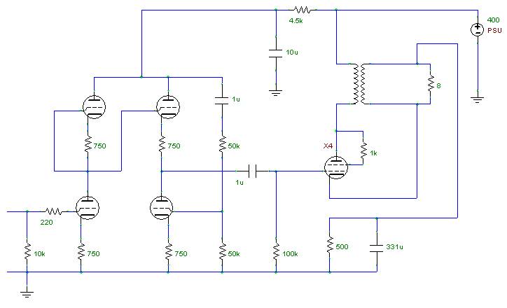

Attached is Aikido/KT88:
- Singled ended
- Triode output stage (can also be configured UL)
- Aikido gain/driver
- Ouput stage cathode feedback
With a 4800 Ohm to 8 Ohm transformer (impedance ratio of 600) and 400V B+ at 75mA, the KT88 can output +/-13V peak into 8 Ohms. Bigger impedance ratios will give higher output power, but also bigger (more expensive) iron. Attached schematics show everything, including safety resistors and grid stoppers.
With 12AX7 as V1 and no cathode feedback, the gain is 9.6V/V. Cathode feedback lowers the total gain to 7.4V/V. That's very minimalistic local feedback encompassing the KT88 and OPT. Excellent!
You'll get a little more gain with UL instead of triode mode.
Since the Aikido doesn't invert the phase, it's hard to implement an elegant global feedback along with the cathode feedback. It's one or the other. See schematic. Notice the OPT secondary is reversed. With the 20k global feedback resistor, the gain with a 12AX7 is 6.4V/V.
If I had to choose between local cathode feedback vs. global feedback, I think I'd choose the local cathode feedback. However, this is pure conjecture. The benefits of global feedback is the loop would encompass the gain tube (V1, 12AX7) and the coupling capacitor, along with the rest of the amp.
