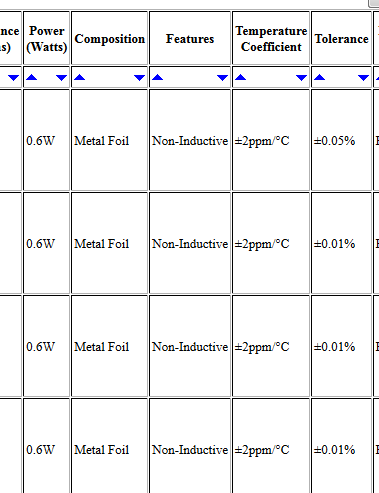

specific examples... as in brand, types, styles, power ratings...
of course I'd also like to know at what % of rated power these problems showed up (vs. metal film for example).
there is only a couple brands. Vishay Precision Group aka VPG is the main one, texas components are an offshoot of VPG and manufacture small run (as low as single quantities) custom value foil parts where you can choose the exact resistance, TC, absolute tolerance as well as matching in pairs, quads etc. for a price ...

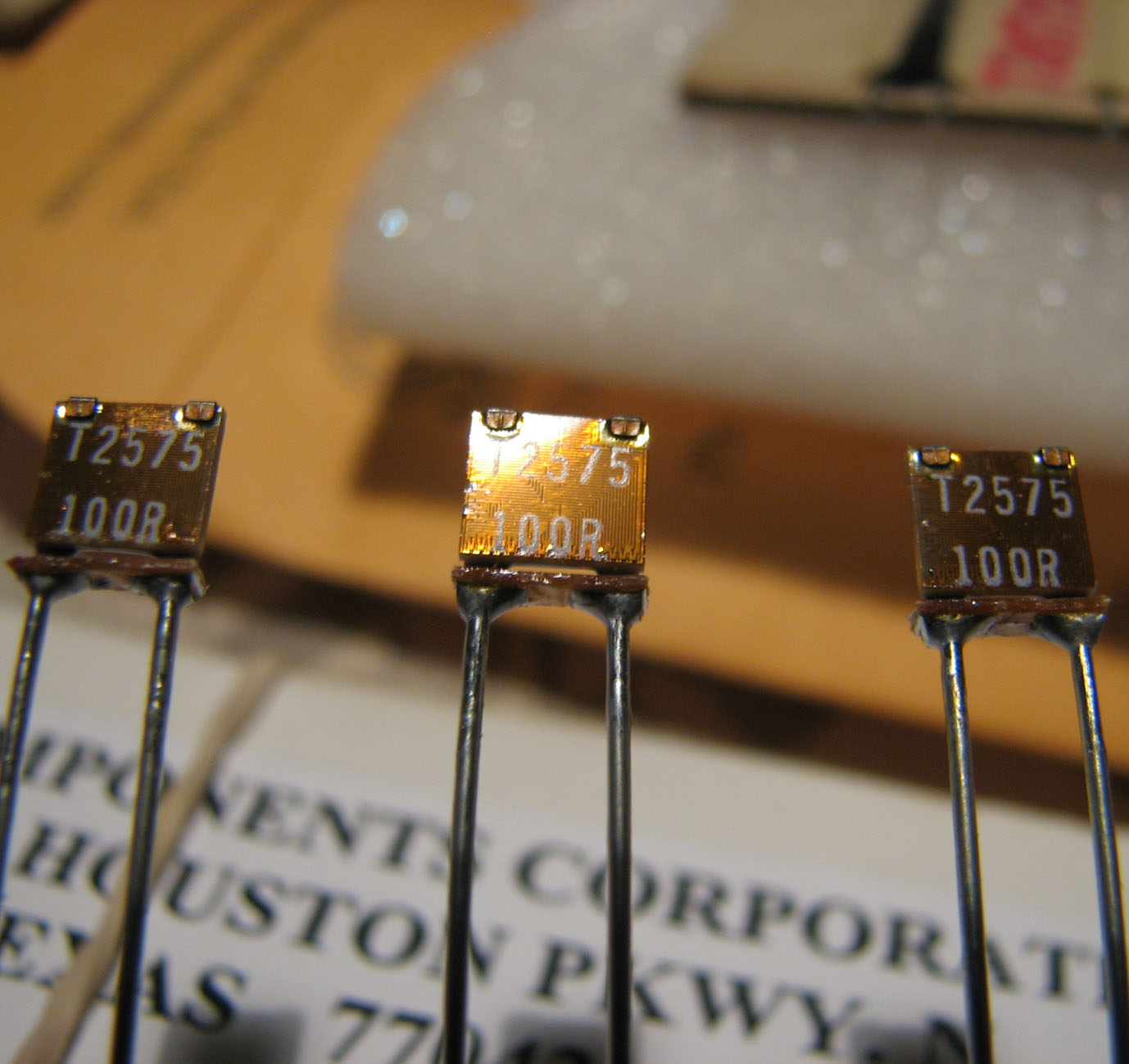

the best known part here on DIYA is the TX2575 'naked resistor'

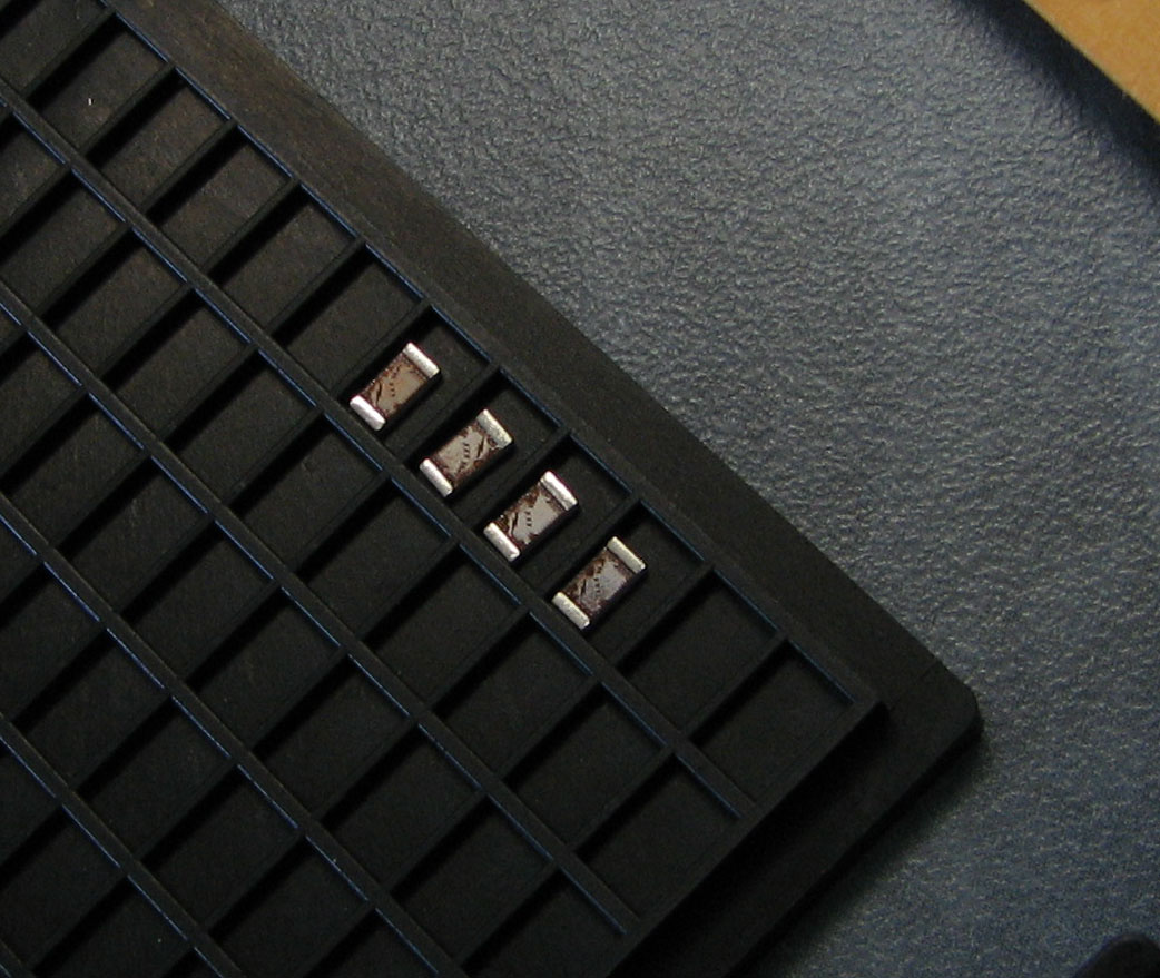

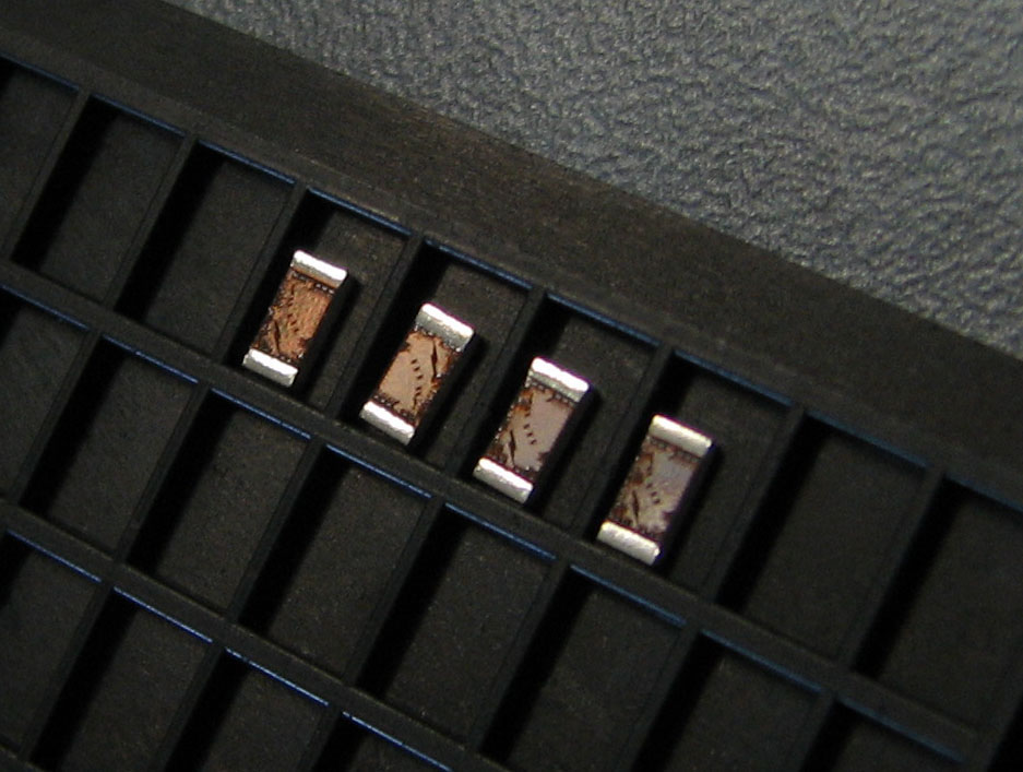

below is also some of my ASMP naked zfoil SMD resistors.

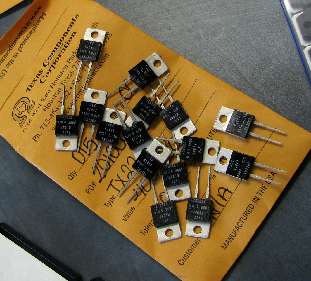

and some TX220Z power resistors
the 'naked' parts are only available from texas components, not vishay. they came about due to audiophiles there is no objective reasoning and they arent naked anyway. it was thought that no dielectric may 'sound' more transparent ... I get them for the excellent tolerance, ability to buy matched, odd values to 0.0005% and because they are sexy 😉
