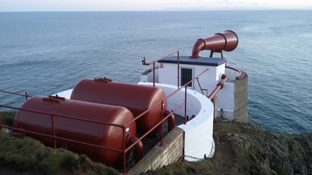

As a sound waves travel through air, they lose energy and consequently can only travel a limited distance.
Low frequency waves can travel further than high frequency waves because there is less energy transferred to the air.
Hence the use of low frequencies for fog horns.

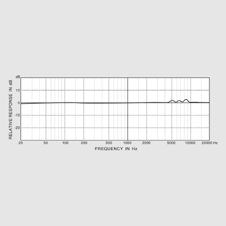

I'm not an expert on room analysis, but the Behringer ECM8000 is often recommended as it is flat down to 15Hz.
ECM8000 | Condenser | Microphones | Behringer | Categories | Music Tribe - Behringer)
Galu, that looks like the factory sales bumf. Not one of the 3 calibrated ECM8000 are close to that. One has to be take everything above 10k and below say 40 Hz with a grain of salt.

Perhaps the best that can be said is that the mic's performance is reasonable given its low (£30) price.
I guess we need to move into the £500 to £1,000 price range to really hit the lows.

It is a good mic for the price, but you really do need to get it calibrated. £30 is more like a used price. A new calibrated one is something like $130 USD.
