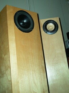

right now i just finished jx92s GM's ML-TL design, with triple plywood with sand sandwich between ply's.
the bass is clean, but because my room is pretty big, so i want some bass to add them.
i have nad 2x120 watts to powered them.
what kind of bass system that can play cleanly for them, because i tried with low powered 10" sub (50 watts, ported box, and some papercone with foam surround) that i have, the results is very dissapointing.

Maybe try some drivers that have very low distortion in the low frequencies, like the new Dayton RS series. You could do bass modules with 2 of the 8" drivers or 1 of the 10" drivers. Just a thought.
i'm thinking dipole woofer, or horn woofer that just produce bass, i don't need that thump kind of HT bass.
like PA's in concert or clubs u know
how about some pro woofer?

Stuff rags in the ports on the mains, and raise the crossover frequency on the sub. You may be surprised.

_henry_ said:ok, thanks dave
i'll try it
Well? Did that clean it up?
I probably should have said, "Seal up the ports," and let you decide how. If you put rags in them, stuff'em in good.
