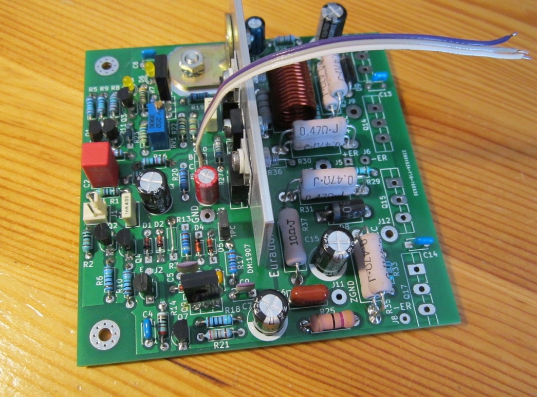

I have a low noise, low distortion distortion transistor audio power amplifier design. Built 2 mono and 3 stereo prototypes so far that work fine. This is a DiY design, but I believe it was more carefully tested under non-ideal conditions than the majority of DiY designs we encounter on the internet. The 1 kHz THD was measured 0.0006%...0.0013% on the prototypes depending on power level and load (loads down to 3.5 ohms, output power from 0.2 Watts up to 200 Watts /3.5 ohms). Below 0.2 watts, distortion harmonics are masked in the noise floor of my equipment even with averaging. Other kind of more challenging distortions like 19+20 kHz IMD and TIM(DIM) -- see images -- are low at all power levels and at all permitted loads. Capable of 200 Watts/ 4 ohms or 110 Watts /4 ohms output power depending on component set.

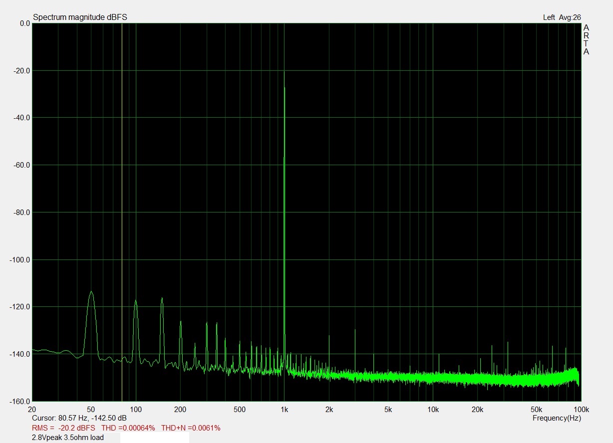

A nulltest (google "audio nulltest" if you don't know what it is) showed that the amplifier has no audible distortion at normal listening volumes, so it can be considered as totally transparent sonically. (Well, I understand some people like audible distortions if they color the sound pleasantly or interestingly. So this amp is for people who rather like reality.)
My open-ended offer is that I send you the kit you choose (one of the 4 different kits that are available) at a non-profit price. This means you'll get the specified PCB's and components at the price I bought them, and I won't charge my wage of labor either. I do this to make this design and the kits more popular among DiYers. I only ask in return: please give me feedback how I can improve the completeness and quality of the online information, especially the assembly instructions.
All kits contain the low distortion power amplifier board(s), power supply board(s) and protection board(s) and the components to populate the boards as covered in the online documentation. (User selectable components like chassis, main heatsink, main filter capacitors, power transformer(s) etc. are not part of the kits.)

[The image shows only the amplifier board without the output transistors and the tempco transistor. Those transistors are also part of the kits as well as other PCB's with the components specified in the assembly instructions, which, in most cases, are all the electronic and mechanical components that populate the PCB's.]

I don't see a kit in your offer, I just see a PC board...
If you want to sell kits, you'll need to sell the whole thing, otherwise you're going to get inexperienced builders firing these up with the output devices in free air and demanding their money back when things burn up.
I would go as far as recommending that as much of the PCB be surface mount components that are pre-populated, which will leave far fewer mistakes to be made by the builder.
The description of the kits can be accessed through the LDA home page. The main link is shown in my introductory post as "LDA home". But here is the sub-link for your convenience: http://euraudio.dx.am/en/amp/LDA/lda_np_kits_en.htm
The complexity of this project calls for an experienced electronics hobbyist and audio amplifier builder. Your idea of machine mounting some SMD's would be a really good idea if there were hundreds of boards sold. I don't expect there will be interest for many kits and machine mounting components for 10 or so boards is too expensive.

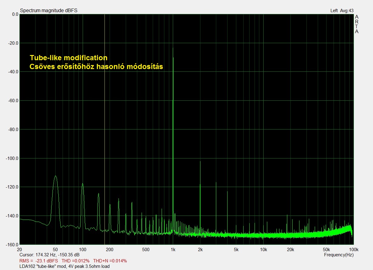

tube like distortion mod of the LDA
With a simple modification to the circuit (removing one resistor and changing the value of another resistor), a much higher THD with a tube amp like profile (high 2nd and 3rd order distortion products with very low high order ones) can be achieved, see image.
This is about 0.012% THD at 1kHz, which holds at all power levels and it's not changing much with frequency. It's still lower than the THD of tube amplifiers, though the looks of the harmonics is similar to tubes.

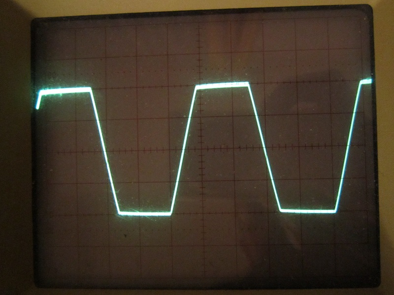

Clipping behavior of one of the LDA172hc prototypes overdriven with sine wave into 3.5 ohms resistive load. 1kHz (first image) and at 20kHz (second image). 20V/div
These tests representing almost 400 Watts output power, very unrealistic for home audio.
Clipping is not super nice, but it's acceptable with no signs of serious rail sticking or oscillation. Yet I don't recommend driving the amplifier into clipping, because it may generate some RFI noise through the loudspeaker cable. Knowing that normal listening volume is about 0.2...2 Watts average for home audio, power peaks above 400 Watts are not realistic.

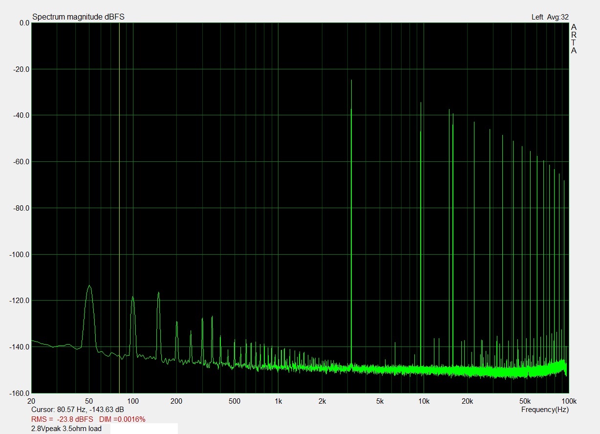

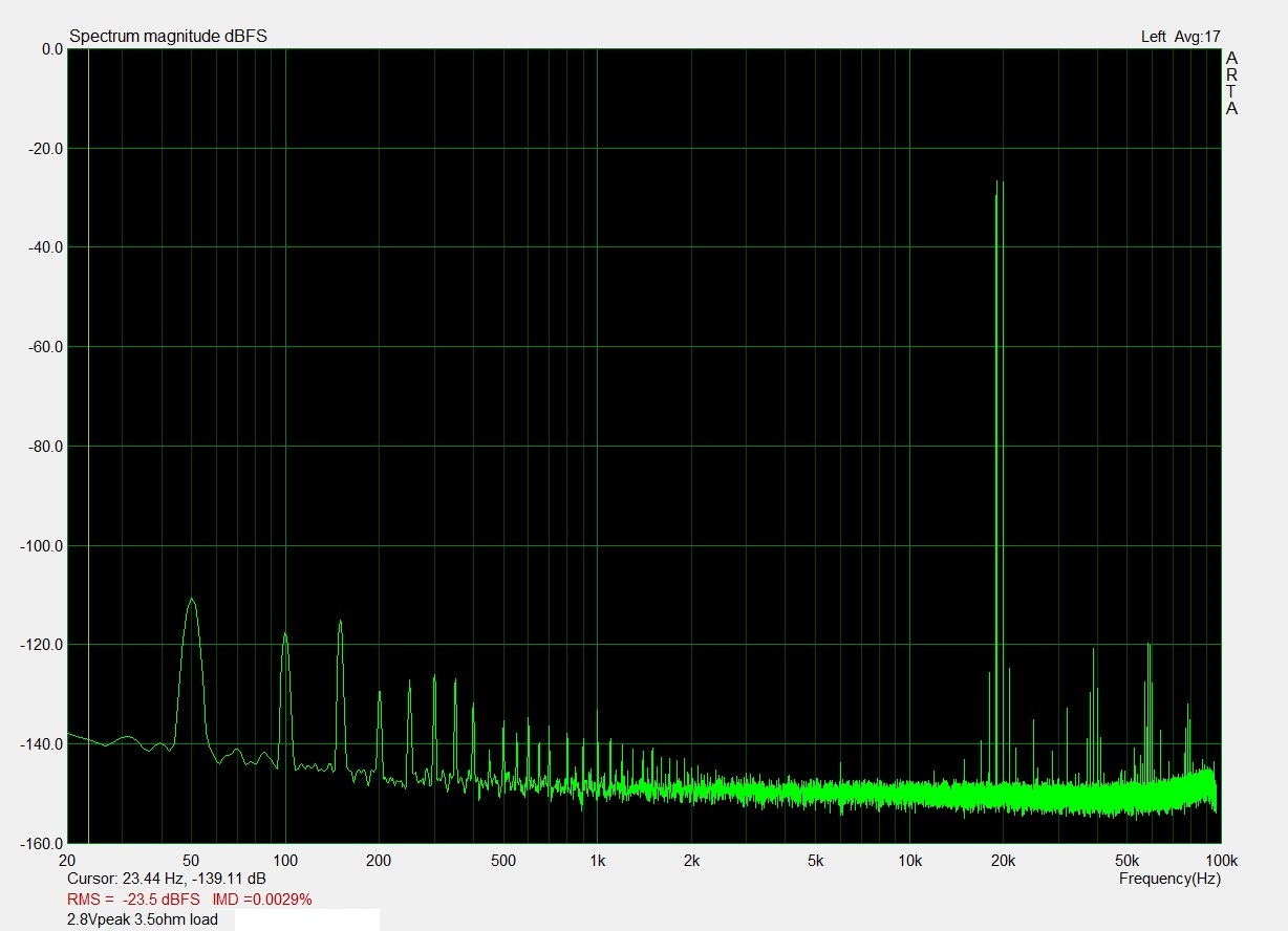

The following tests have been performed on the prototypes (2 mono and 3 stereo prototypes have been built so far):
1. Distortion tests
@ 2.8V peak output, 3.5ohms load
1kHz THD ~ 0.0006%
10kHz THD ~ 0.003%
19+20kHz IMD ~ 0.003%
TIM ~ 0.004%
