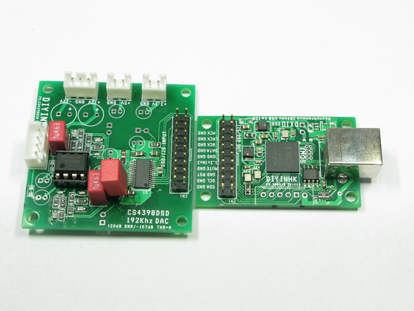

Low cost USB "DSD" DAC with bit-perfect volume control GB
Low cost is not equal to low quality components😀
This USB DSD DAC contains two main PCBs, XMOS USB to I2S with three ultra low phase noise NDK2520SD oscillator PCB, CS4398 DSD DAC PCB and an optional LED sampling rate indicator PCB.
Apart from the DSD playback functionality, it uses low noise thin film resistor, C0G capactor in the LPF, WIMA decouple cap, panasonic low ESR aluminum electrolytic capacitor and optimized layout 2mm distance for all decouple capacitor, etc.
The most distinctive features of this USB DSD DAC is our customize firmware for bit-perfect volume control. Most people may not notice many so called "bit-perfect" device on the market is bit-perfect ONLY When You Play At FULL Volume. If the volume is not set to maximum in the computer, the audio data is scaled/altered before sending to the DAC chip and the result is signal to noise ratio seriously affected.
Related paper on this important feature:
http://www.esstech.com/PDF/digital-vs-analog-volume-control.pdf
Compare on the audio data flow path:
General device on the market: "Partial" Bit-perfect only at full volume
Computer -> USB -> XMOS/CMxxxx/AMxxxxx -> I2S(audio data scaled/altered if not at full volume) -> DAC Chip (es9018/cs4398/pcm1794 etc.)
This USB DSD DAC: Complete Bit-perfect at any volume
Computer -> USB -> XMOS -> I2S(audio data bit perfect at any volume)+IIC volume control -> DAC Chip (es9018/cs4398/pcm1794 etc.)
After many hours of work on customize the xmos firmware on this USB DSD DAC, audiophiles can move the volume control bar up and down freely in the computer volume mixer panel and still enjoy bit perfect audio. DSD audio as well as PCM audio can also be bit perfect volume control easily from the computer. Please notes there are many so called bit-perfect device can play DSD but you must set the computer master volume control to full volume.
This is the initial prototype, the cs4398 DAC PCB will be in yellow color, the final layout will have a little different from the photo

Hi DIYINHK,
Very nice offer and very nice price. But why no nice little regulators very near to the CS4398 onboard? Also nice regulation for the opamp onboard would be nice.
Gr GJ
Gr GJ
😱Hi Diyinhk,
Even without onboard regulation (or even the traces on the board for mic5205 set up ?) i am also in for xmos+cs4398.
Gr GJ
Gr GJ
Is there any chance to use AK4396 or AK4399 for DSD playback .. do you have in the plan combination with XMOS..
I have plan for the new chip AK4495🙂
Could this be the basis of a nice desktop headphone amplifier? Would it work if the USB source was, say, a Samsung Galaxy S4 smartphone?
Ray
Ray
Is it possible to use XMOS USB to I2S board with miniDSP SHARC as USB streamer?
I believe that DAC board is compatible with miniDSP SHARC, is it?
