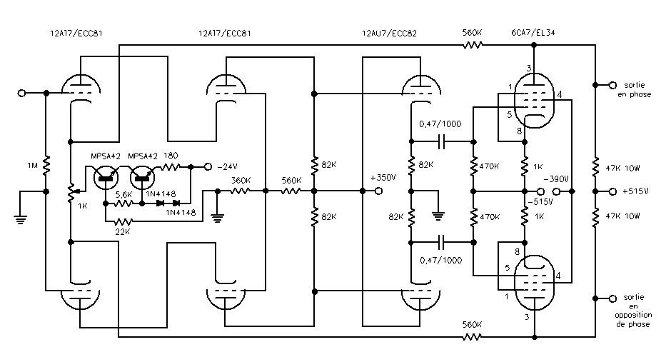

On a french forum I found the attached "ampli-casque-EL34.1.jpg" which looks like a better design than the SRM-X as it is using an extra buffer stage, but uses an EL34 and purely on subjective reasons I was thinking of avoiding pentodes as using valves was out of my comfort zone already.

Front end is ECC83 and the output can be 6CG7's, 6SN7, 6S4A or just what ever you want. Rudistor even built a version with EL34's but there is no way that works well without another stage being added. Only thing to take care with is the heater wiring as the two front end tubes need their own supply and so do the output tubes.

Thank-you for the information spritzer.
Particularly useful to mention " heater wiring as the two front end tubes need their own supply and so do the output tubes." It had never occurred to me this could be an issue, I guess their is potential for feed back issues here?
Sing X3 and X4 will be in anti phase I guess using a double triode such as the ECC99 or the "6SN7GT B" as cathode to header voltage can only be 200V?
I had seen the "HEURIDIX MkII" design in my web browsing, and it looks very cheap to make, but was put off by the lack of feedback in the system. Because of this I assumed that the performance would be poor.
I had a look at the data sheets of the ECC99 and the "6SN7GT B" seem to have similar voltage limits.
ECC99 = 400 V Ua
6SN7GT B = 450 Maximum plate voltage.
Maybe I am reading the data sheet wrongly. This said the "HEURIDIX MkII" does look the cheapest solution to build, even if the cathode to hater voltage requires two different output tubes per channel.

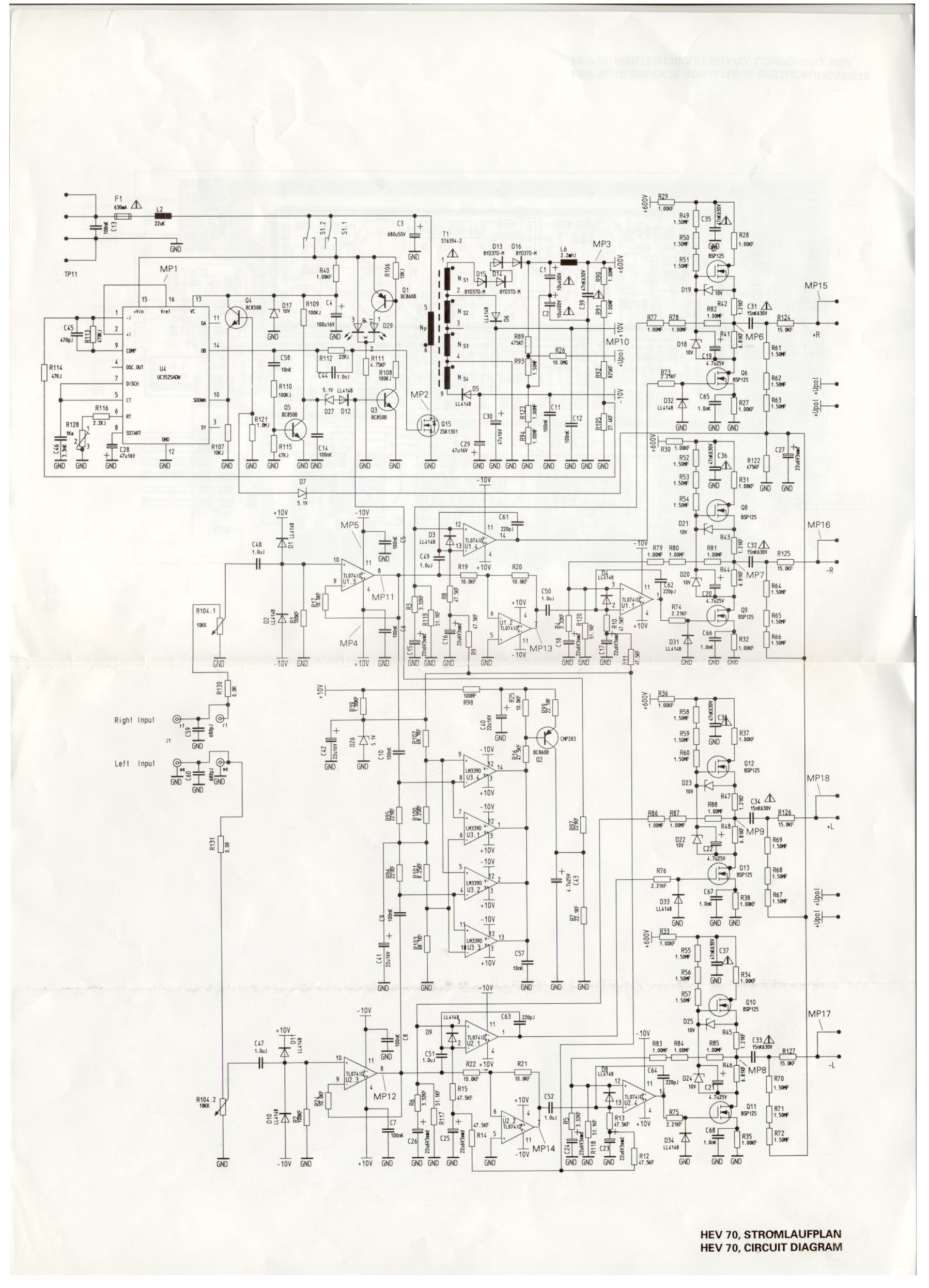

there are quite a number of HV-MOSFETs and bipolars around for Headphone useage as the supply lines typically are much less than 1kV.
Like MOSFETs: 2SK1317, 2SK2225, 2SK2943, 2SK3746-48, IRFBG20
Like Bipolars: 2SC4630, 2SC5353, BUK456, BUX87
Lets not forget the very promising upcoming SIC/SIT technology: FSICBH057A120 (someone at Fairchilds must clearly be nuts to name a device like that), Rohm´s SCT2450KE (verylow cap)
And IXYS released a couple of very-HV transistors for up to 4kV like:
IXBF12N300, IXBH6N170, IXTH02N250, IXTH1N200P3, IXTP06N120P up to the 4.5kV types IXTF02N450HV and IXFT1N450.
Even HV-Depletion MOSFETs like: IXTP08N100D2 and IXTP1R6N100D2 may be on the radar.

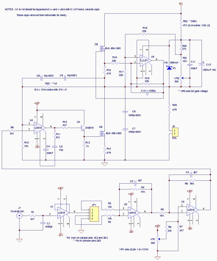

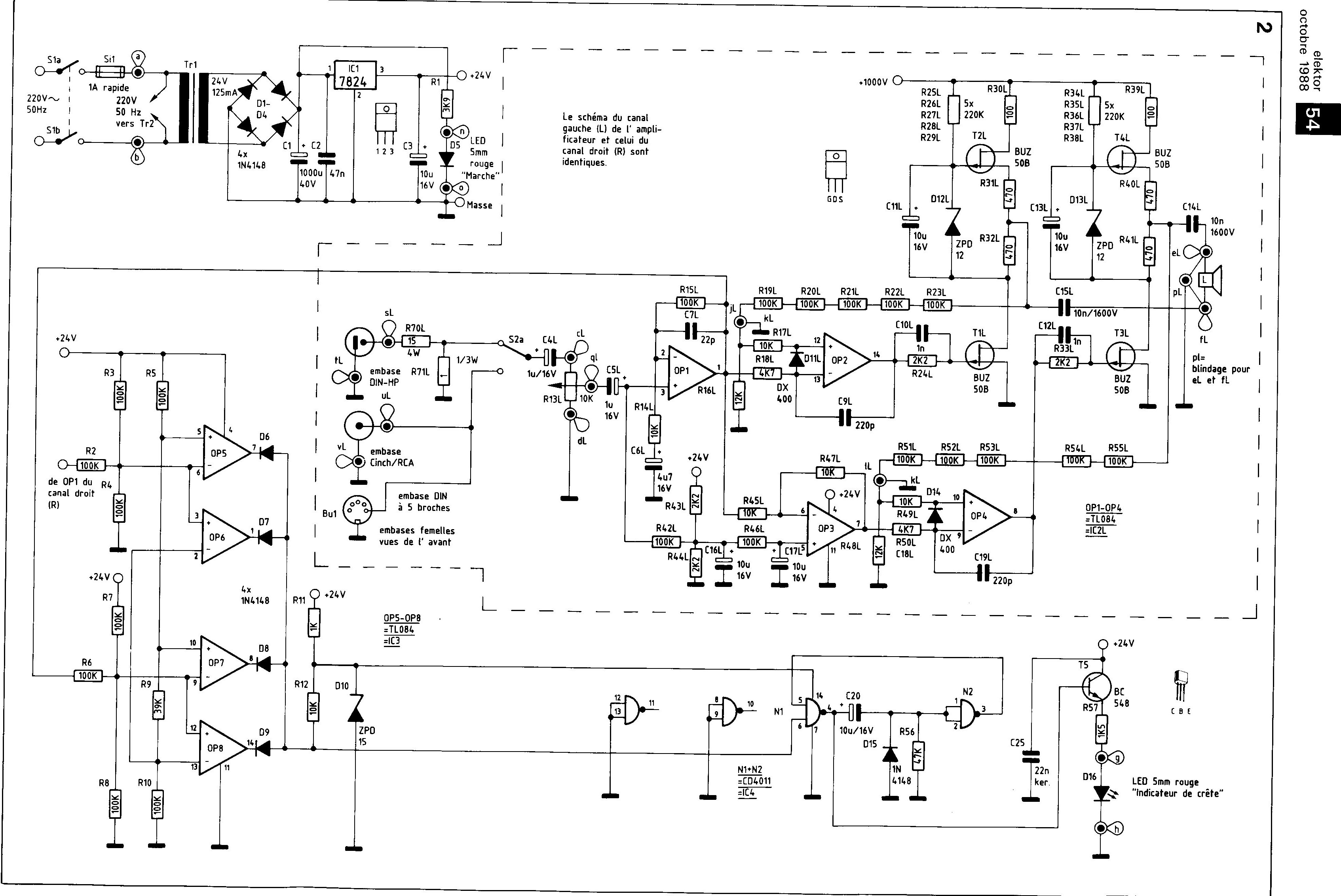

There are several circuits circling the net and this forum.
You may also want to take a look at this site
With the above posted circuits of #1 and #2, I wonder about the high valued anode resistors of 47k and 66k the tube amps.
Say Your HPs capsule capacitance measures 100pF, then each Amp-half will see 200pF.
The Anode resistor limits the charging current through the capsule.
The uppper bandwidth limit is then defined by the formula F-3dB = 1/(2pi*RC).
For F-3dB = 30kHz and C(capsule) = 200pF this results in an R(anode) of ~27kOhms.
Now You very probabely won´t need a full power bandwidth of 30kHz, but 47k, resp. 66k certainly limit the bandwidth to well within the audible range.
A transistor amp utilizing a SEPP topology and feedback (or a ccs-loaded source-/emitter-follower like the above linked one) could offer much lower output impedance, hence a linear ampitude response beyond the audio frequency range.
The issues with transistors are imho rather to control the -and omit with the- generated heat, and of course the general dangers of high voltage applications.

Off the transistors you mentioned I could only find BUX87 from RS so high voltage transistors are a little harder to get than you might imagine.
I must admit to liking the JLH class A 10W amplifier and wonder if some similar design could be scaled up to make a very simple class A 450V amplifier?
Can I use a series of low voltage conventional transistors in series to provide a constant current load some how?
As I said its supply that drives me to tube/valves 🙂
This said the BUX87 has nearly the same ratings as a 6SN7 at less than a 16th of the price.
When looking for suitable transistors how should I proceed?
Something like the BUL216 has much higher voltage rating than the BUX87. Is it too non linear? How do I tell its unsuitable from the data sheets?

Nice looking circuits. Again transistor supply is a big issue for most of them. The ccs-loaded source-/emitter-follower is maybe what I would do if I could find the transistors.There are several circuits circling the net and this forum.
Yes a very strong argument here.With the above posted circuits of #1 and #2, I wonder about the high valued anode resistors of 47k and 66k the tube amps.

The Elektor article shows a nearly identical topology to the Sennheiser HP-amp.
Sennheiser working with BSP125 MOSFETs.

I use a MOSFET differential amplifier using 800 volt n channel mosfets and a 450 volt regulated power supply. I can't post a schematic, but the drain load is 13k per side. There is a minus 15 volt supply to provide about a 35 ma. current sink for the sources. Power dissipation is about 4 watts per fet and resistor. The diff amp is driven by a NE5532 opamp at some low gain to bring the output to a reasonable level for your driving source. The diff amp gives you the push pull phase shift you need.

So I have taken some inspiration form the circuits Calvin included and the good success Jaclement had with such a simple design.
I shall build a few, ideas and see how they all work. I have ordered a nice high voltage transformer and some high voltage capacitors.
I also ordered the "6SN7GT B" for a comparison as I think I will build a MOSFET and a valve based design and see which I like best.
I particularly like the idea of modding the opamp driven MOSFET with no output capacitor, as I have read (but don't know if it's true yet), that at such high voltages the capacitors "sing", maybe with a DC servo to set the voltage right.
Can I just use the "ITH 02N250" in place of the output MOSFET's in all of the designs Calvin posted or would I need to make many changes to bias?
