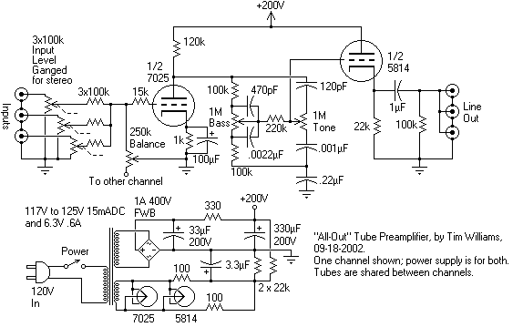

Lesse, AES P-T442, 125V 15mA + 12.6V 300mA, enough for two 12AU7s; $17. I have a spare Chicago Standard transformer which is the same except for 6.3V 600mA heater winding, and made a preamp (12AX7 + 12AU7) with it.
What I think is the current schematic, 😉 is attached.
Tim

I had an idle 30 minutes at lunch to day and thought I would have a go at a 100 euro preamp with an OPT...
A few compromises are needed but I came up with this parts breakdown...

The OPT is a compromise - but swop it for a Hammond 1609 and add 50 euros to the cost and it should be good. Of course it doesn't include switches input/output sockets or chassis...they are all in the parts box already 🙂

...Whoops!
John.
Thanks - good spot!!!
It does indeed on my sketches but I missed it on the .gif file. I did it all in a hurry today... there are probably other errors as I really rushed it but I thought the idea was interesting enough to post...
The second triode is for bias current - I first wanted to go push-pull so no decoupling at the cathodes but then I remembered that the psu sounds awful - it's cheap but awful so the fix for that was to use full decoupling at the cathode to remove the psu from the signal path.... and since the SE OPT are so expensive I decided to leave the second triode in as dc bias for the PP OPT...
It ain't pretty but it's cheap!!! Should sound nice too...
