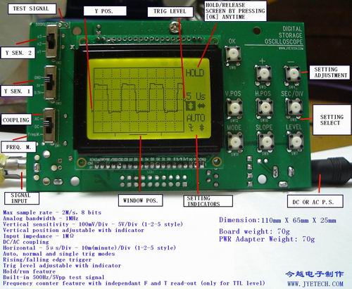

Features:
Max sample rate - 2M/s£¬8 bits
Sample memory depth - 256 bytes
Analog bandwidth - 1MHz
Vertical sensitivity - 100mV/Div - 5V/Div
Vertical position adjustable with indicator
Input impedance - 1M¦¸
Max input voltage - 50Vpp
DC/AC coupling
Horizontal - 5¦Ìs/Div - 10m(minute)/Div
Auto, normal and single trig modes
Rising/falling edge trigger
Trig level adjustable with indicator
Hold/run feature
Built-in 500Hz/5Vpp test signal
Frequency counter features with independant F and T read-outs (only for TTL level input signal)
9 DC power supply
Dimension: 110mm X 65mm X 25mm (without case)
Please visit www.jyetech.com for details.

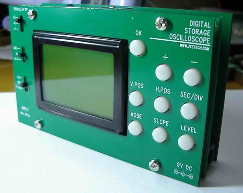

I bought mine from NKCelectronics in the US. You save on shipping. I bought the finished scope. Seems a lot of work to solder those SMD components. Already used it to troubleshoot the I2S output of a CDROM
Rob, the LCD module is the same as the one used in the o-scope. It may take 3 - 4 days to arrive USA if sent from our city. Courier is DHL. Shipping cost is US$23 for 0.5kg. You may like to buy from NKC to save money and time.
I just got my hands on one of those and I have to say, it is quite fun to play with. It isn't blasingly fast, the frames per second aren't spectacular, but it does everything it says and does it fairly ok.
Learn how to use it, using the test signal that is built in and going trough the manual, it's fairly simple to grasp.
The frequency counting mode also works great, it counts the 500hz test signal correctly and even manages to properly count the 50hz hum induced trough the power I'm giving it(lousy 9V wall-wart). And that's a very, very low-level hum, a lot under 0.1v, which is the minimum V/div in the meter. I'll try it on a 9V battery at some point to see what it detects there.
For fun, grab the probes and look at your own waveform.
Cool device, now to find something useful to use it for!
