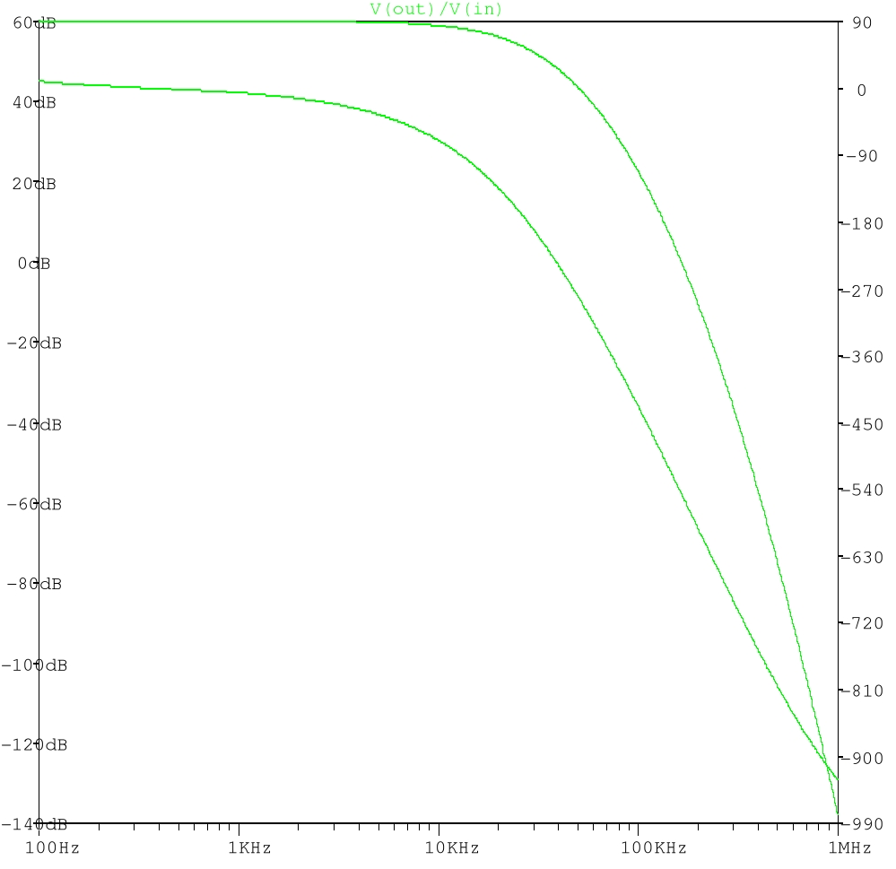

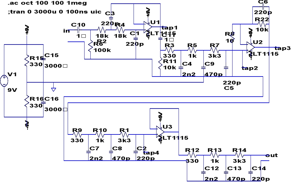

This jitter measurement does focus on jitter on clocks and PWM signals of 200kHz-1MHz as widely used in class D amps.
The measurement does display the noise that is generated in the audio band by the jitter of a clock or PWM or level shifter or gate driver... .
Basically the circuit is a high order filter with 60db gain over the audio band.
A 400kHz carrier is suppressed by 118db.
The equivalent input noise is approx 5uVrms, which means a measurement limitation of -117db, when considering a +/-5V PWM signal.
When checking a 400kHz PWM in time domain this would demand measurement equipment with an accuracy better than +/- 2ps.
In real life I am using two NE5534 (compensated with 39pF) for the voltage followers. The gain stage is working fine with LT1037.
At each OP amp there is a 100nF ceramic between pos and neg supply - not shown in the schematic.
The GND wiring should follow the geometric sequence as visible in the schematic. Suppressing 400kHz with 118db demands a certain discipline 😉
The -3db bandwidth is slightly above 17kHz, fitting well to simulation.

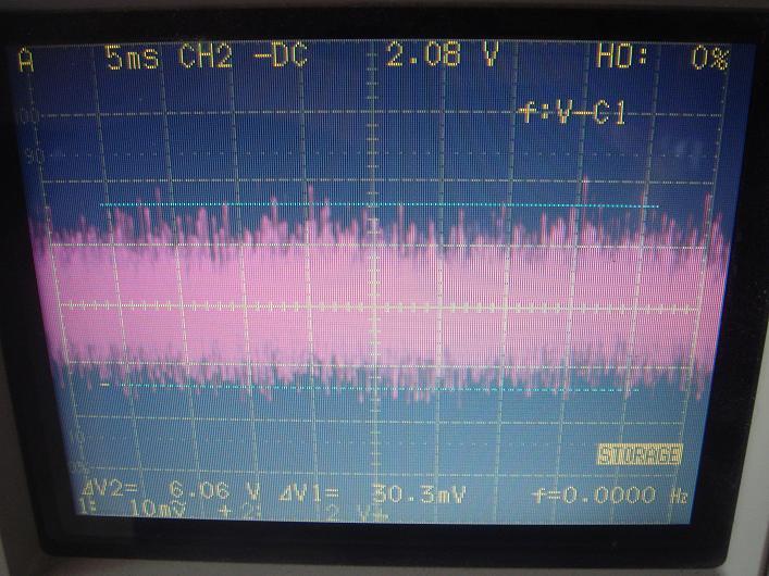

When the input is shorted we can find an output noise of approx 30mVpp.
Means 5mVrms, means an equivalent input noise of 5uVrms.

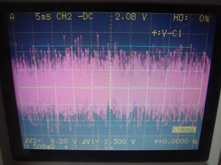

The second measurement is the noise of a standard signal generator delivering a 4.8Vpp rectangular with 400kHz. It has noise of approx 383uVrms in the audio band. Not fortunate as a source to generate a triangle! Assume we go for a +/-200mV triangle by a simple RC..., then the related RC will let pass the noise in the audio band in full. Means we have 383uVrms noise on the triangle. The triangle is being compared with an audio signal of +/-200mVpp... assume sinusodial.. means 141mVrms. 383uV noise on 141mV signal means -51db.
Even when considering that this poor value might be cured by the feedback loop, say the amp output might be 20db-30db better.. ..obviously it is making sense to spend some love on a low noise triangle for a clocked class D amp....

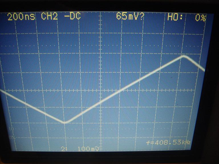

Hi ChocoHolic,
You can show triangle wave on oscilloscope with right zoom possible?
regards
Which zoom would be right from your view for a 400kHz triangle with +/-200mV?
Just let me know your desired time scale and voltage scale.
...something like this?
Thanks Choco, it is good to see the corner, I see that it is clean.
geometry also looks good, it is preferable to see at 400nS/Div.
have no doubt, which is much better oscillator with hysteresis for noise. a problem can be the amplitude of the triangular, is too low 200mV.
