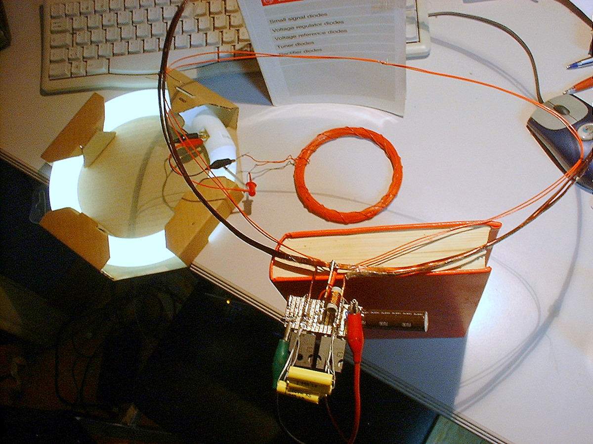

I am designing a high-voltage amplifier to directly drive ESLs. I'm not ready to disclose the design yet, but I DO need a power transformer with a large isolation between primary and secondary, at least 3kV peak, as well as very low capacitance between the primary and secondary.
I've got a quote by one manufacturer which specs 250pF between prim and sec which is too much. I want to get (far) below 100pF.
I need about 20W power, 115/230V prim. Sec voltage should be 6V nominal.
I *think* I might need to wind my own, like on a C-core with physically separated primary and secondary. Anyone knows where I could buy kits of cores and bobbins or any other solution?

I suppose your circuit swings the power supply secondary with audio voltage and therefore needs low capacitcance to primary? The best way to drop capacitance is to increase the transformer frequency, which makes all parts of the transformer smaller.

Yes. I did that for the screen supply of the upper tube (those CCFL transformers are great & cheap!). But I also need a solution for the heater (6V @ 2.7A). I'm hesitating to go the DC-DC converter route as I'm not familiar in that field and I want to build an audio amp not embarking on a new field of study. 😉

I would say you would choose either a split bobbin or electrostatic shield. You can reach less than 10pF with a properly arranged shield between windings.

Using sine converters, you can easily go down to single digit pF figures without really trying hard: complexity can truly be minimal, as you can see below:

Sine converters as such doesn't seem a problem; just a bunch of chip amps to drive xformers. BUT, 5600V isolation? How would you do that? At 20W?

Secondly it is not that difficult.
In order to reduce capacitance you need to phisically separate primary from secondary thus leading to relatively high leakage inductance. Resonant topologiescould utilize Ls.
What is the power level you are looking for?
As for implementation you may look at Concept IGBT drivers. There is nothing in particular. Frequency is around 250 kHz, 30mm toroidal core.
As I can recall 2 or 3 turns primary and 4-6 secondary. Really heavy insulated wire - teflon will would be the best. Simple hard switching forward converter.
Another hint: make cable transformer. Take piece of rather thick RG coax cable. You will also need some good ferrite ring cores with internal diameter a bit larger than coax outer one.
Put let's say 10 cores as beads and bend coax into U-shape with 5 cores per leg. Coax outer conductor will be single turn primary, inner one - secondary.
Capacitance is known - specified by coax type. 10 mm coax is good up to 10 kV.

Assuming you remain at linear power supply frequencies and even if you utilize an SMP topology, you must use twin well bobbins. Primary in one and secondary in the other.
As pointed to, this will cause a large amount of leakage inductance and cause efficiency difficulties with either SMP or linear power.
The first thing to do is to heat melt a bare, tinned, stranded copped wire up the secondary bobbin wall. You just need to heat it with a soldering iron in a couple of places and lightly tack it into the wall. Leave 25mm or so free out across the bobbin "floor" and leave about 8mm free up the bobbin wall before your first tack point with the wire and bobbin. Leave the other wire end free at the top and extending out beyond the bobbin flange 25mm or so. Then paint the secondary well with a high solids copper paint.
Before winding the secondary, apply a copper sheet to the start surface of the winding form, connect that stranded lead to the copper surface and cover with a full width layer of Kapton tape between two layers of Nomex 418 (mica infused) with all three thick enough to withstand the full voltage potential. Then wind a "tape wall" up both bobbin walls of at least 8 mm width per side, using either a transformer winding tape or an electrical grade crepe paper tape. Wind your secondary wire but sleeve the wire that comes from the winding start out to the lead connection on the finished coil surface with two layers of double strength teflon sleeving and embed the wire in the tape wall by making a suitable slice into the tape and then over taping the sleeved wire to keep it in place while you wind. When you have finished winding, again sleeve the exit wire and bring it and the start wire out the coil side. Then wrap the final layer of wire just as you did the beginnings of the winding, in insulation sheets and a copper sheet . Solder the tinned stranded bare wire lead to the upper copper sheet. Both copper sheets must have the ends of the copper turn insulated. Start and finish cannot touch each other. As you wind each layer of coil wire must have a layer of nomex 418 across the entire winding width, with a 6mm overlap at the join of both ends.
Secondary leads must be silicon coated with an outer jacket of woven material. All connections must be within an envelope of nomex 418 kapton nomex418, with minimum spacing to all other materials and each other of 8mm with 12mm being even better.
Vacuum impregnation with Dolph CC 1105 filled polyester resin is an absolute necessity to quench corona. Make all dielectric discontinuities as small as possible, as this is where corona will be at it's worst.
A 5000 vac continuous duty power transformer can be built in this fashion, but are you sure you are up to this task Jan? This will be a big transformer for a linear supply.

Surely manufacturing 5kV AC insulation is not as simple as it seems.
See the post above.
Nevertheless the cable implementation works just fine @ power level around 1kW and voltage across isolaton barrier 50kV.
ESD or other type conductive paint equalising potential distribution is a must as well as corona awareness.
Spacing, dust free environment (enclosure), proper dielectric (FR4 is definetely not the best one), rounded conductors...
Sometimes oil bath seems so much easier... but "dry" solution do exists.
On the bright side you can always half the voltage applied, centering the "ground"/common/earth.
Again look at 6kV IGBT drivers and check assosiated application notes for clues and tricks. SMPS is the way to go.
