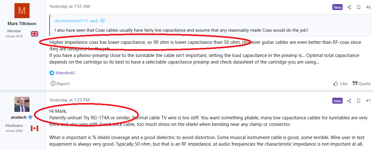

Higher impedance coax has lower capacitance, so 90 ohm is lower capacitance than 50 ohm. However guitar cables are even better than RF-coax since they are designed for the job.I also have seen that Coax cables usually have fairly low capacitance and assume that any reasonably made Coax would do the job?
If you have a phono-preamp close to the turntable the cable isn't important, setting the load capacitance in the preamp is... Optimal total capacitance depends on the cartridge so its best to have a selectable capacitance preamp and check datasheet of the cartridge you are using...
Hi Mark,
Patently untrue! Try RG-174A or similar. Normal cable TV wire is too stiff. You want something pliable, many low capacitance cables for turntables are very thick and also very stiff. Avoid thick cable, too much stress on the shield when bending near any clamp or connector.
What is important is % shield coverage and a good dielectric to avoid distortion. Some musical instrument cable is good, some terrible. Wire user in test equipment is always very good. Typically 50 ohm, but that is an RF impedance, at audio frequencies the characteristic impedance is not important at all.
