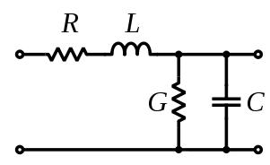

Hey everybody, here is the schematic equivalent of coaxial cable.
I'm trying to see if there really is a difference between interconnects with high capacitance and low capacitance.
Two capacitors in series will have total capacitance equal to less than the value of the smaller capacitor.
What would happen if a VERY low value capacitor was placed in series with the capacitance caused by the interconnect cable?
I'd be talking about something less than 1 pf very high quality capacitor.

At audio frequencies the capacitance is almost immaterial. 50R RG58 is as good IMO as most Snake Oil cables. It is the connectors at the end that make an appreciable difference.
The nominal impedance of a coax cable is the sqrt of his inductance per meter, divided the capacitance per meter. If you choose a high Zo coax, it naturally will have lower capacitance than lower impedance ones.

Actually there is one case where this is absolutely not true and that is between a MM phono cartridge or the secondary of an MC step up transformer and the input of a phono pre-amplifier. I've still not found what I consider the ideal cable for this application.
Cable capacitance is quite real, not "virtual". You can calculate it from theory, and measure it with a meter. How much difference it makes in a particular case depends mainly on the source impedance, which is why it can be a problem with pickup cartridges. Fortunately, some cartridges are designed to cope with capacitance.
If you put a small cap in series with the cable then you will get low capacitance and low signal too. Generally not what you want. The small cap and cable form a potential divider.

WRT to phono stages tube based designs usually have appreciable input capacitance due to miller capacitance if high mu triodes are used, and much less if a pentode or cascode connection are used. There may or may not be much input capacitance margin left by the time that is taken into account.
