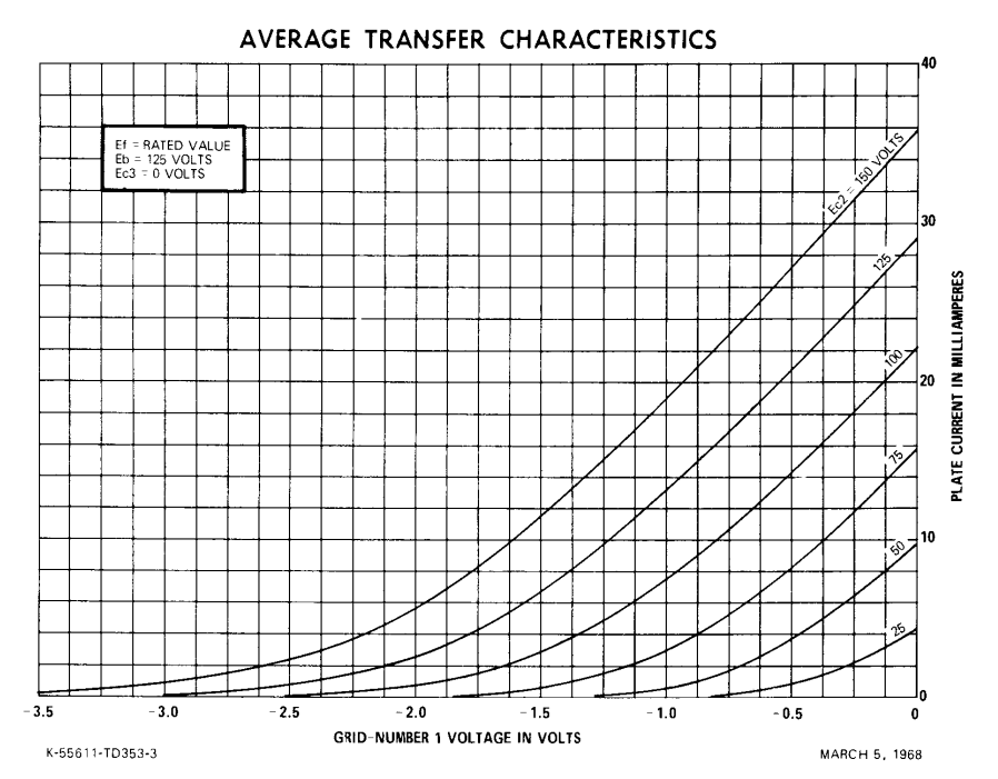

Gm is largely a function of the current through the tube. The curves show Gm VS G1 voltage at several possible G2 voltages, Since both of these influence tube current, the curves represent their effects on Gm by of current control.
These tubes were intended for use as 45 MHz IF amplifiers in TV sets. Gain is controlled by modulating the current through the tube. Whether called remote, semi remote, "approaching semiremote" (RCA's words for the 6JD6), or sharp cutoff, the current through the tube will affect the Gm and at low currents, the linearity degrades due to the bunching of the curves. You will note the same characteristics in the 6AU6 and 6SJ7 curves, but we use them in audio amps. These tubes just have more room at the higher current end of the chart because of their fat cathodes and frame grids.
In audio use the distortion created is primarily second harmonic and will largely cancel in LTP or other balanced applications. A pair of these tubes in LTP can make a bunch of drive voltage at very low distortion if you bend the plate voltage spec a bit, OK, a lot. I run them at about 5 mA per tube, less when the plate voltage is over 400 volts.

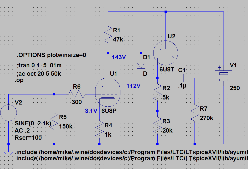

I wonder how a pair of 'em would do in a SRPP configuration. Seems perfect for B+ around 300 V in that service. Each tube only sees about ½B+. Inside VA MAX.
GoatGuy
What I was contemplating is a topology akin to this but at a B+ of closer to 150V. Ref. Broskie
To get the gm down in the region of a 6N1P one needs to be around -0.75V g1 which is on the low end of reasonable for line inputs. This gives only 2mA Ia.
But the 6JC6A Vg1 v.s. Ia curves indicate that the linear region with 50V on g2 is about 0.3V g1 and 5.5mA Ia. Of course the circuit uses screen feedback so the over all result might not be horrible using the 0.75V bias point.
This is the trade-off I was referencing.
