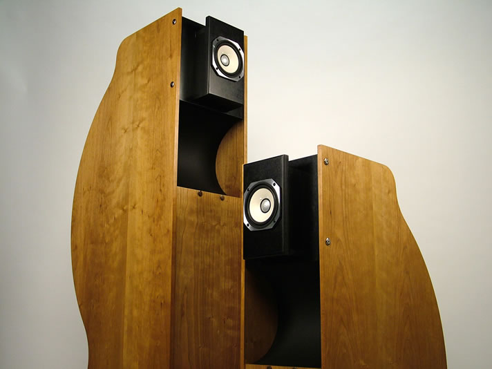

Does somebody know this horn hybrid?
http://www.lovingtonhorn.co.uk/pages/specsheet.html
As I understand it is similar to the old Fostex recommended enclosure for FE127E BLH-BR, it isn't it?
I cann't see well on the pictures where is the BR port and the horn mouth.....
Has it a port fired into the horn section like the Fostex or what?

This single horn loudspeaker is a hybrid design, one of great simplicity, combining a full range 4" driver, housed in a reflex enclosure, rear porting into a truncated bass horn. By using this approach, alongside the particular construction of the bass horn enclosure, the loudspeaker produces seamless integration from detailed, open treble, superb mid range and for a horn, astonishing deep natural bass. We believe that these combined qualities are truly unusual in a domestic horn loudspeaker of this size.

AFAIK these are trad. hybrid QW horns, no reflex section. HFW magazine reviewed them a few months back IIRC.
I thought it has a BR port (vent) what opened into the horn section, like Fostex.
If, not than should I understand it is similar to a BVR? I mean the BR chamber tuned with the horn section?

I could be wrong then & it's similar to the Factory 126 box.
I imagine they're implying that the short distance from the vent to the terminus will reduce the time-delay. Given that it's LF frequencies, and the delay isn't in reality very much, I can't honestly see it having much of an effect in that respect.
Hmm, sounds like a mass loaded BLH to me, i.e. BR vent at the horn's mouth to increase its LF gain BW and smooth its response somewhat........... I mean its terminus is way too small to be much of a horn, but plenty large to be a low Q vent.

The baffle has some obvious diffraction issues. But at least it looks like it has enough area? Dont know about the high mounted mouth.

I saw on the SH.1 picture an opening near to the floor and maybe there is something right under the driver?? Looks like a half circle...

Yes, I took the apparent slot near the floor to be a horn vent based on the written description of operation and the funky looking driver box area as an interesting form of baffle loading to counteract the small horn's 3rd harmonic dip and the narrow cab baffle diffraction issue.
