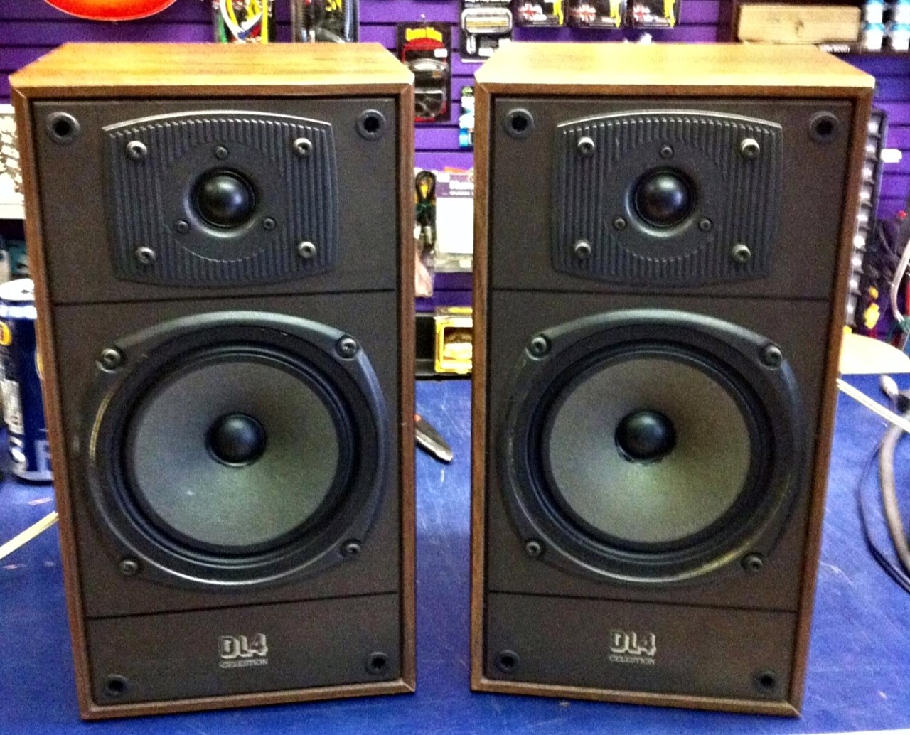

I remember I had in the 80ies a small reflex two way Celestion DL4 (70hz-20khz) and let it listen to a friend in his home.
It was a small square room which must have had a prominent resonance at 50hz / 60hz.
It ideally made the small speaker sound like a big box with a much lower and louder bass than in my home.
Really no need for a subwoofer and some rare good matching between box and room.

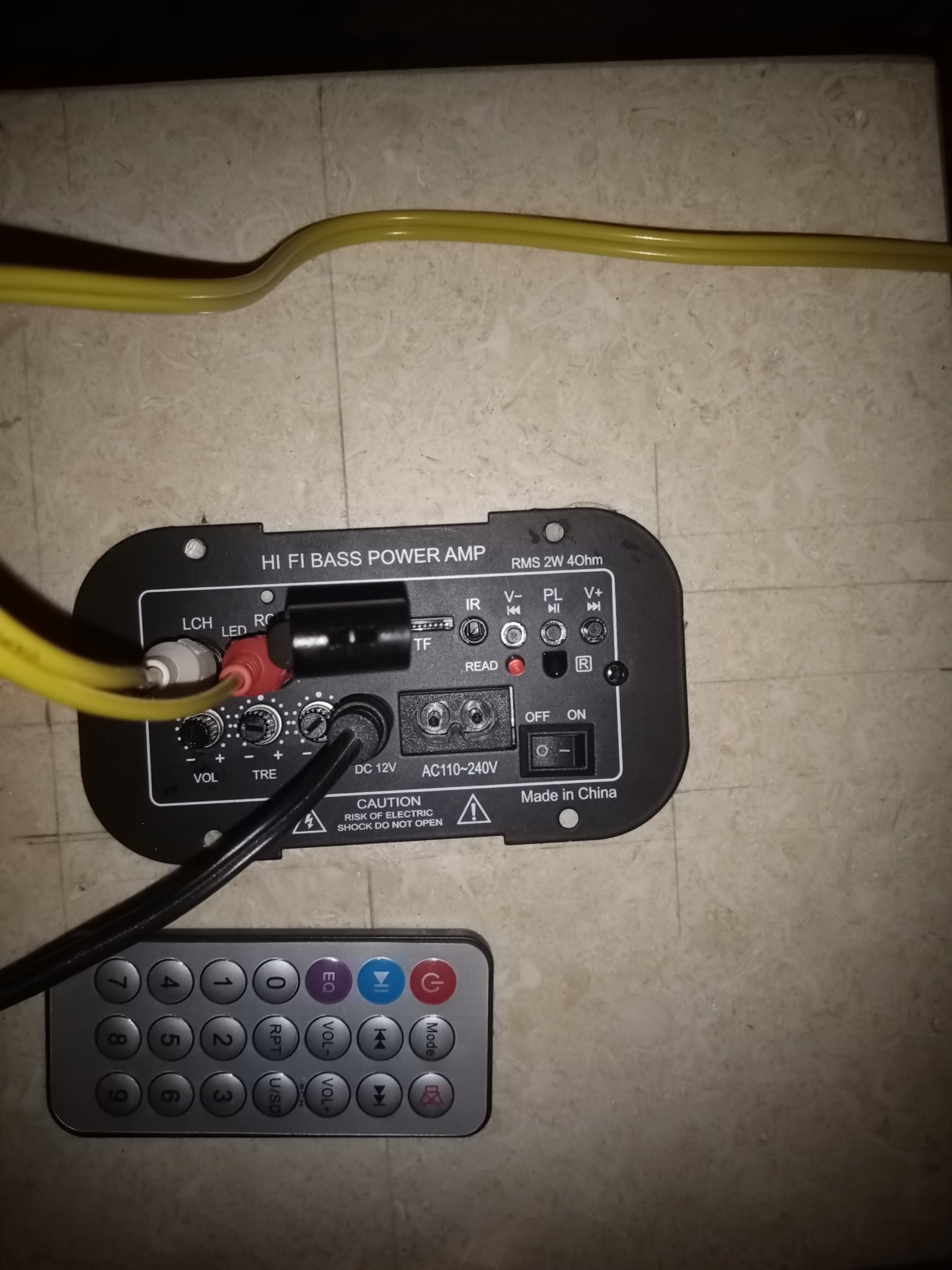

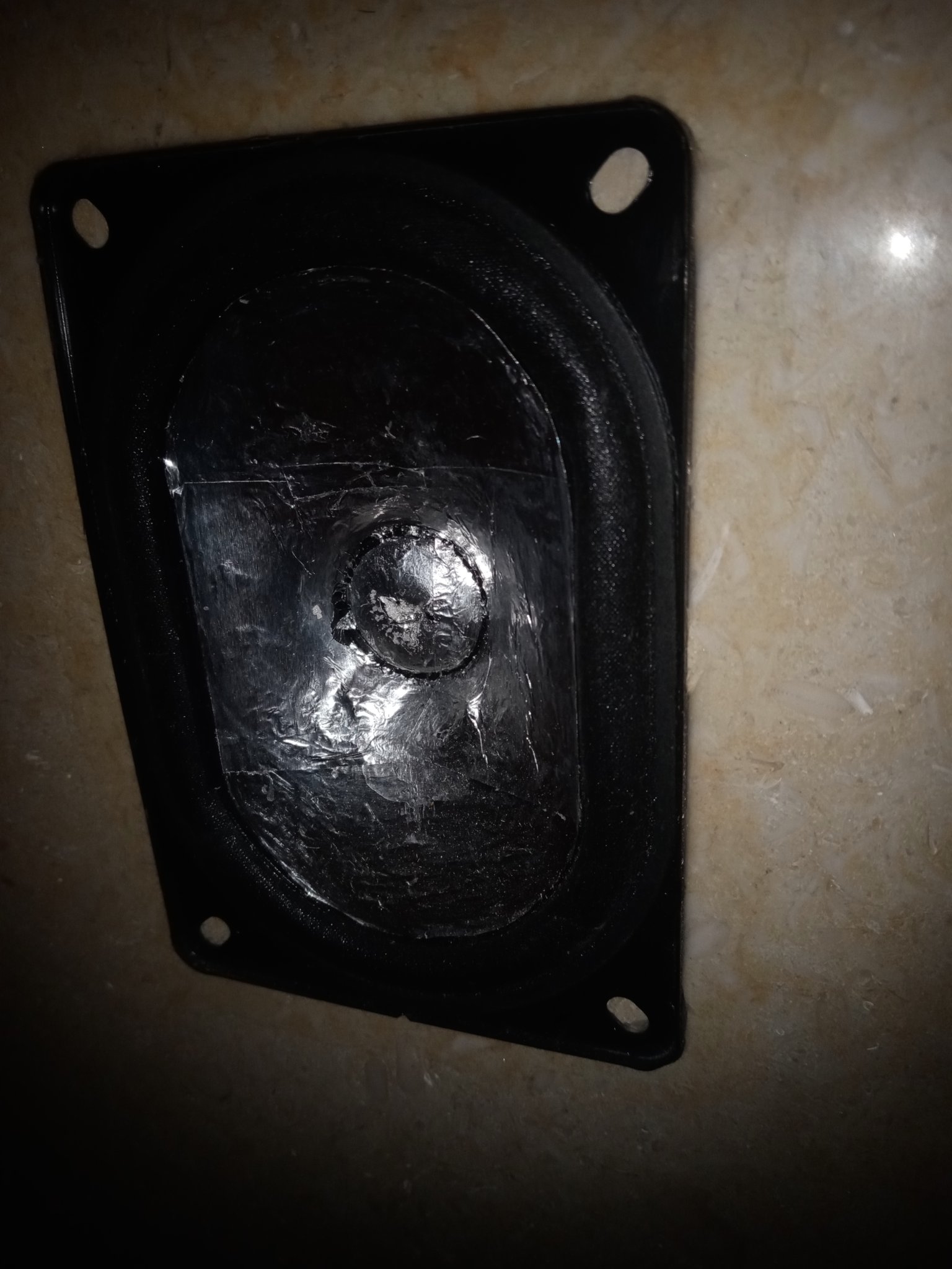

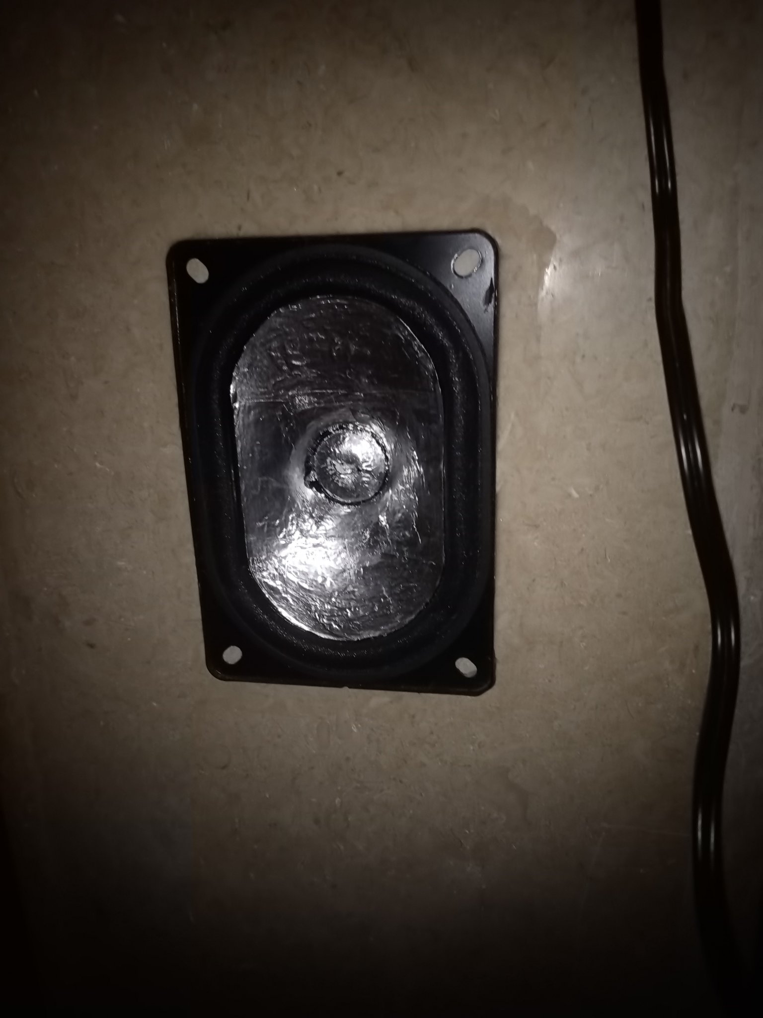

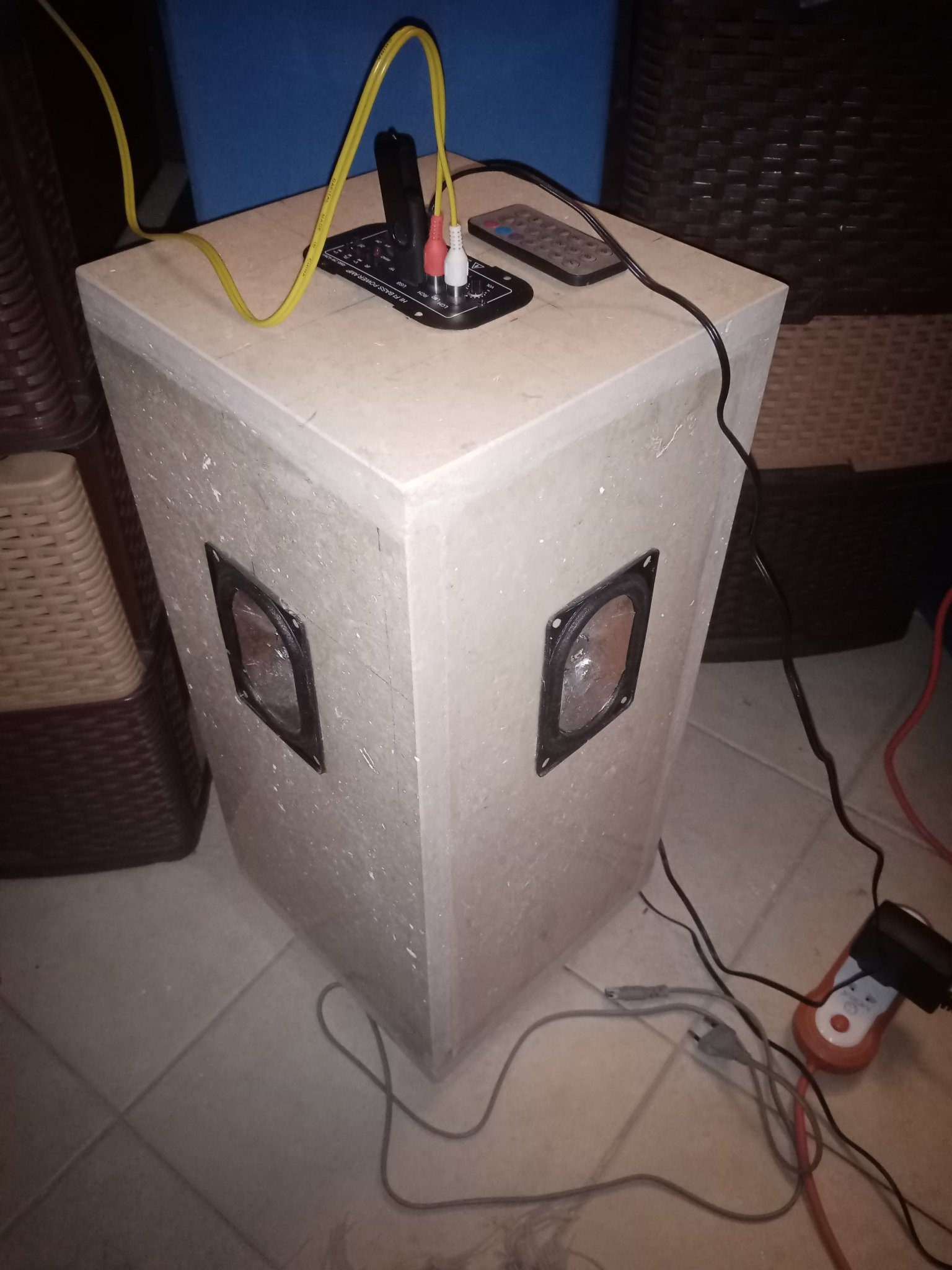

Today listening test with fullrange drivers which have a Faraday ring and paper cones sandwiched with aluminum foil in a marble box, reflex loaded to 35hz.
Two 8 ohm drivers in parallel (=3 to 4 ohms) with in line 2.5 ohm resistor and 1.5 microfarad in parallel.
Small BTL TDA2003 Mono amplifier.
Clearly this resistance lowers distortion audibly.
Without resistance it sounds "harder" and more distorted.
