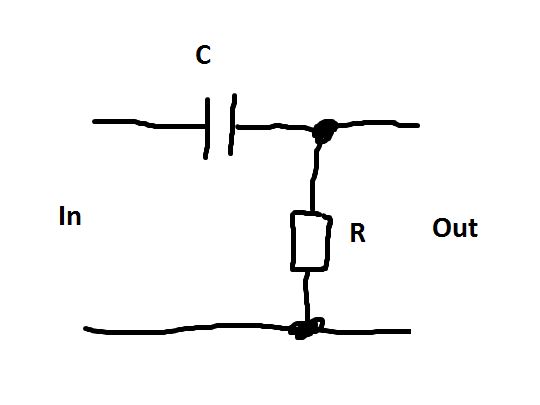

Lets look at stopping DC from a source component. This shows a series cap and a resistor to ground. Typical values would be a small 0.47uf film type cap and a 470k resistor. This ensures that whatever DC is present on the source does not get past the cap. The output is always 0.0000 volts DC.
I would try something like this first just for the DAC feed and see how you get on. Also, for interest you could try and measure any DC voltage present. It may only be a millivolt or two but you might see something and be able to compare channels.

C = 470 nF, R = 470 kΩ is fine as long as the input impedance of the amp is high. In Alistair's case, it's 50 kΩ (volume pot). In his case 4.7 uF or 10 uF would be needed to ensure a low enough cutoff frequency for the AC coupling.
10 uF polypropylene would be my choice. The Nichicon Muse KZ or Muse ES series would be good choices as well.

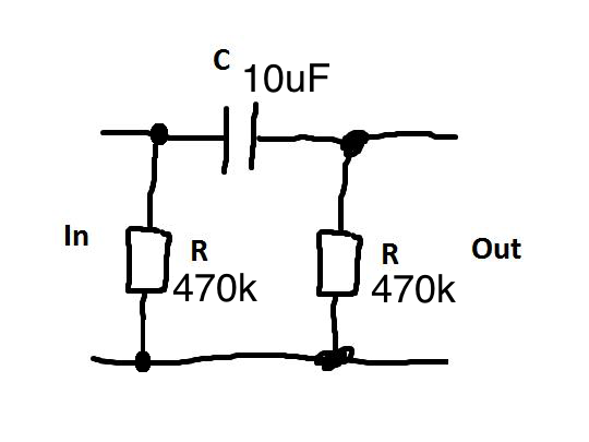

You shouldn't leave one end of the cap floating. I hacked Mooly's figure to show how I suggest implementing the circuit. Just add this to the inputs of your amp and you'll have AC coupling.
Now, if your sources have different DC offsets, you will still get a pop when you switch sources. To prevent that, you need to add the shown circuit to each of the inputs of your amp. So for a two-input stereo amp, you'll need four of these circuits. Then do the input switching between the AC coupling circuit and the volume pot.
