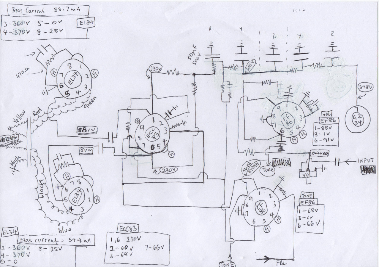

Schematic
After about a gallon of tipex I've managed to draw the main part of the circuit - attached.
Also measured voltages and bias current - see diag.
NB. When I input a 1v signal - only 0.1v comes out of the Volume EF86 on pin 6 and then even less came from the tone controls into pin 9 on the other EF86 - I bypassed the tones by connecting the first EF86 pin 6 straight to pin 9 on the other. This produced a louder result, but still only just louder than the unplugged guitar. But at least it's in the right direction (maybe).
Would appreciate anyone having a look at the schematic and any suggestions made.
thanks,
John

Why,
Are there no resistors on pin5 of the el34? Ie pin 5 to ground!
Pin 5 on an EL34 is G1..input?
Just a first quick look..😀
Pin 9 is reliant on the wiper contact to ground the grid on the first EF86..perhaps 1 meg to Gnd pin 9.
Heaters on ECC83...in series? what voltage is the heater supply.. look here
https://www.google.co.uk/search?q=e...8DSQVS-GM:&usg=__hC-rMSj6MHt3WiW5U_nvnEdRs_c=
Is the supply across 4 and 5 or 4-5 and 9?
Pin 8 and 3 of ecc83 are cathode how is the cathode grounded?>>connected to pin 1 of the EF86 (grid)? or do you actually have the resistor on pin 3 to ground?
Just a few starters I can see others but..lets get some ideas on this..😀
Regards
M. Gregg
It’s an unusual circuit. Do you know where the original design came from?
The ECC83 seems to be a DC-coupled long tail pair phase inverter. The voltage on its two grids (pins 2 and 7) should be the same. However it’s generally impossible to measure grid voltages accurately – so that might be why you have 60V for pin 2 and 66V for pin 7.
The screen grid voltage (pin 1) of the ‘tone’ EF86 is directly supplied from the cathode voltage of the long tail pair (68V). Seems very unusual to me. I suppose the tail voltage is quite constant and so this could be a reasonable idea??? Or is there an error in the drawing?
On the ‘volume’ EF86, you are measuring a B+ of 305V and an anode voltage (pin 6) of 91V. You don’t give the value of the anode load resistor, but let’s guess it might be 120k. Which would mean an anode current of (305-91)/120 = 1.8mA for an EF86 with a screen voltage (pin 1) of 68V, an anode voltage of 91V and a cathode voltage (pin 3) of 1V. Assuming the grid is at 0V, these figures don’t seem unreasonable. So I am not sure why that EF86 seems not to be amplifying.
Simultaneous posting with M Gregg. Agree about the need for resistors to ground on pins 5 of the EL34s. Weird things would happen without those.

You're right there is a resistor on the EL34 from pin 5 to pin 6 to ground, my mistake.
On the Ecc83 pins 4 and 5 connected, so the heater is across 4-5 and 9. Heater voltage 5.7 v. Heaters in parallel.
Also, pin 3 is grounded through a resistor.
And you are correct Malcolm, as to the original, a Linear Concord 30.
I'll redraw the circuit more carefully, with corrections, and I'll put the resistor values on this time too. Where's the tipex gone?
thanks for your time on this M. and Malcolm too.
Grid Stoppers?
The Linear Conchord 30 schematic shows 2.2k grid stoppers on both EF86s and both EL34s.
Do you have those in your build? They are important for preventing ultrasonic oscillation, which just might be causing the problem. Grid stopper resistors should be soldered as close to the grid pin as possible.
There are also screen stoppers of 1k (1 watt) between the screens of the EL34s and the transformer UL taps. These are also quite important.
