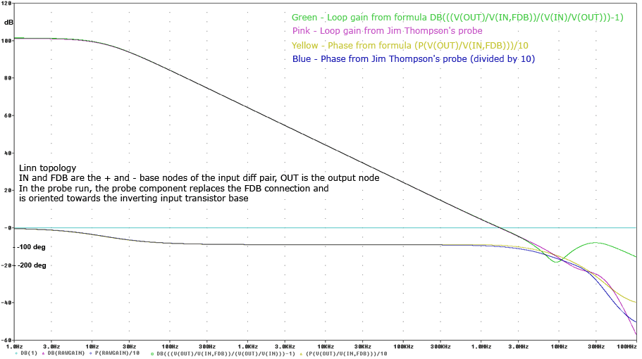

I'm trying to measure the loop gain on a typical Linn topology, for qualitative analysis of changes on the circuit.
Assuming we mark with IN and FDB the two base nodes of the input diff and with OUT the amp output node, I use these to plot the OLP, CLG and LG during an AC sweep:
OLP = DB(V(OUT)/V(IN,FDB))
CLG = DB(V(OUT)/V(IN))
LG = DB(((V(OUT)/V(IN,FDB))/(V(OUT)/V(IN)))-1)
Is this the right way to measure loop gain with spice?

I'm not a PSPICE guy, but Jim Thompson has a writeup on loop gain simulation in PSPICE here. I believe that subcircuit uses Middlebrook's method for computing loop gain. I'm not sure if there are subcircuits available for PSPICE using this technique, but the loop gain example in LTspice uses the equations from this article by Tian et al. They give the same results, but using Tian's method, one can orient the loop gain probe in either direction and get the same answer. The Middlebrook approach requires a specific orientation of the probe. Middlebrook's original article from 1975 can be found here. The Tian article is some pretty hairy stuff. The Middlebrook article is much easier to understand.

Hi Enzo,
If you use your formula, you may get results that are pretty close to those obtained using a loop gain probe, but the discrepancy will depend on the specific circuit being tested. Your formula is based on the block diagram description of a feedback system, while the loop gain probe results are based on the "return ratio" concept, which goes back to the original work of Bode.
There is a very good paper by Hurst that clarifies this. One of the problems with the block diagram approach is correctly identifying A and B when there are impedance interactions in the actual circuit components represented by the blocks. So, instead of having to wonder whether A and B have correctly been modified to take into account impedance interactions, it's easier for me to just throw in a loop gain probe and run the loop gain simulation.
If you're having trouble figuring out how to use Jim Thompson's loop gain probe, he posts in the usenet newsgroup sci.electronics.cad, so you might try asking him a question there. He used to be an avid PSPICE fan, but I believe he has switched over to LTspice.
Hi Andy,
Well, you gave me the answer I was looking for...
On my original post, I was doubting my approach for reasons similar to the ones you mention (more on a gut feeling level, as I have still a lot to learn about more formal approaches). While trying different compensation methods, I wasn't able to clearly separate the forward path from the feedback: the dominant pole cap second connection had moved from the VAS collector to the output node (it's a low power very fast amp) and there was a classical 5p in parallel the fdb resistor. Initially, to plot LG and phase, I was using two versions of the amp on the same schematic, one of them open loop (with a large LC on the fdb return) but I had the gut feeling that actually there was no "open loop" version to speak of... the forward and return path were working as a whole, so to speak - so I tried to get more reliable results without breaking the loop, but I wasn't sure it was any better.
So, here is attached my last effort. I compared the two - the 'classical' feedback theory, without actually breaking the loop, and the Jim Thompson's probe. They seem to agree up to 1MHz in this case.
Thanks a lot!
Enzo

When you take the feedback for the Miller integrator from the amp's output, it can cause instability of the Miller loop itself, especially with reactive loads at the amp output. It's a good idea to check the stability of the Miller loop by disabling global feedback (say, with a huge inductor in series with the feedback resistor from output to inverting input), and placing the loop gain probe inside the Miller loop.
You'll probably find that the unity loop gain frequency of the Miller loop is pretty large - say tens of MHz. The phase shift of the output stage can be pretty uncontrolled in that frequency range, so care is advised 🙂.
The TMC approach (first brought up here by Edmond Stuart) can fix this problem nicely.
