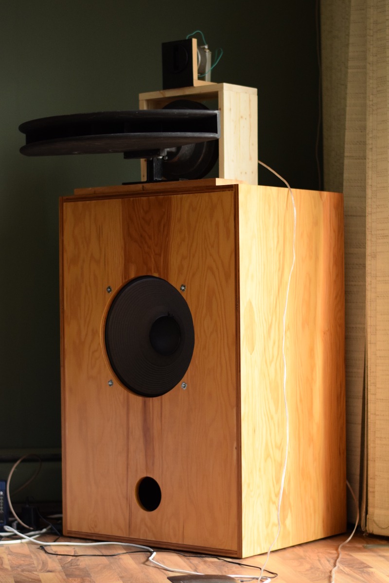

I currently have a three-way horn system that I put together 4-5 years ago and had been "good enough" for most of that time. It started life as a single JBL C34 with an 001 load. I found another C34 in decent shape, pieced together more components, and had a system that looked something like this:
- JBL C34 cabinets loaded with 1x 130A driver each
- JBL 2410 mounted externally w/ Fostex 420 teak horns
- JBL 075 bullet tweeters also mounted externally
- DIY crossover build that is essentially just a JBL N1200 and a N8000 incorporated together using Jantzen CrossCaps, air core inductors, and L-pads that were affordable to me at the time.

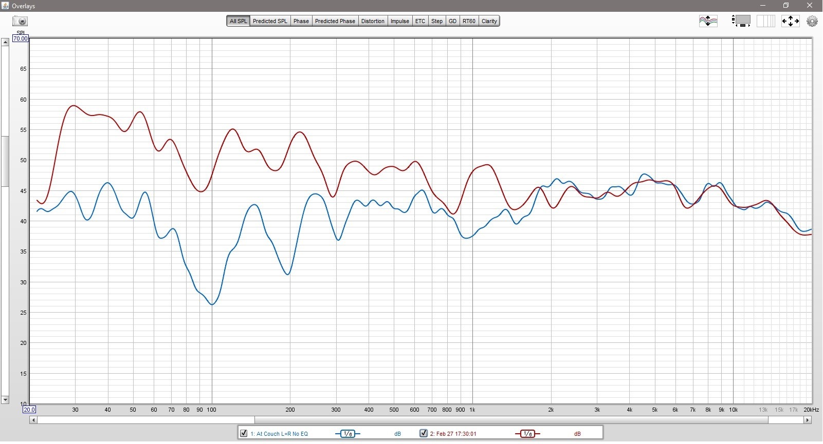

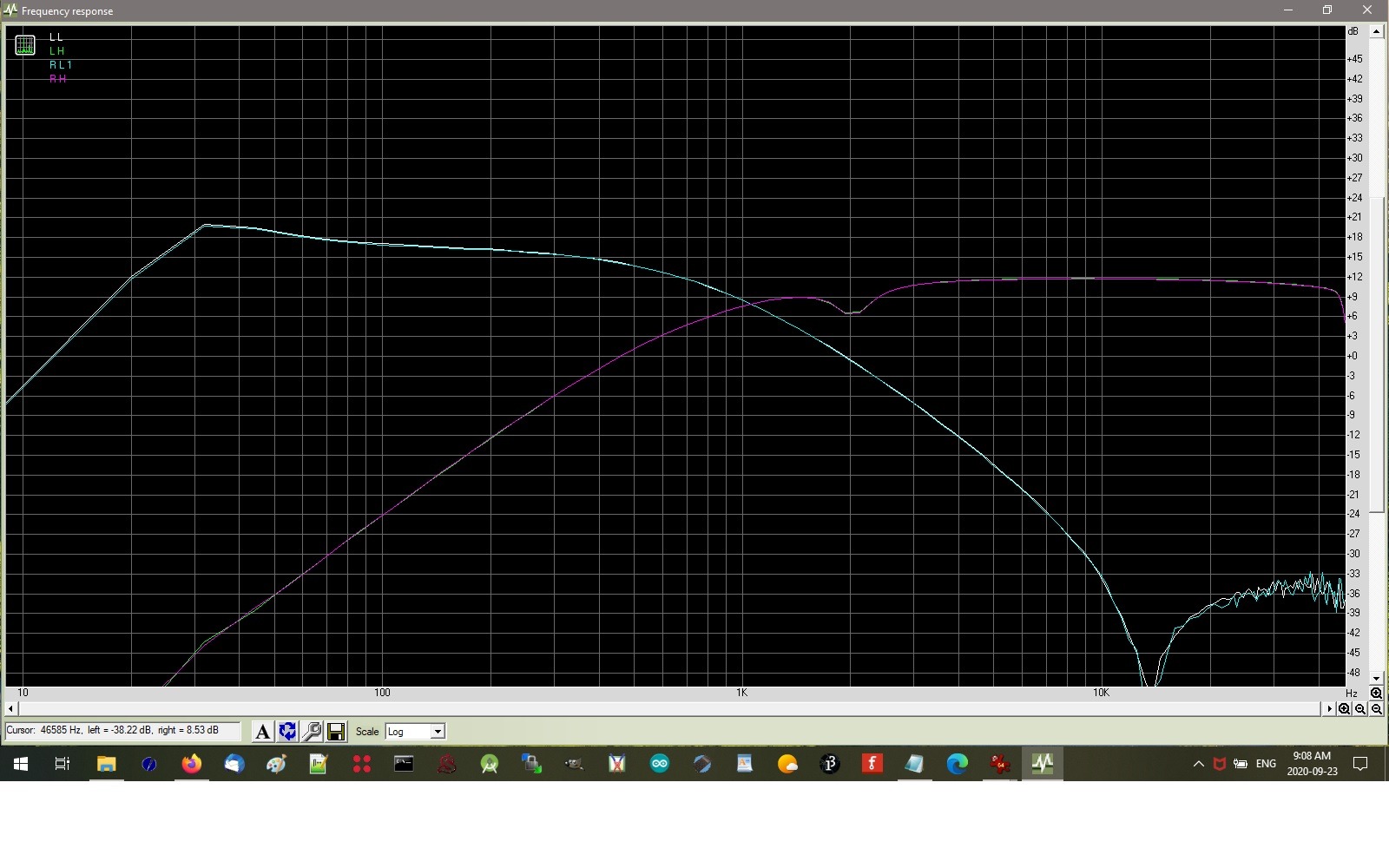

I have a bi-amped JBL speaker system which had an issue with a frequency response peak in the region of around 2.1 kHz. The effect of this was not always noticeable, but when certain female singers were played back, some notes in the frequency range were emphasized making for an unpleasant listening experience.
I identified the problem with frequency response measurements and configured my active crossover with a notch filter to eliminate the peak at 2.1 kHz. The crossover also adds some bass boost. The attached graphs show the unequalized (blue) versus equalized (red) frequency responses at my listening position and the frequency response of the active equalizer.
The difference in the listening experience was huge. The notch filter is quite narrow and not very deep but very effective.
