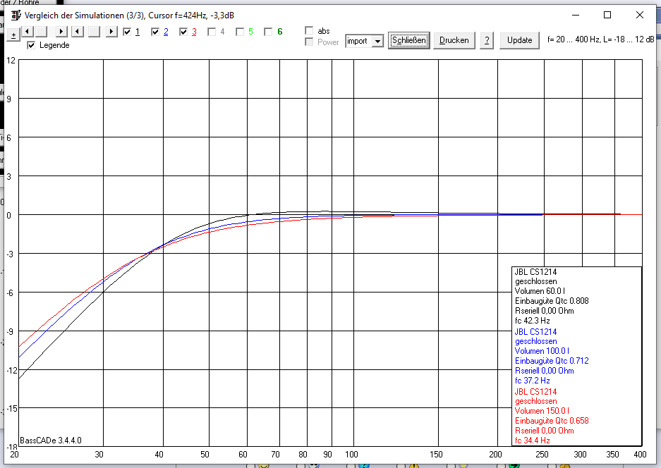

The CS 1214 is so cheap you can buy two, put each of them in their own enclosure and put them in 2 different places, that helps fighting the room modes.
Louder? Yes. Better? No, the impulse answer and decay are much worse.
Okay, I understand that reasoning. It's better to crossover the woofers higher than the sub woofer lower. The woofers are ported, I can convert to sealed, but if I left ported, would that have any affect above the tuning frequencies?
This would be used in various rooms, but the room is not small. It is a living room attatched to a kitchen and such. Maybe 500sqft and 8' ceilings. This is only for music and in my experience with my car sub that is -3db at 34hz, I would like it to go lower. You are right, I would be okay with hitting the 30hz mark. There is some rap music I listen to that get's down to 30 and bellow and I'd like to be able to hit that with a close to flat response.
That response for the CS1214 does look good. Qts of .5, I would sort of be stuck with sealed it seems though.

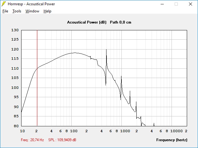

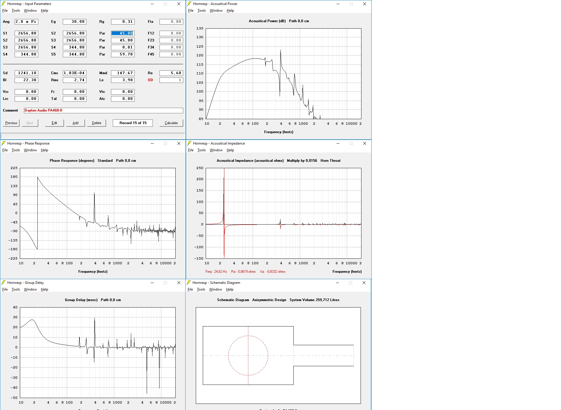

In a quite large box of 320 liters, which should be within your size constraints, you stay within the very limited xmax of that cheap but still very good 18", and get about 110db down to 20hz in halfspace.
I would like to suggest you build a smaller box than this, because then you would not have to worry about bracing and such.

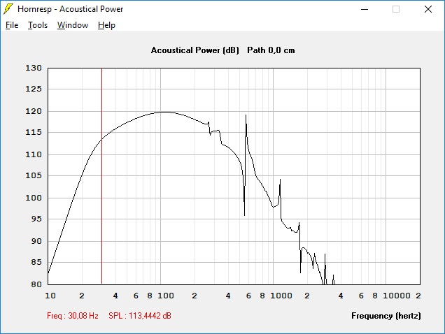

With the 18" I would like to suggest xo at around 120hz if you build a relatively normal vented or closed box.
Are you sure?
Edit:
A more reasonable 218 liter box still gets you about 113.5db at 30 hz, I would rather have that one instead of the 320 liter thing.
Or you could make a 260 liter box. Choices, choices...

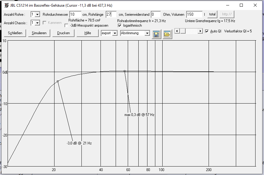

If you close the port(s), the Qt will be quite low, that means, you will have a early decline, (even above the tuning frequency) but very slow slope. I would not recommend it as it is not a great advantage but limits the choice of drivers unnecessarily.
Okay, with that in mind, the 2 JBL in sealed enclosures would work fine and they got the same cone surface as 1 18" but if you really aim for 20 Hz AND want it loud, you should really go for a ported enclosure.
I've just simulated it, BR would work with the JBL too, in 150l. It would look like that:
attachment.php
The JBL are not ideal for BR, the Qts is at the upper end which can (should) be used there and they fulfil your 20Hz requirement in 150l. If you know you want definitively BR, there are other interesting drivers, others already posted some options. Sealed got a lot better group delay and is more precise but BR can get louder. The JBL is a driver which can do both (within limits, namely enclosure volume will be big for a 12"). You're the one whose opinion counts. 😉
Just saw it, tuned that deep a bigger port (or more) would probably be better, it gets longer then though.

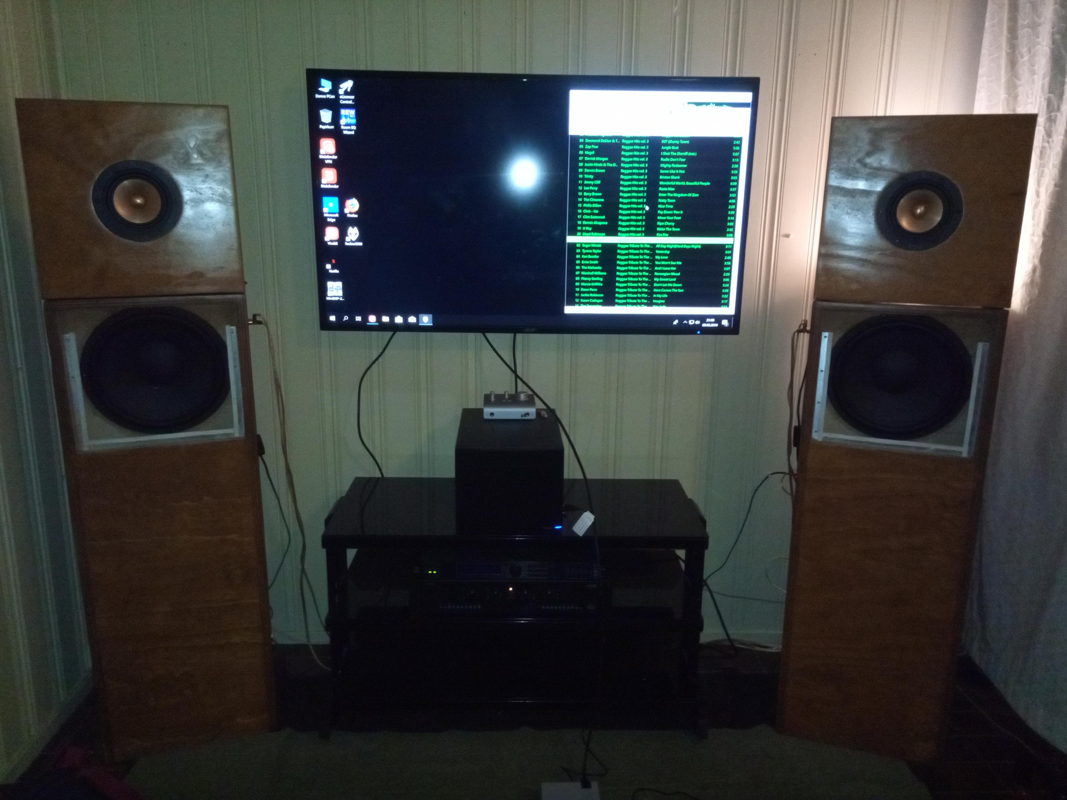

I like tight bass response myself. I have 6 x 15" in one of my setups, tight as can be.
Much better than my 2 x 12" system, crosses higher and smoother response.
It's all in the implementation.
761097d1559753800-15-range-fane-img_4475-jpg
attachment.php
But you choose whatever you want, it's your prerogative.
is this the fane 15300tc ? open baffle are the subs fane as well? I wondered what you were using for a crossover ? thankyou in advance !
Those in the pictures are old boxes, I made some new ones, the Fane 15-300TC are in about 80 litres closed volume and the double Fane 15-400 are in a vented ca 220 liter volume.
Bass is very tight.
I am considering cutting the tops off to make them more flexible, but otherwise quite happy.
Bass is very tight.
