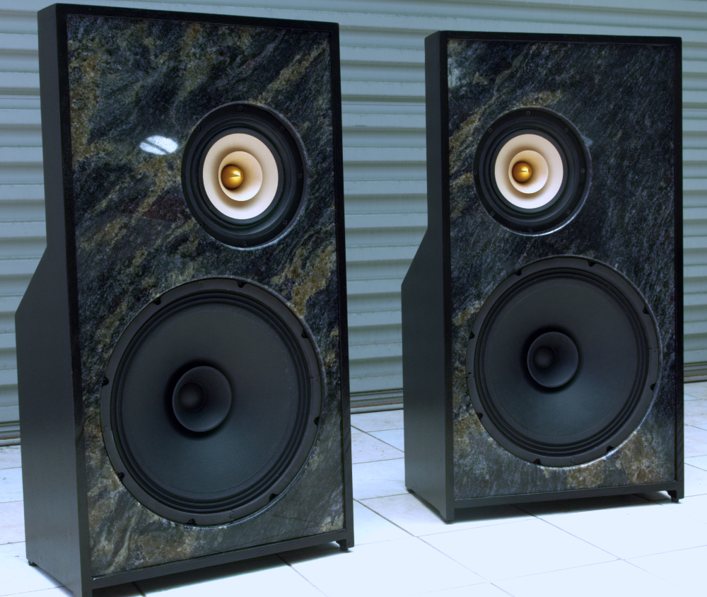

Actually, your room is quite nice for OB. Lots of space behind, and to the sides.
Line Arrays with a bunch of small drivers are really cool, but they need a lot of EQ to shine. A lot more than a regular AVR can provide.
Get a couple of 15" for bass from 80 to 400Hz, then let a fullrange driver take over from there.
A simple 1st order XO will work ok, but if you want them to shine and have plenty of punch, a Harsch XO is quite something, albeit more parts and more expensive.
A few boards of plywood will get you there. Add a veneer of stone to add damping and amazing looks!
Apologies for the shameless plug! 😀

Those look great! I have some Emminence 15s laying around that were for my Synergy horns, but I could always order more when I am ready to work on that project.Actually, your room is quite nice for OB. Lots of space behind, and to the sides.

Those look great!
Thanks! 😀
