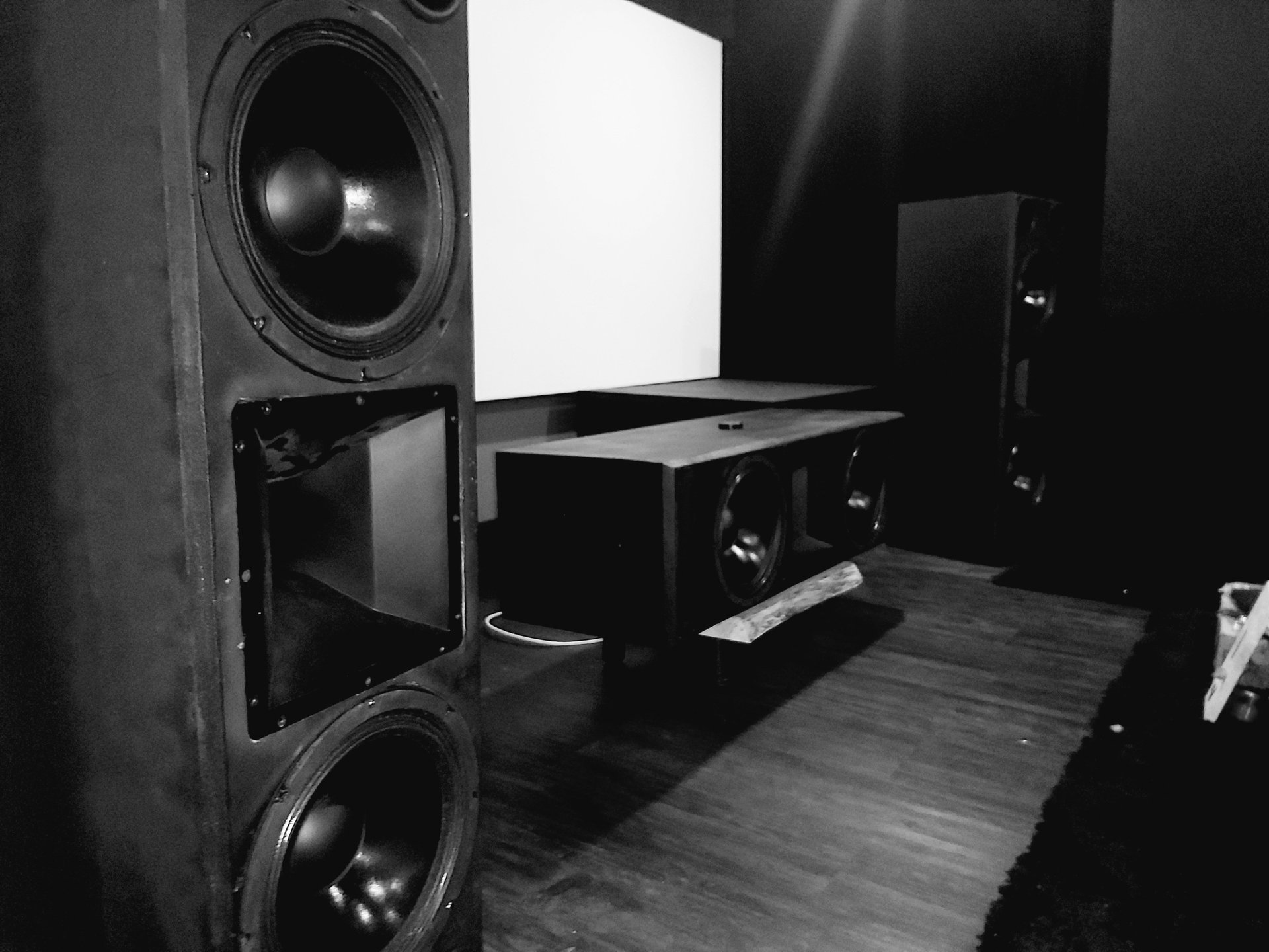

There is one build going round gathering some excitement ( though not here but over at AVS Forum >> search out a thread started by a fellow going by the moniker of "Schurter" in the DIY Speakers + Subs forum ).
His build is an evolution of a design first published by "Toids DIY Audio" ( who has a YouTube channel ).
- Schurter's design changes involve using a larger diaphragmed HF driver ( 65mm vs the original 44 mm ) and a redesigned crossover.
Toids design was inspired by the desire to make an MTM that resembled the JTR 212HT.
Schurter commissioned his redesign help from Joseph Crowe ( here in Canada ).
Joseph Crowe's ES600 BiRadial should be another step-up in quality ( I assume, though without any "ears-on" experience ) over the stock SBA horn.
The drivers used are all made by SB Audience ( therefore, are pretty affordable ).
Plans and crossover schematics will cost ( I'll assume ).
BTW; I've left out links on purpose >> you'll need to do a bit of searching on your own.

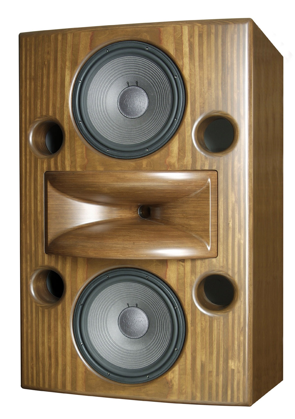

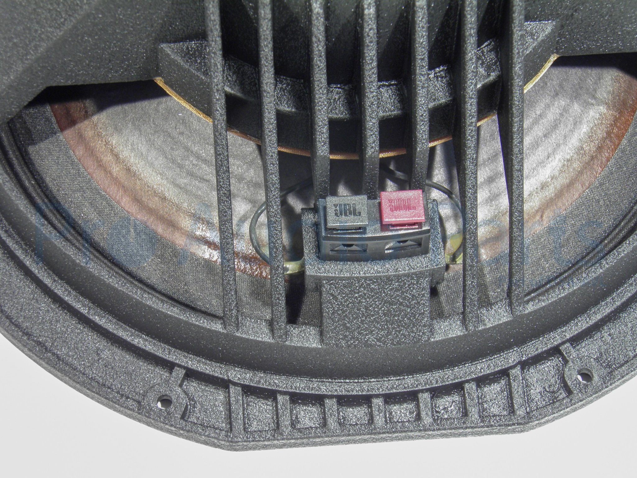

Take a close look at the K2 S9500, there is a specific reason the 1400ND drivers were made for this application.
It has a squared off basket, and the baskets O.D is a lot narrower in comparsion to diaphragm size, then just about any woofer you can find in similar sizes 12 or 15. Look at how close to the edge of the basket the surronunds end, etc in the pics below, from a 1400 pro that has the very similar design
Also notice how close to the horn the woofers actually are mounted on the baffle, and how short the horn is in the vertical direction, and the XO being all the way down at 650 hz. That is why those speakers actually make a decent MTM /WTW or what you wanna call it., well executed design by jbl.
While the G.T Sound, example using more conventional 16" woofers, a 30 cm tall horn, baskets 2 inches ish above the horn, but even with the lower crossover around 500hz, it will exhibit more lobing due to the design choices.
Large cones and MTM means large c-t-c spacing, needing a very low crossover to avoid the lobing issues that comes with it. Unless that is what one is after to manage vertical directivity somehow.
Some of the 12" you will find, does not give you a shorter C-T-C distance, in relation to wavelengths then that 14" JBL would, rather the opposite in many cases. And will want to cross naturally higher for a directivity match to the horn etc usually.

You might be getting the 2 projects mixed up
Toids DIY Audio did a build with a 1" compression driver Sb audience
I took the same idea and upgraded to the h280 horn and sb audience 65cnd-t CD
Troy Joseph Crowe is a few HRS from me he did the passive crossover,
All hiend parts,
