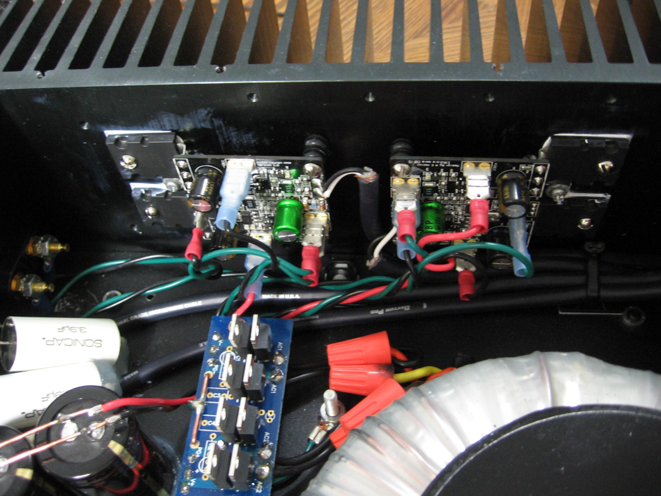

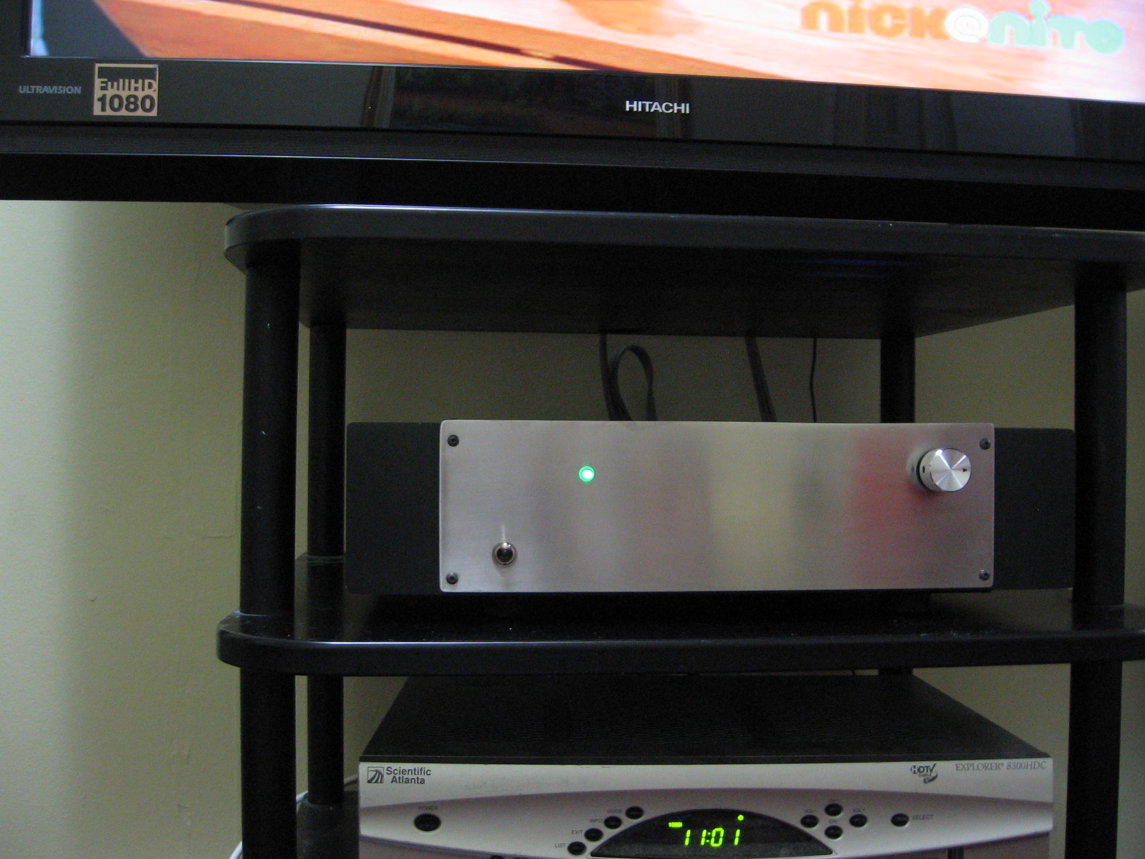

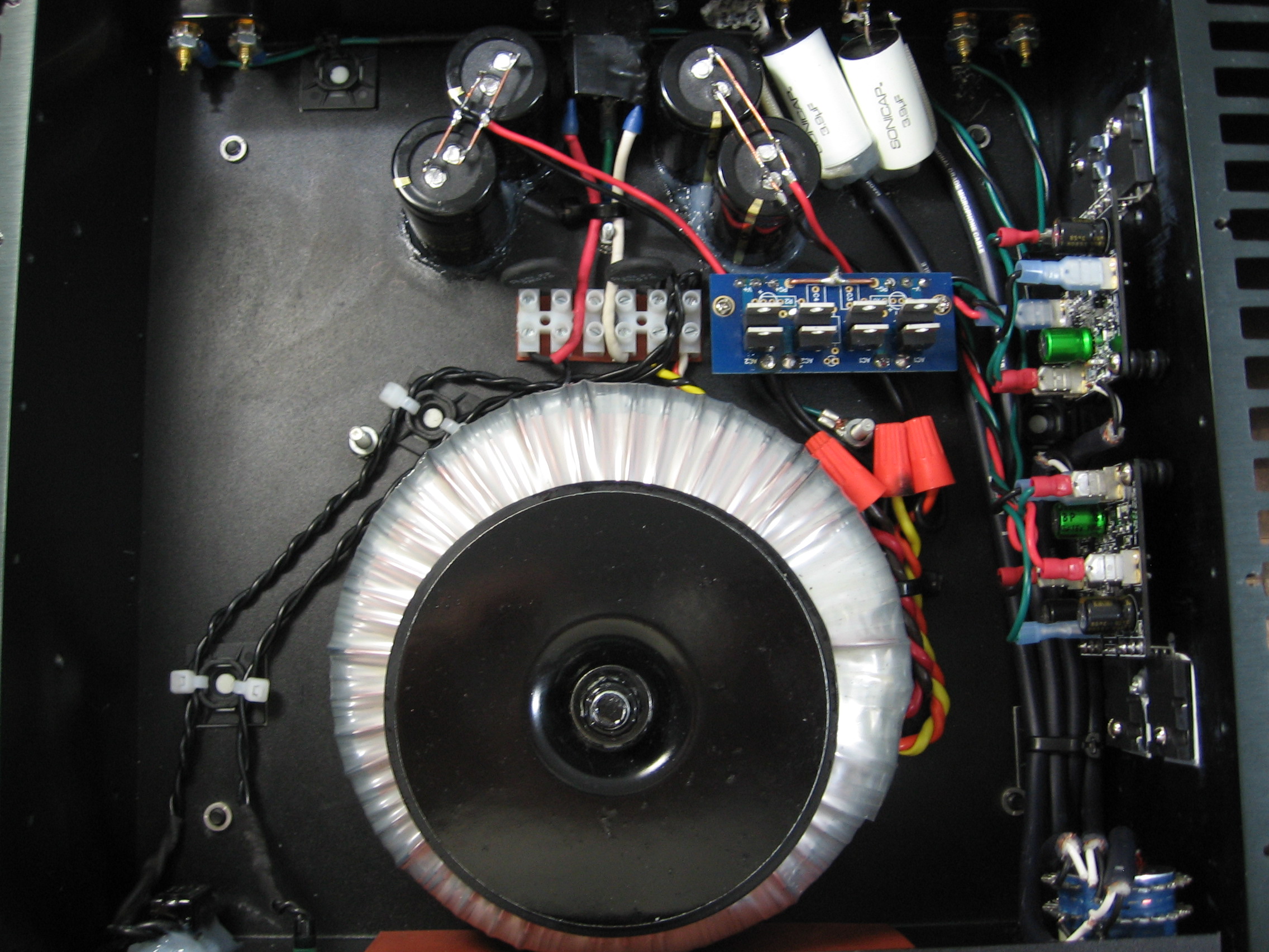

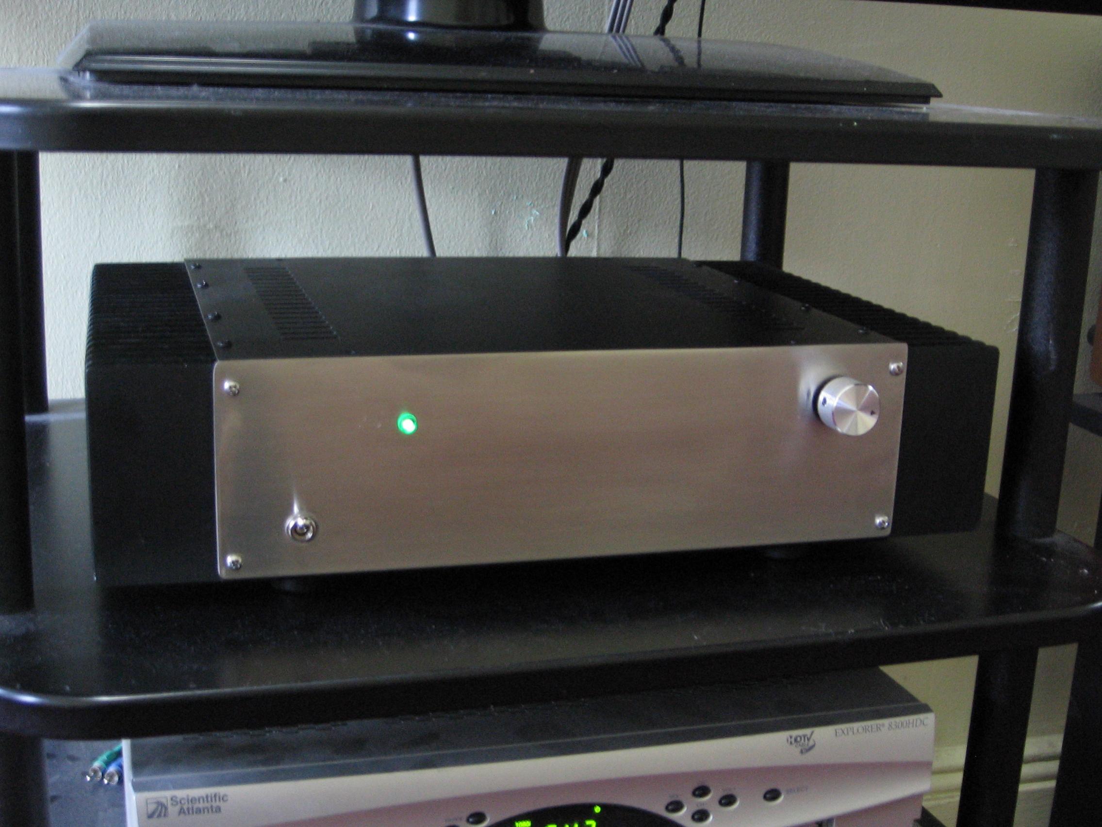

Well philmagnotta, it is not just specification in your amp that you are looking for... it is more than that. I believe the best tool that we have to compare sound quality is our ears. it can be THD 0.000000001% costing $$$$$$$ but if it does not sound good to your ears it is just a waist of money!!!. for instance I have heard good tube amps that had high THD and the whole specification was not so pleasant to "SEE", but sounded beautifully to my ears.
The Portal panache integrated amp that I had was good but it had some downsides like the high frequencies were way too sharp and that coses to get fatigue in your ears (painful) the bass was excellent(80,000uf) with mid-range very well controlled. The design was a "minimalist" which I loved it, the parts quality were good (it could be better) The amp does not use any kind of relay
(I like it) so when you turn off your amp you will "still" listen to some music for a couple of seconds (same as Adcom amplifiers and many more).Some people do not like this ( I do not mine it now).This amp is very well build and the sound is very good, I also noticed that you can hear back noise so it is not so quiet this amp.I do not like to see or to use too many caps in an amp and if I have to use many capacitors inside of an amp I like to use the best quality as possible. for example I use in my diy integrated amp 4x10,000uf Mundorf Audio grade caps in the power supply and in my LM3875 I used Black gate caps. some people say it is a waist of money, but if I feel better using the best parts I can get....Why not?.I have had some Bryston amps, they are excellent amps for the money.

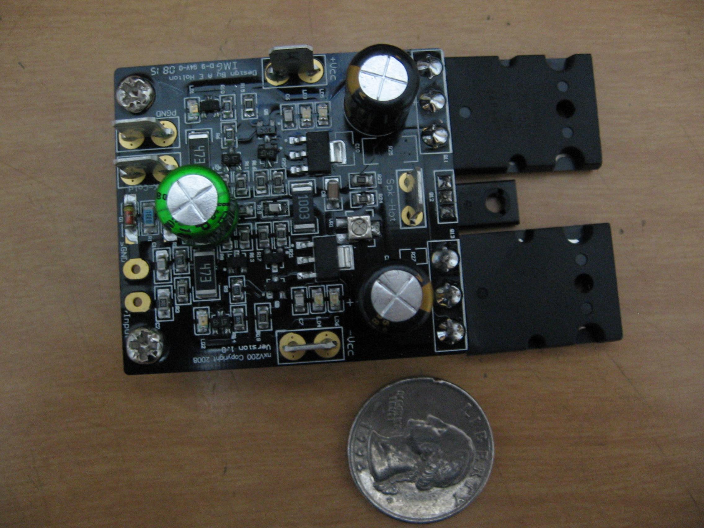

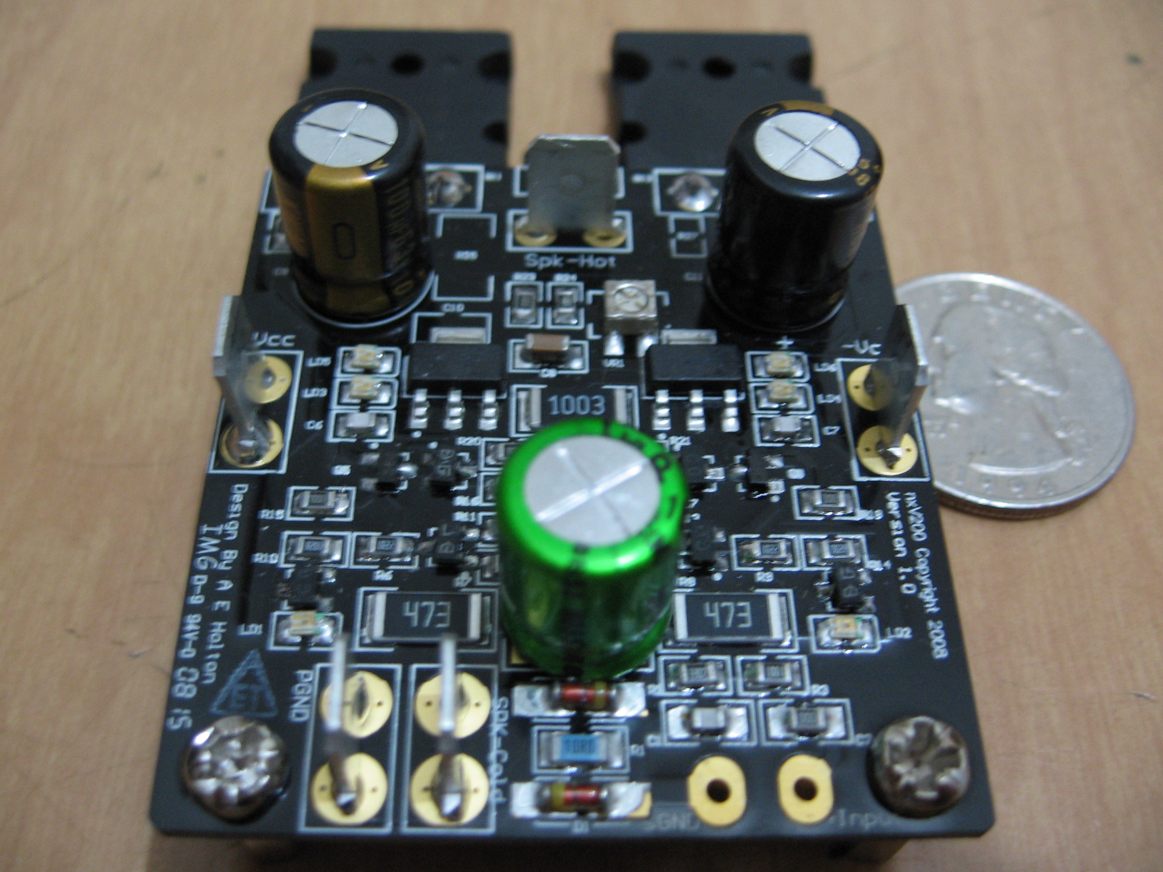

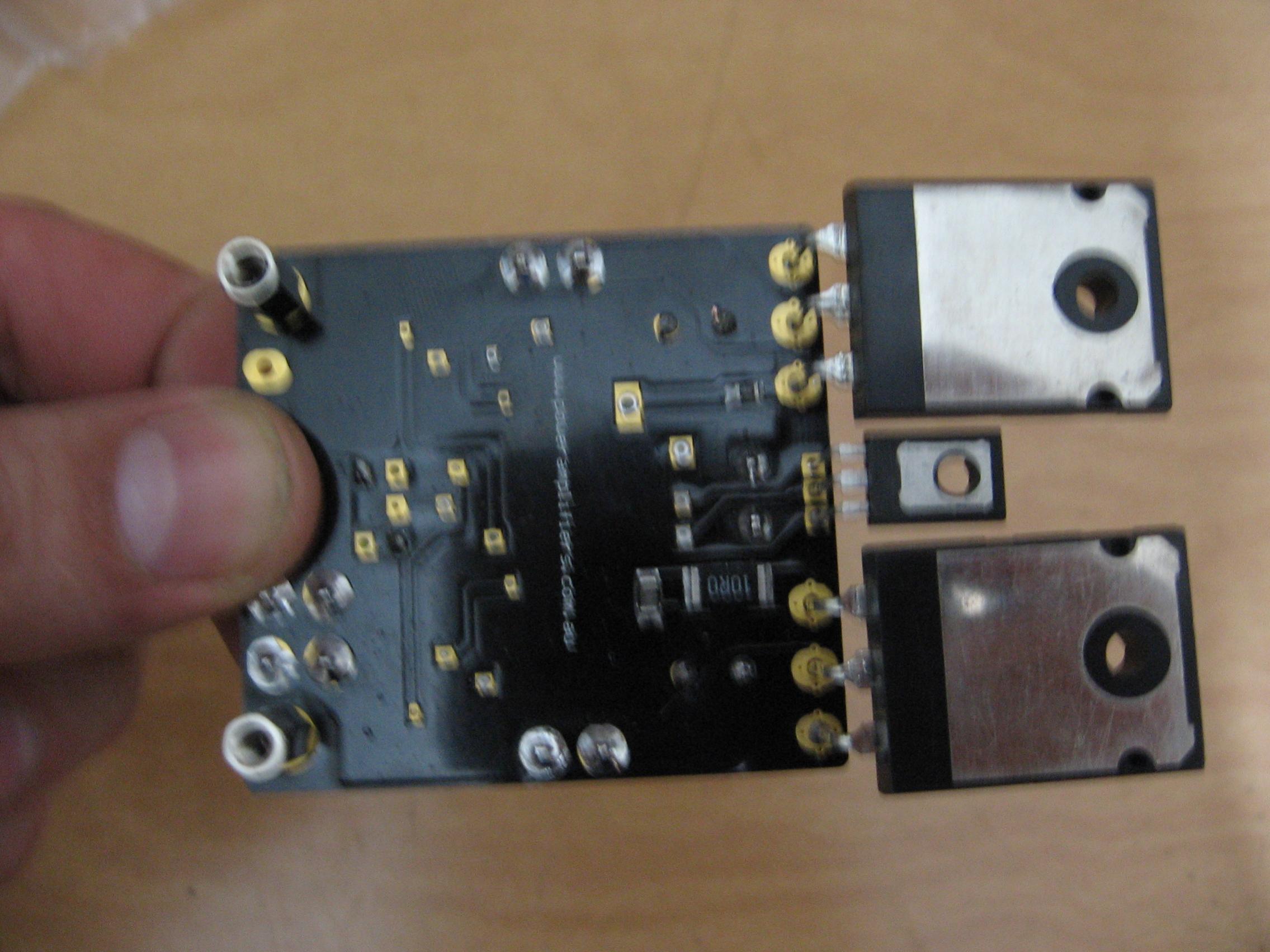

if you are in the diy fever like me lol, you should give a try to build some amps. one excellent source is Aussie Amplifiers. I got these NXV200 boards from them and they are so good that I even bought extras lol. take a look.
Specifications
110 Watts RMS continuous sine wave into 8 Ω
180 Watts RMS continuous sine wave into 4 Ω
The HPA-nxV200 is 2 Ω Stable
Biased into Class A/B
Power Bandwidth 3.5hz to 600khz -3dB
Small Signal Bandwith 3.5hz to 3.5mhz
Slew Rate = 80v / microsec approximately
Dampening Factor At 100hz 8Ω = 800
Dampening Factor At 1khz 8Ω = 650
Dampening Factor At 10khz 8Ω = 250
RCA Single ended Input impedance 33kΩ
Single Ended Input Gain = 30.6dB
THD+N - Typically 0.005%
Recommended Linear Voltage Supply +-50 volts DC
Operational Supply Voltage Range +-10v DC to +-60 volts DC
PSU Power Transformer secondary windings 35vac (225VA to 400VA)
Printed Circuit Board Dimensions 50mm x 50mm
Ultra small form factor PCB
Designed as high performance Home Theatre multi channel amplifier
Or High End 2 Channel stereo amplifier
Unconditionally Stable into any load from 4 to 16 Ohms
Extra Heavy Duty three ounce copper printed circuit board
Ground plane Layer for very low noise.
Rugged high performance complementary Toshiba MOSFET Output Stage.

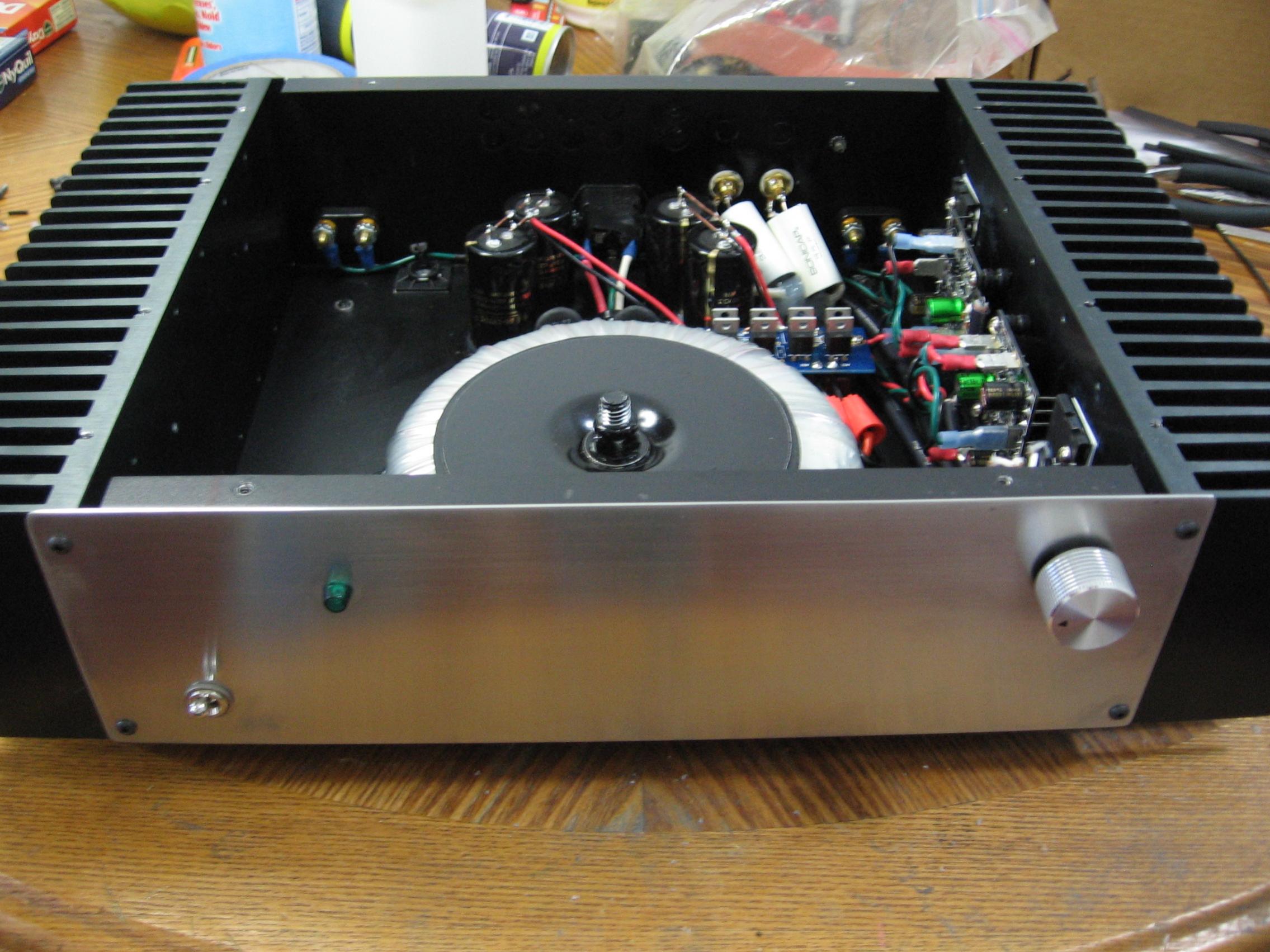

If I can build one...Anyone can. I had never soldered before and know nothing about electronics at all. All in all my amp cost me about £180 for the kit, enclosure, transformer and all the connectors etc. If you are willing to spend such a vast sum of money on an amp... Give it a shot first, you wont be dissapointed, and its a fraction of what your willing to spend.
Thank god we have DIY!!!!
I am trying to convince him to get his feet wet into diy. I did build an LM3875 from Audiosector and it sounded wonderful. now I have an diy integrated amp using NXV200 boards from Aussie Amplifiers. and the best of all is you choose the parts quality you want to use. There are many diy amp kits from many companies and most of them will kick butts of those commercial amps for sure.The only way to know this is GET YOUR FEET WET INTO DIY!!!!!! you will not regret it.😉
