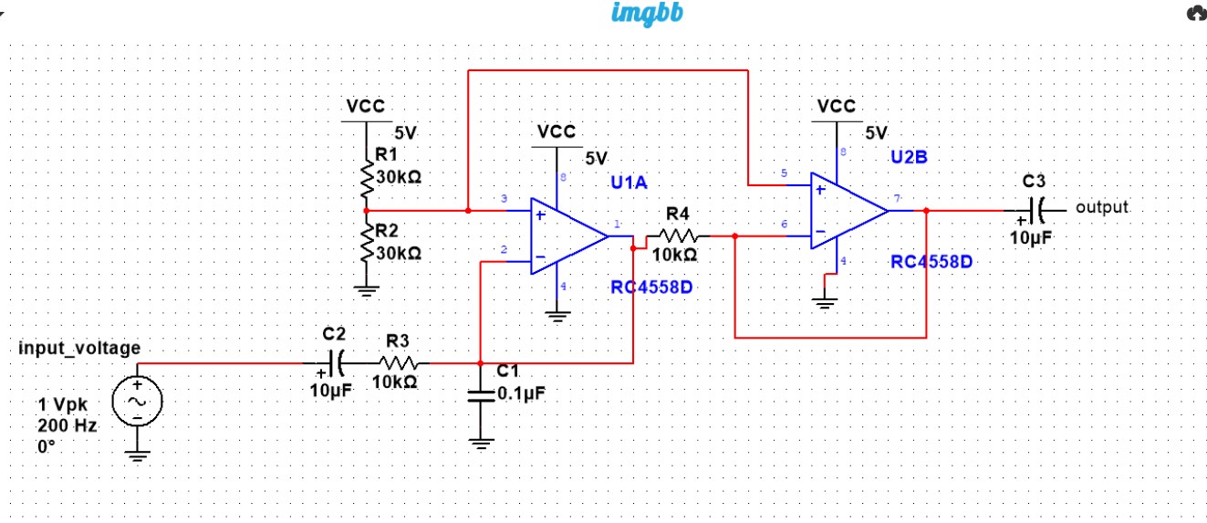

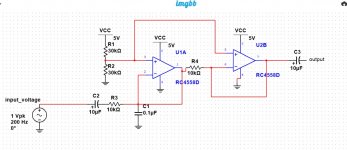

can anyone give the circuit of bass boost of 4558op-amp using single supply. i'll try this circuit too much but not getting bass boost using single supply voltage..thnx
Post the diagram of the exact circuit configuration you are trying to use on single rail.

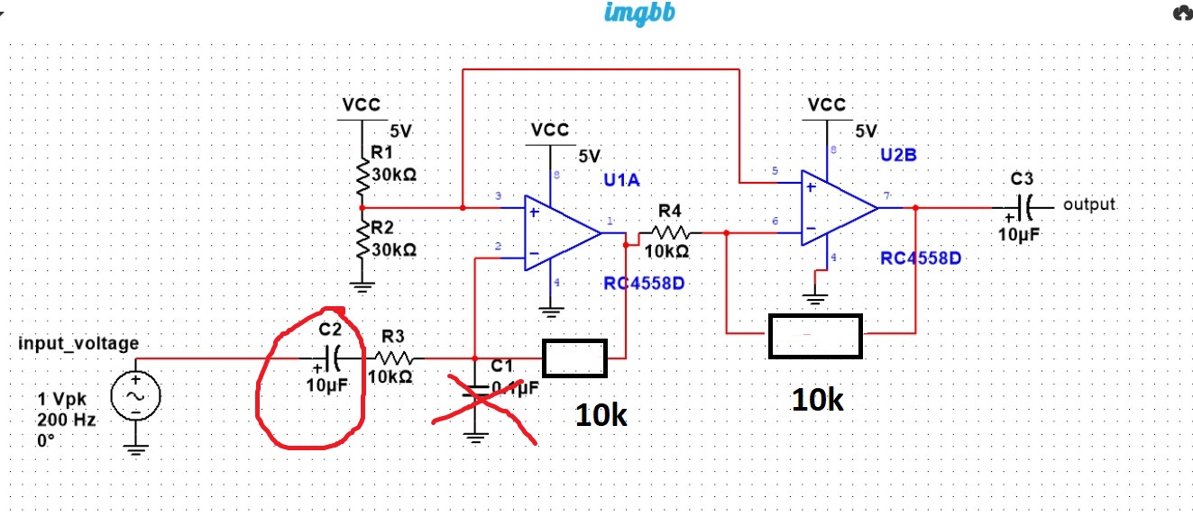

Right then... it won't work. The configuration is all wrong. The first opamp will produce absolutely no audio output because the input (via the 10k) is feeding into a 'virtual ground' which appears as a short circuit to audio.
The same applies to second opamp. It can not work.
Even if you correct those two errors, the response of the circuit will be unusable I suspect.

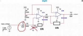

so what to do in order to get output signal
It needs a total rework. As it stands (after a simple modification) you can only configure it to reduce HF, not boost bass.
Even the input coupling cap is the wrong way around. It is a disaster.
This will give a gain of '1' and you could then add caps to reduce HF but not to actively boost the bass.
Also I think 5 volts is to low for the 4558 opamp to function correctly.
