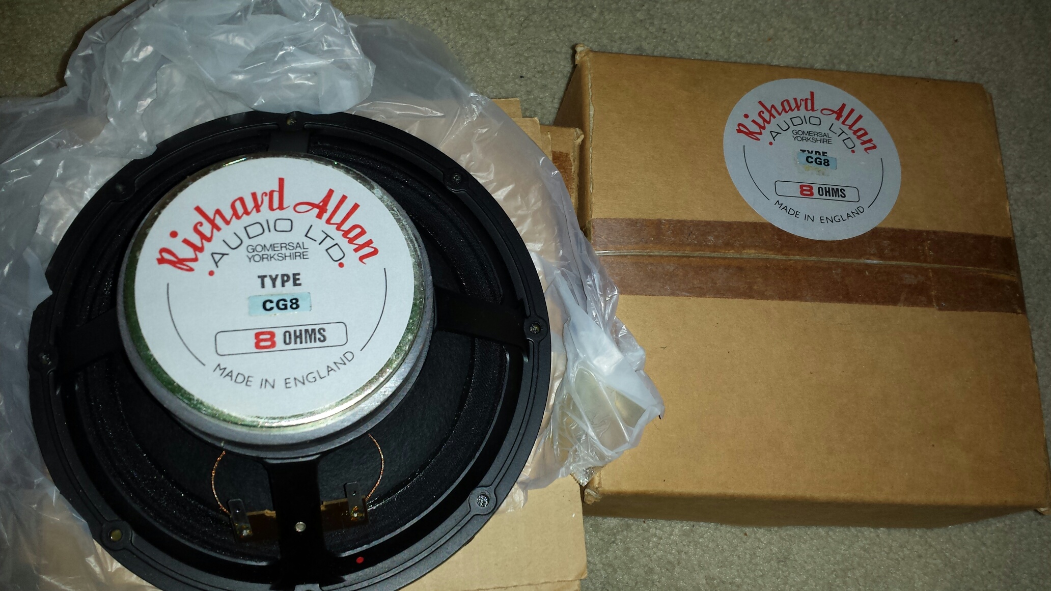

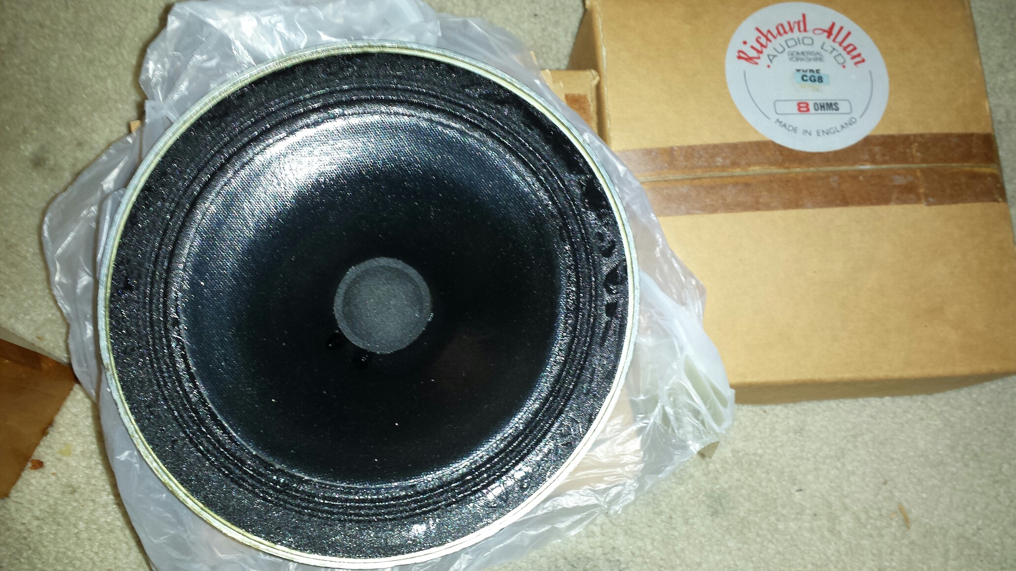

I found these drivers pack away from my Garage. Does any body have a the T/S parameters for these 8 in drivers ? I tried searching for them on the Internet but could not find anything on them. If I can't find anything on them, I may build a simple box and use it for a Guitar speaker.

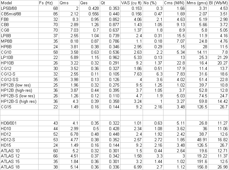

Factory specs loaded into a WinISD Pro driver file: Downloadable WinISD Pro Files - Page 4 - Home Theater Forum and Systems - HomeTheaterShack.com
