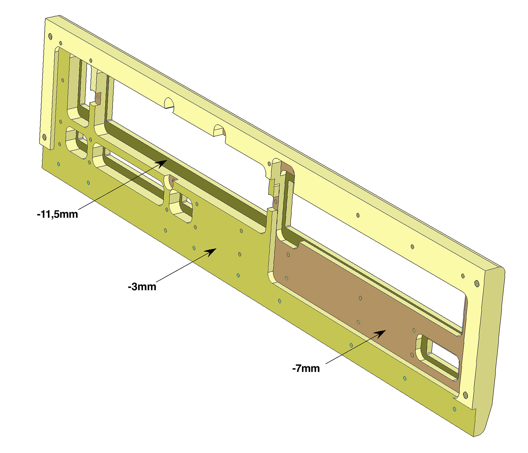

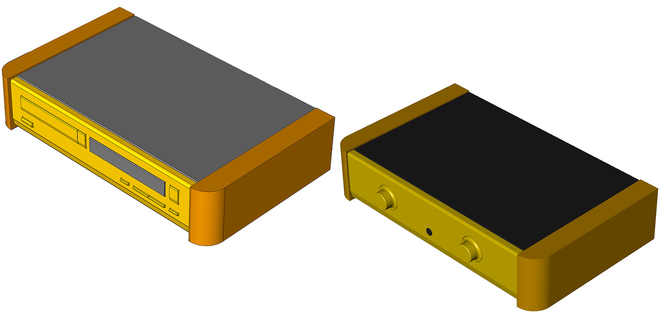

Within two years i put my spare time in designing my front panels - (no joke)
and of course I do not want to fail in the very last step, the anodizing process.
So i urgently look good base material to preclude a possible failure.
(BTW if the aluminium was simply painted, there would be no need of having good base material)
But maybe, in this great forum, there is somebody, producer of front panels / cabinets or DIYer deeply involved in aluminium production,
who could kindly help me in finding some well produced alloy? Or has some leftover aluminium plates?
I do not need much, at least 15 mm of thickness, about 500 x 500mm length of the aluminium plate (or 110 x 2000mm minimum as one alternative).

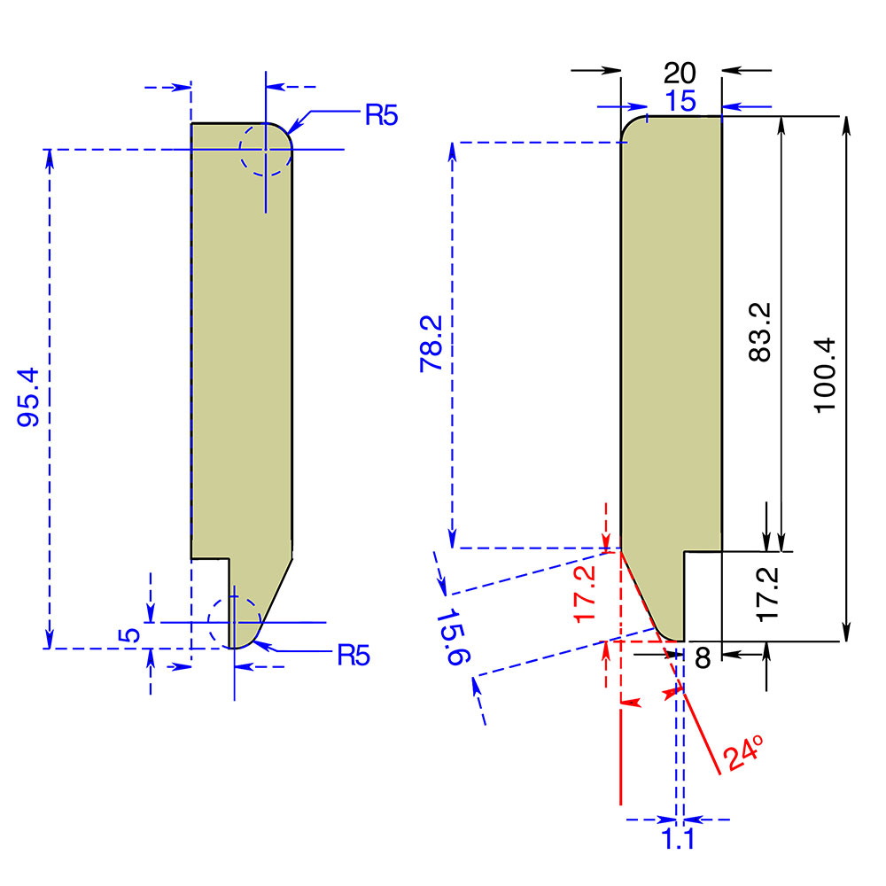

Because panel thickness is about 20mm. No shop here in Europe specialized on DIYers mills more than 10mm. The guy who does the metalwork for me mills machine parts and produces winches for RC-gliders. He has his routines with suppliers providing aluminium for mechanical purposes.

BTW, this is how it will look like. Drawing and CAD data are finished since march
Aluminium front panels and knobs, black opaque glass for the covers and wood for the side panels.
Images are overview of CD-Player and Amp, backview of the CD-player´s front panel and basic profile of both frontpanels
