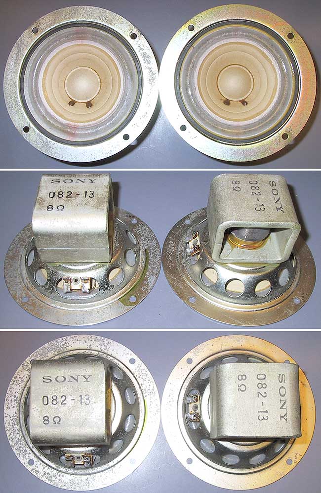

I got a pair from RTR TC500 but I not find any parameter on net anybody have spec on this driver?

Unlikely because they are pre Thiele Small era, but worst case you can measure them yourself.
Or plain use them in a largish (for their size) stuffed cabinet.
Doubt they are good performers in a tuned cabinet anyway, they were used as "better than nothing" monitor speakers in an old style tape recorder, not Hi Fi stuff intended.

If the speakers in question are as i pictured, they are really quite good, but many of these did not age nicely. Quite a few of the ones i had have surrounds that have stiffened up and that makes them midTweeters, as the bass resonance goes way up.
A safe enclosure for a good pair is Frugel-Horn Mk3.

yes my speaker are same with you picture Frugel horn look good but do you have smaller cabinet plan?

this driver are work with miniOnken or fonken?

I found this while looking for something else and thought it might help in your search for info:
Glow in the Dark Audio - Coral "Holey Basket" fe103a full range driver
It’s more of a review but it does show the drivers transplanted into a Telefunken cabinet and the gentleman seems quite knowledgeable regarding vintage gear. Perhaps you could contact him and see if he has access to specs.

- looking for Sony holey basket parameter to design cabinet
