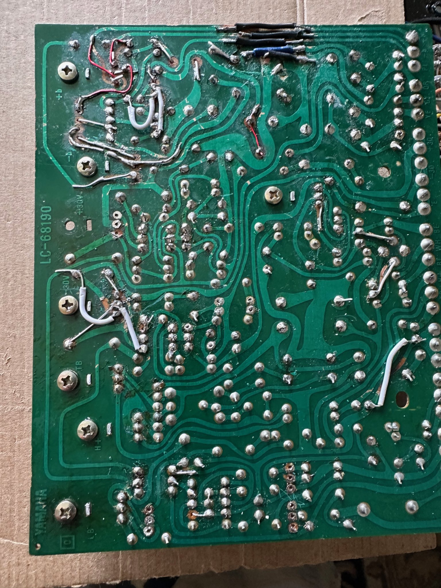

Looking for someone to replicate a single sided circuit board
I'm restoring a Yamaha CR-3020 and the previous owner has near destroyed the power supply board. I've reached the point where I can't spend any more hours trying to get it to work. Would a solderable protoboard like this work?
https://www.amazon.com/Double-Sided...s_306847011_sccl_29/131-8598011-7649450?psc=1
Also looking for: 1) someone who replicates single sided boards, or 2) someone that can recommend a person or company to replicate the board. TIA!
Thanks for a pic of the backside now how about one of the top side?
Using a prototype pcb is a lot of work, but it’s doable
The edge connectors pins on the original are probably on 5mm centers so that’s an issue
I answered you on AK about designing a new ps pcb for you
