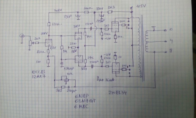

Trying to help a friend with his Xindak MT-3 (EL34-PP), but without a schematic, the job is very difficult.
Has anyone a schematic or can point me to one?
This is what I have got and I am not even sure if it is correct.

There is an intrinsically unbalanced phase inverter in that schematic.
And for best performance, it requires super well matched triodes, and may require some adjustment of one or the other of the plate loads.
Instead,
With a real current sink to the parallel cathodes, and matched plate loads, it would be intrinsically balanced, even if the two triodes are not super well matched.
