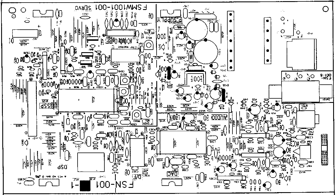

Hi Dan.
Have you checked how close the schematic is to, say, XL-V151?
Service manual for this player seems to be available for free at JVC XL-V151 Manual - Stereo Compact Disc Player - HiFi Engine
I do not know whether it is even close, not knowing which dac etc your player has, but it does not hurt to check.. 🙂

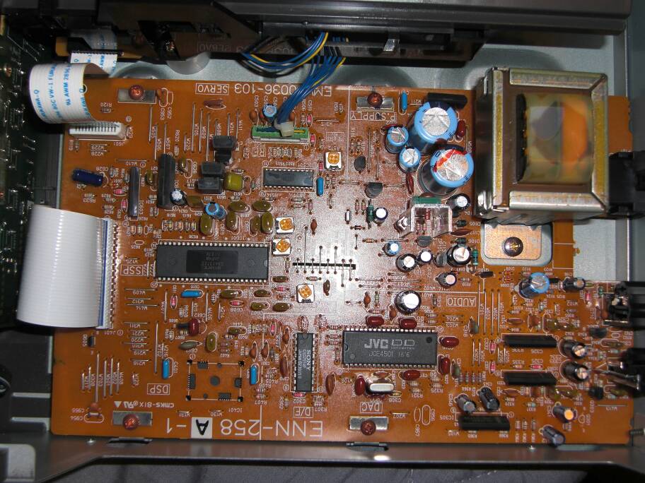

Thanks, I'll check it out... I really don't know if they're similar, but looking at this one, I should be able to tell.
Could you please check which DAC XL-V141 has?

No problem 🙂
To me it seems the board is the same one as in XL-V151, look at service manual pg.35, it shows the board from solder side.. I really think they do have same circuitry on the main board..
Btw, what for do you need the schematic of your player?

It may well be... Only using a 7" tablet ATM.. . I'll print it out a bit later.
Reason? A few caps are a bit swollen, and a few components look like they'd been replaced in the past, judging by the solder side of the board. It works, but I wanted to see what the original values and part numbers were before proceeding.
