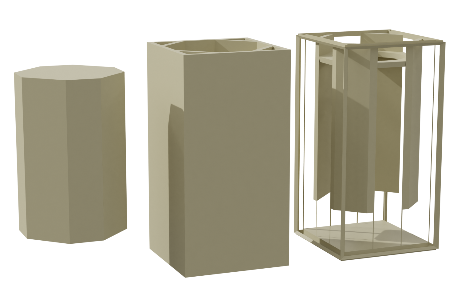

Can someone help me out with the volume of it. Thinking of putting my x-12 in it for a minute if the numbers are close enough
29,5 depth (tall) x15x15
The front for the sub is recessed from the top 2.5 “
The ports are 3.5-3.5-4.5 triangles and they are 23.5 “ deep and there are 4 of them
The face where the sub fits is 2.3/4 from the top .
Everything is 3/4.”
Any thoughts? Ideas? Anyone know who made this? It is very heavy

Octagon, not hex.
Roughly, it appears to be about 1.7ft^3. It's hard to know where the enclosure part ends and the port begins.
This is what I got from your description. The left-most piece is the effective volume.
