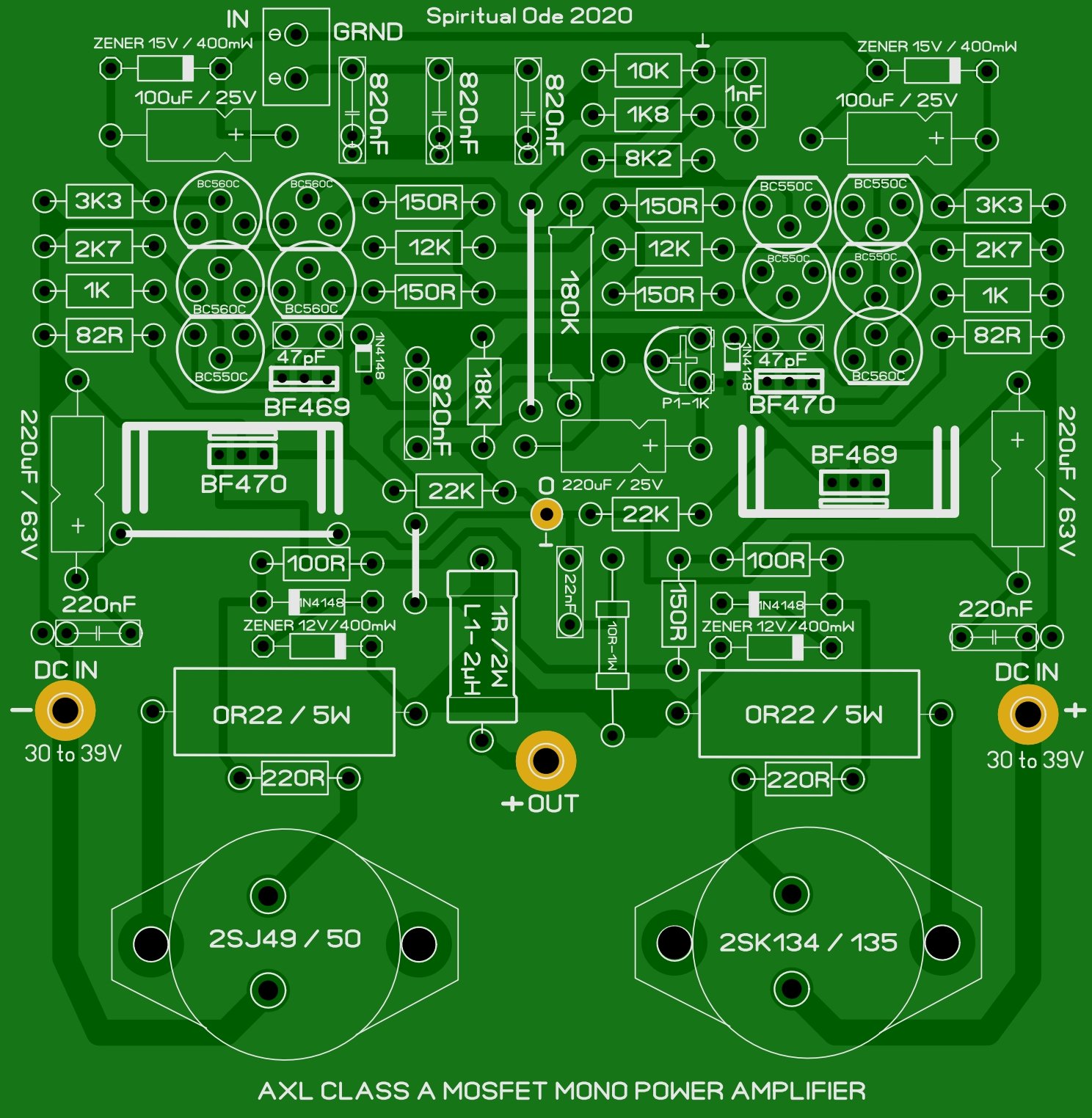

Are the pcb's of this AXL V2 version available somewere ?More then 30 years ago (1985) I build the Elektor AXL class A/AB amplifier, time to upgrade this amplifier using new (= better)components.
My main goal was to replace the power mosfets 2SK134/2SJ49 with Exicon ECF10N20/ECF10P20. Also the medium power transistor BF469/BF470 changed to MJE340G/MJE350G.
Extra power supply filter capacitors where used and placed on the PCB.

Could you use any pcb drawiing programs? It looks not difficult for drawing. did you check the lang amp? The same generation and looks better...
No i have no pcb drawing program to work with , thought HerrFlick might be gentle and provide the Gerber files
If you dont find any gerber or pcb let me know i can draw for us. And please check the lang amp on forum. I would like to try both amp and definitely i will draw pcb for them. I am busy little my jfet class a buffered composite tda7293
Hello,Could you use any pcb drawiing programs? It looks not difficult for drawing. did you check the lang amp? The same generation and looks better...

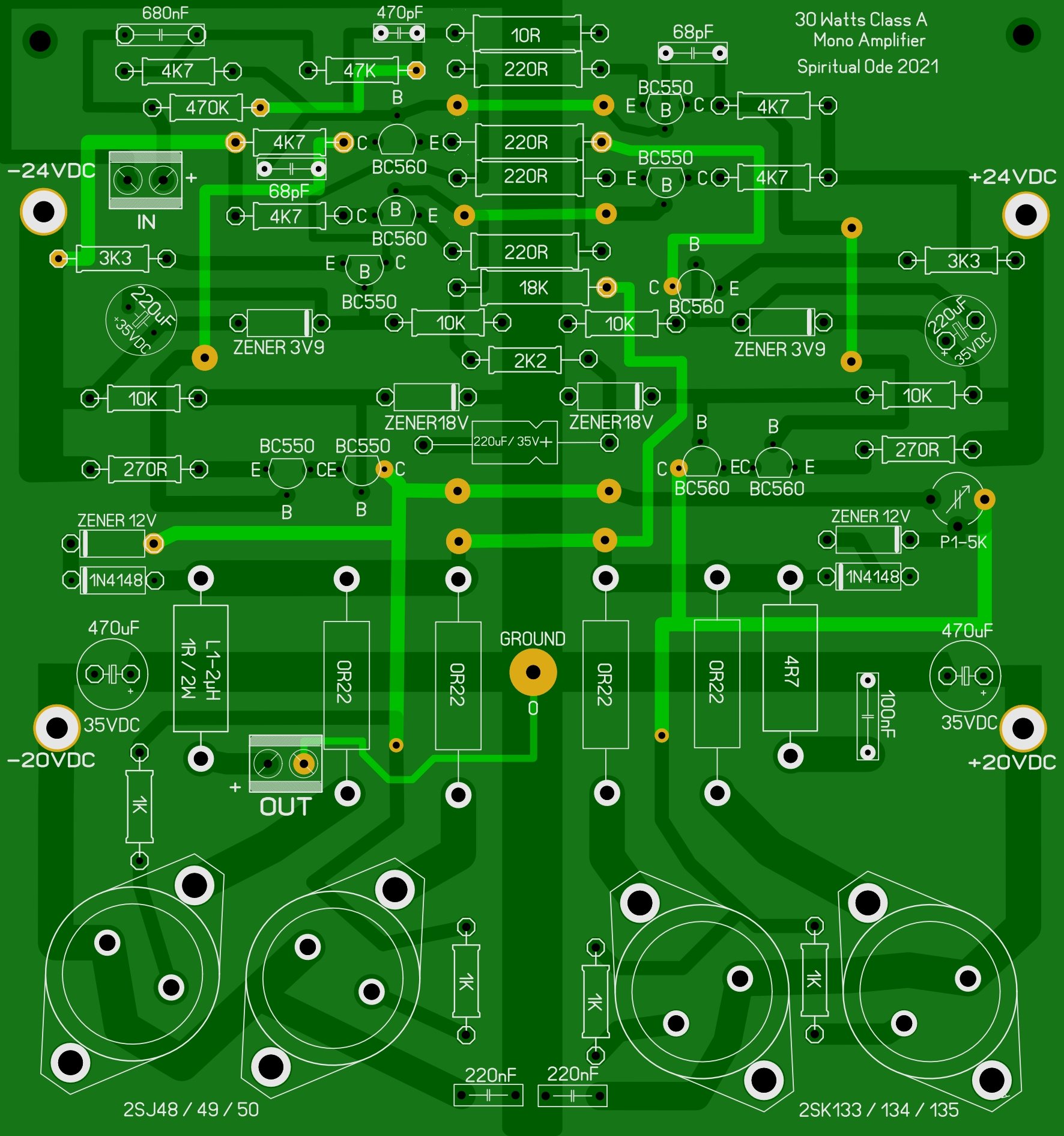

I have both AXL ( elektor ) and Lang PCBs and gerbers of sprint layout 6.0. I built them both 5 years ago and sound really good. My PCBs had been ordered by JLCPCB in China. I can post some photos if you want to see what I am talking about.

Are these boards meant for the original Japanese laterals ? I have a nummer of the Exicon to3 ones too.

If HerrFlick schematic is identical to the elektor one but the TO3 only, you can use my gerbers or the PCB using your exicon mosfets. The old mosfets must be matched. I don't know about EXICON. BC550C and BC560C must be matched too. The quiescent current must be adjusted to less than 750mA for good results. Have a look at the PCBs.
Those boards are looking very good 👍👍
Meaning , large heathsink ! I have some huge ones here .
Which one you like best ?

There are a couple of spare boards of both. Send me a PM for all the details and the PCB photos.
Lang power amp is slightly better than AXL using 2 mosfets per channel with lower voltage and 2A quiescent current. It's up to you. I have built both of them and they sound superbly. A dual mono is recommended.Those boards are looking very good 👍👍
