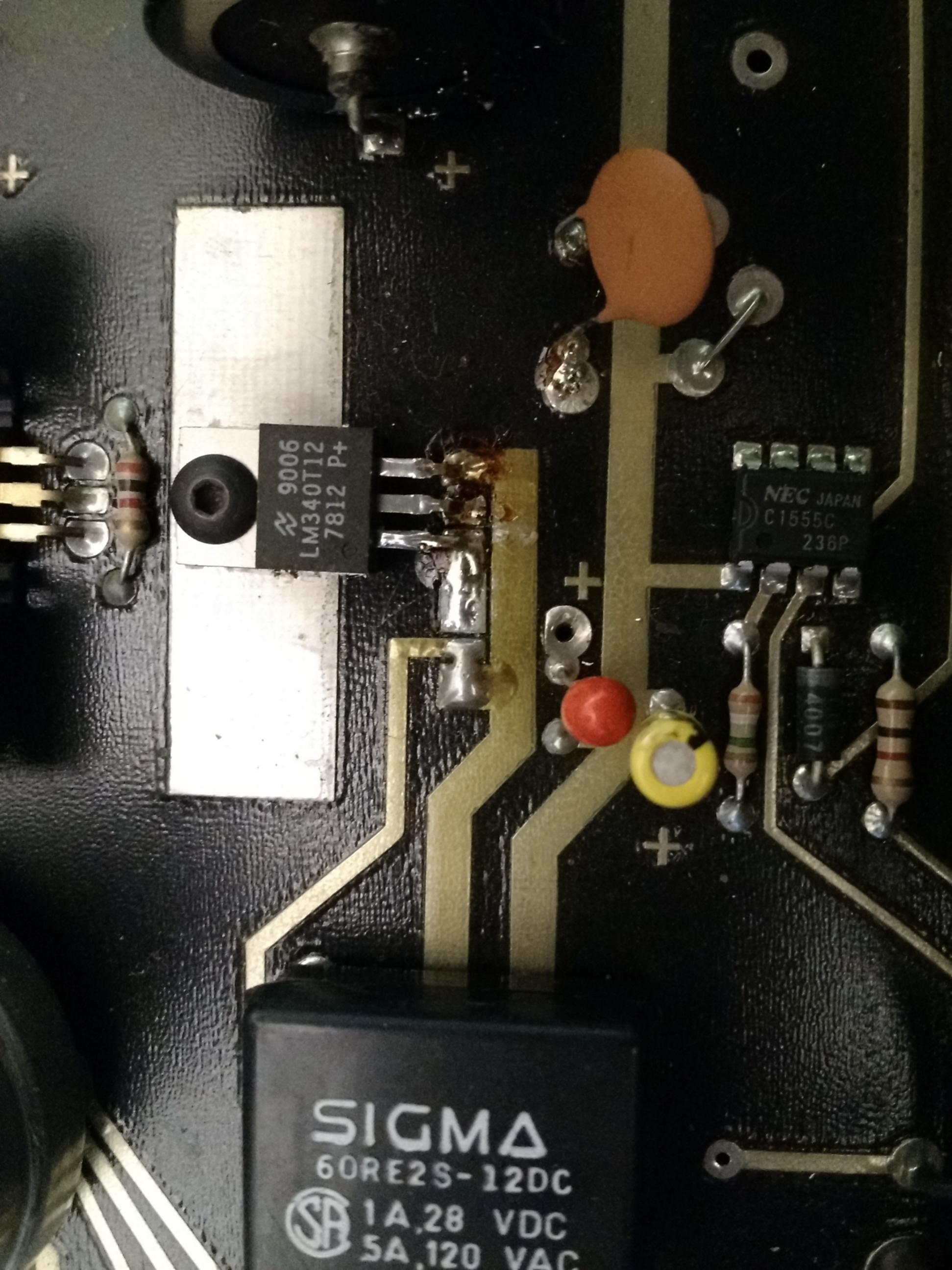

Hi all,
I have had a Precision Fidelity C8 since the mid 80's, used it as the main preamp for many years. Probably 10 or more years ago, it failed. I would like to get it going again.
Should be simple (I think). When powered up, tubes glow and the front panel standby LED blinks. The unit never comes out of standby, apparently the timer power relay in not being energized. I have what is supposed to be the schematic, but the relay and 555 timer are not shown as far as I can tell. I'm somewhat handy with a soldering iron and have a basic understanding of circuits, but don't have enough knowledge to reverse engineer the circuits here to troubleshoot. Will welcome any advice. It does look like the LM340T 7812 has been replaced at some point prior to me.
Hi all,
