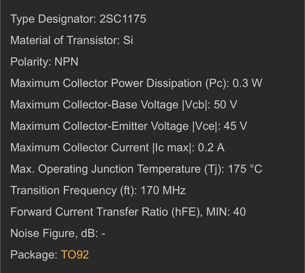

That isn’t too much of an issue, the one I’m having the most trouble deciding on is H704 which is a 2SC1175…

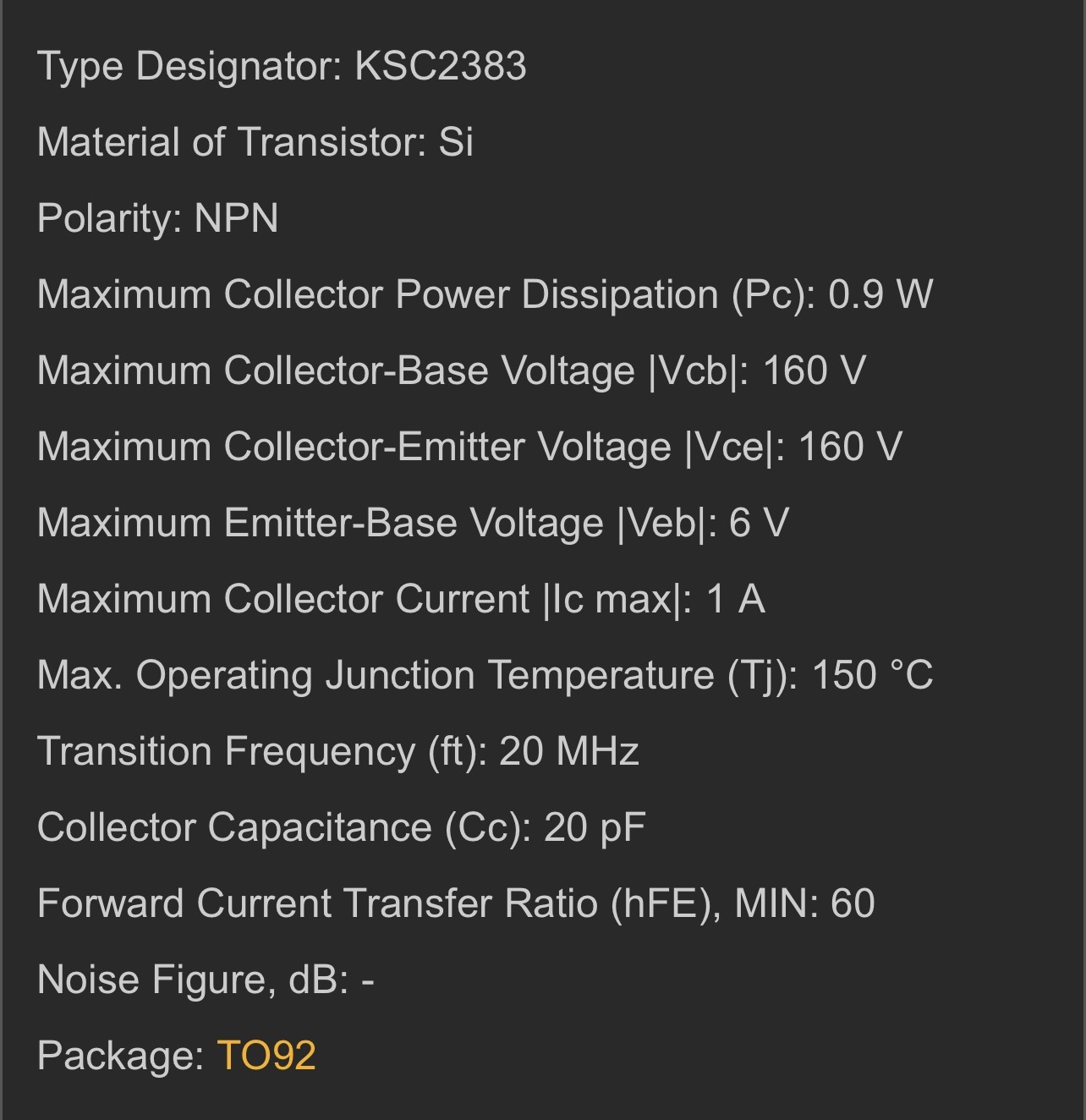

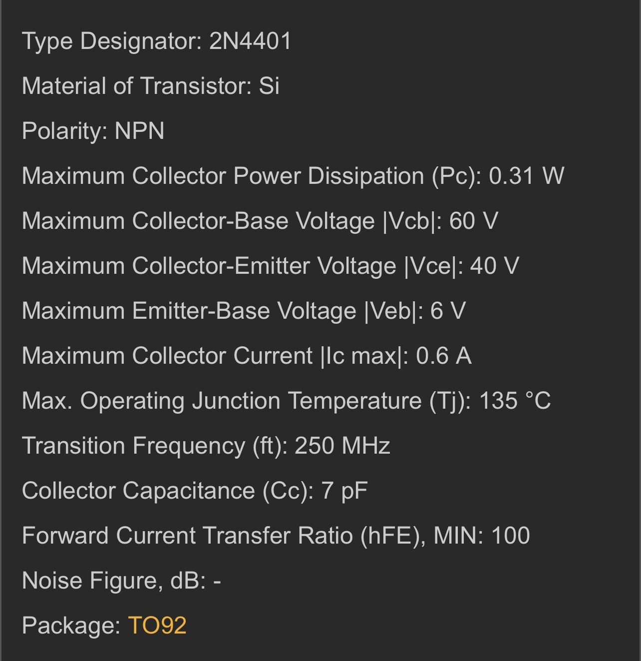

H704 is a 2SC1175, I’ve seen multiple places on Audiokarma that the KSC2383 is the recommended replacement.
Is going from 170 MHz to 20 a good idea when there are other possibilities?

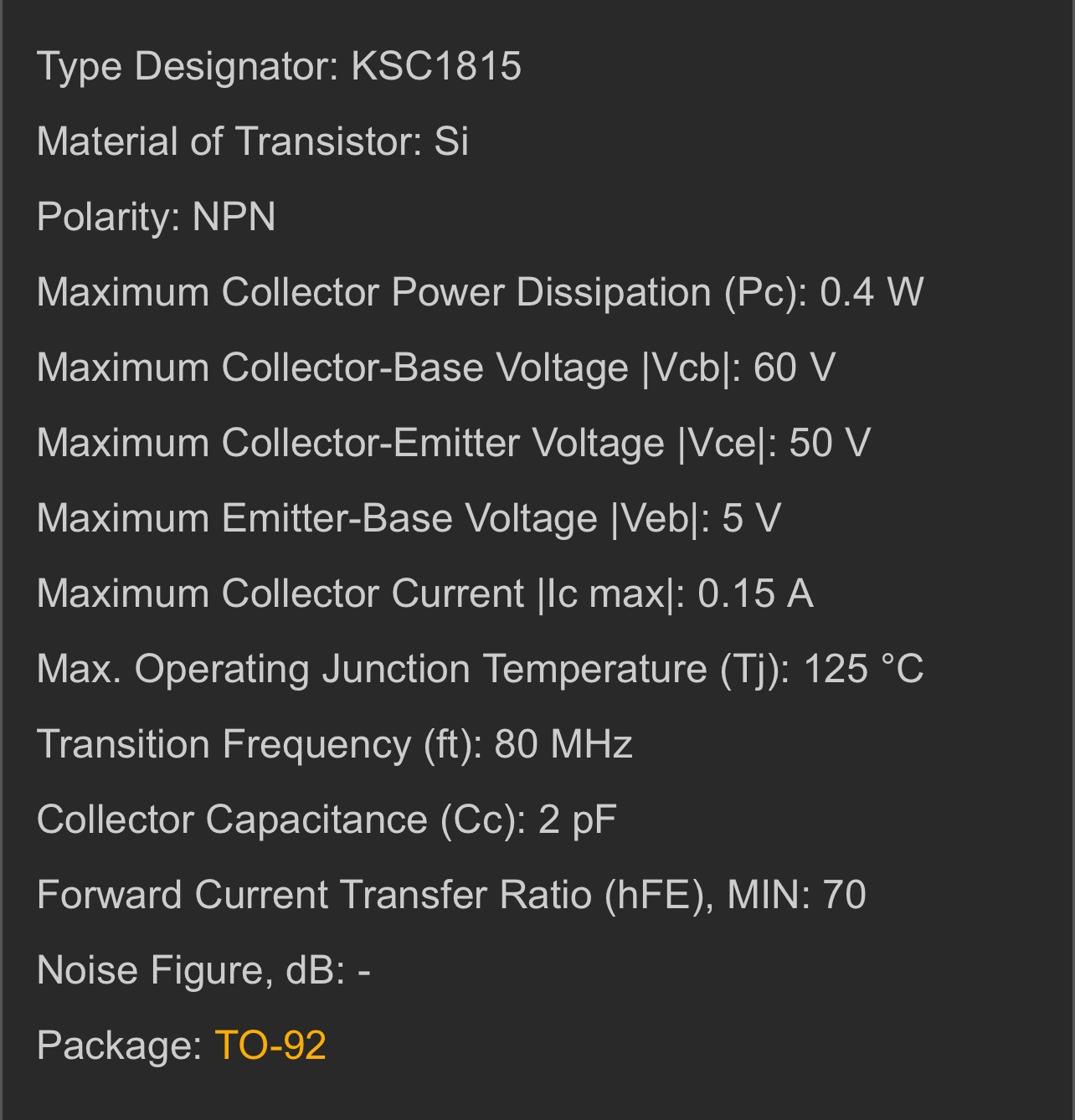

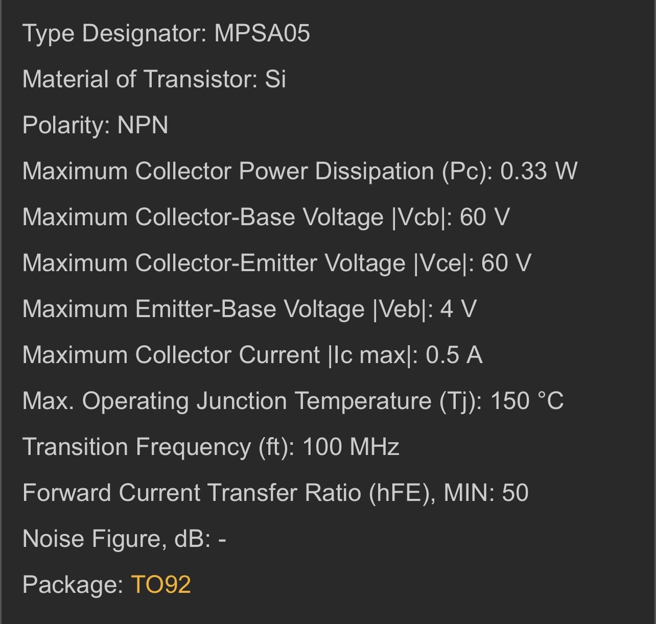

These two look better, though still not up to the 170 MHz. The KSC1815 having slightly lower rated Ic, may not be an issue.

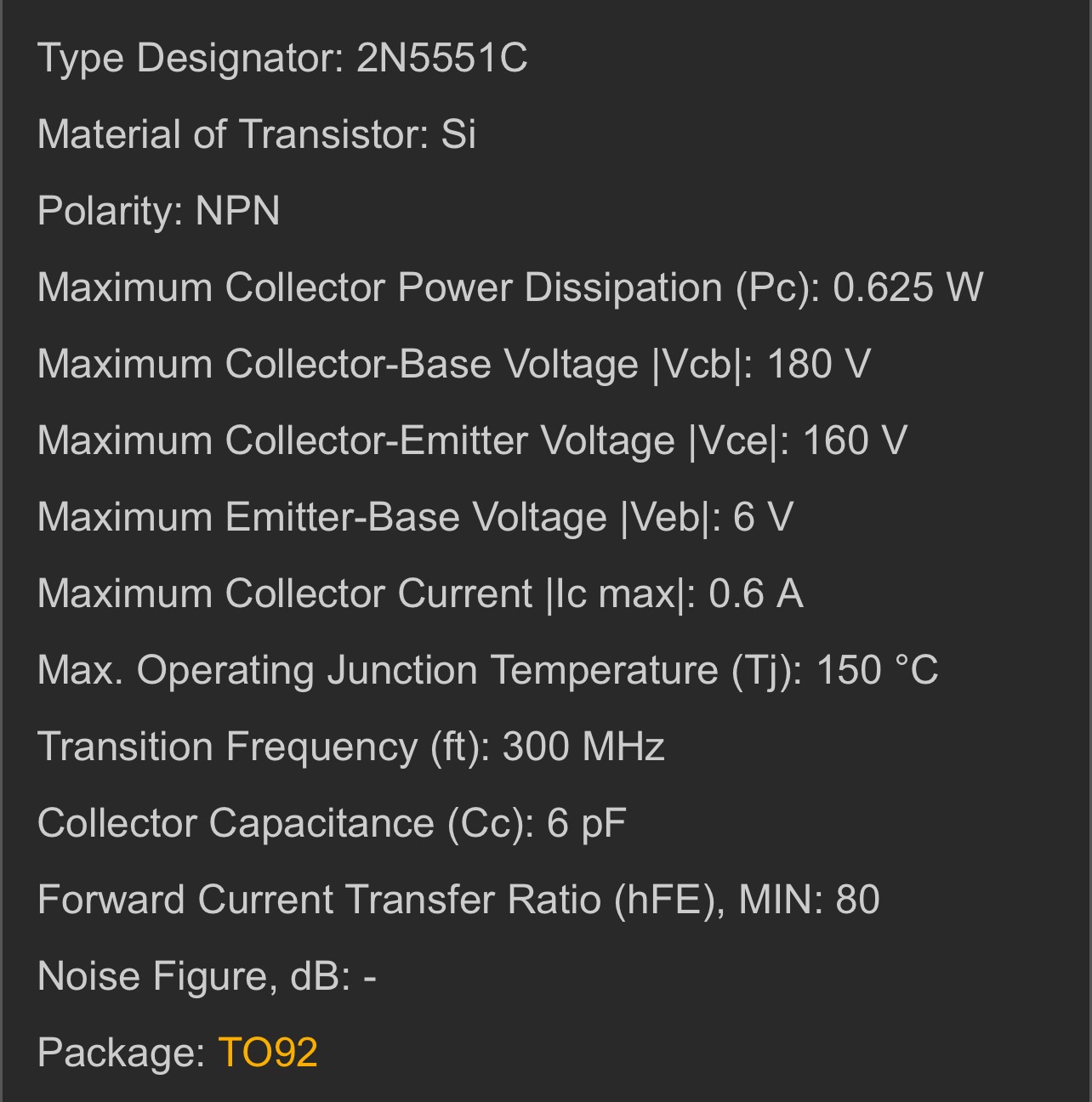

I was wondering about the 2N5551C, but is going from 170 MHz to 300 too big of a jump? I worry about the stability, but if people recommend dropping by 150 MHz then maybe it doesn’t matter all that much in this position.

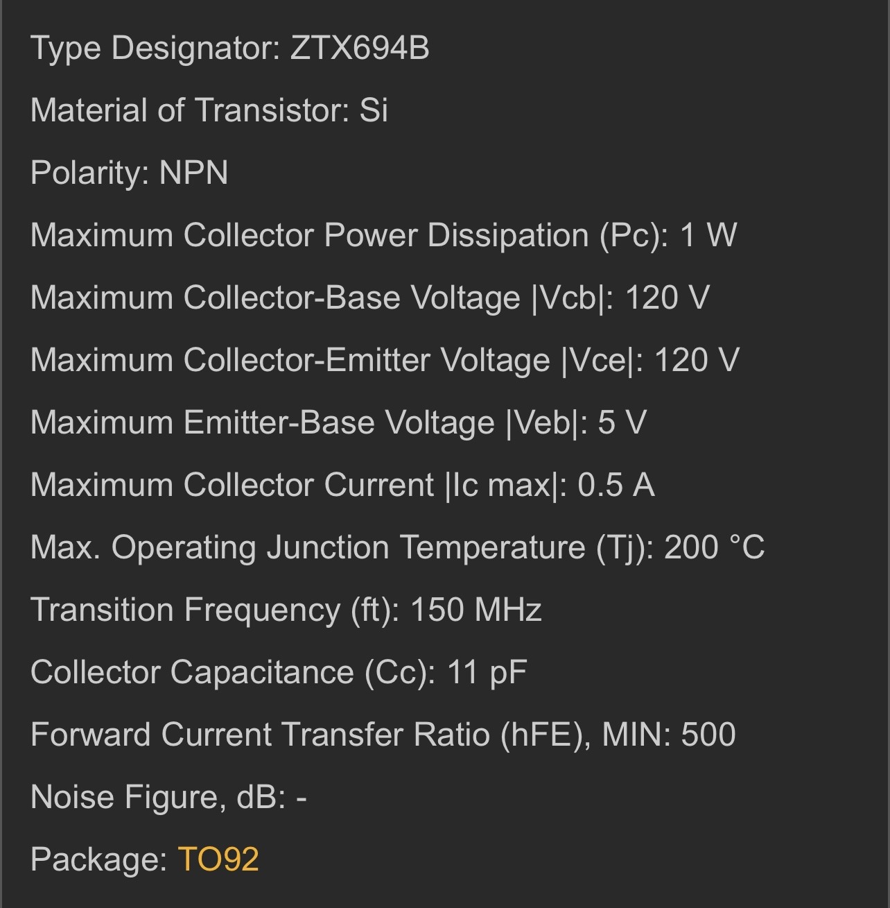

The Zetex was another one I was thinking would make a good replacement. Ft is quite close and it’s overkill elsewhere. My only concern here is the gain. It’s going to be a huge jump. The lowest ZTX694b I have will probably measure 550-600 on a Peak Atlas DCA75.

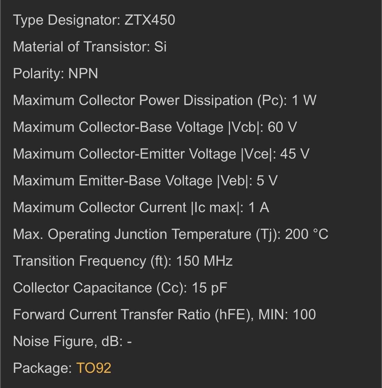

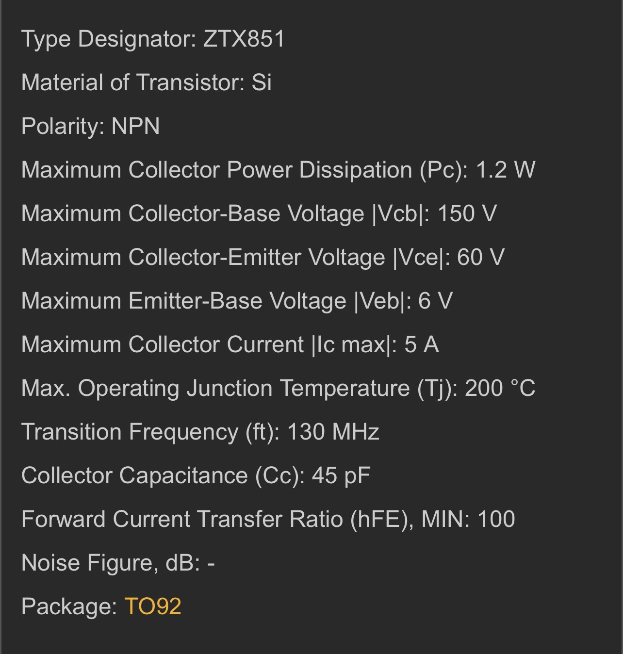

Found a few more contenders. The ZTX851 seems like and absolute beast in TO92 package, but the ZTX451 looks like the better fit.
In general, given no other choice, I'd go up in Ft as long as the circuit is well-compensated, and it sure looks like it is. The response will be more determined by the compensation than the transistor.
More Hfe is probably a good thing in this circuit! More available feedback should reduce distortion.
The capacitance of the ZTX851 is a lot higher than the other options, not sure if that's an issue at all or not, considering the compensation caps around it...
Feed it square waves and see what happens. /shrug

If that’s the case, then the two that I would think I would go with since I have so many of them would be the 2N5551C or ZTX694b. Higher gain versus higher Ft.

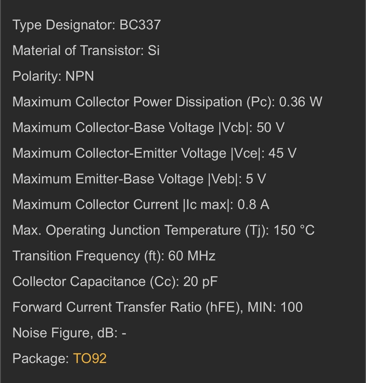

Seems you may be in uncharted waters. Maybe install sockets and try a few different transistor types and see what it does to square wave response at their inputs and outputs.
For that VAS transistor, maybe KSC3503? It's a TO-126 case, will fit fine where the TO-92 was, and better heat dissipation due to size. You don't need the 300V Vce, but it's got super low capacitance anyways.
2n5551 and pnp 2n5401
The pins may be different both are E-B-C
The PN2222A is 60v 600ma To92 as well
