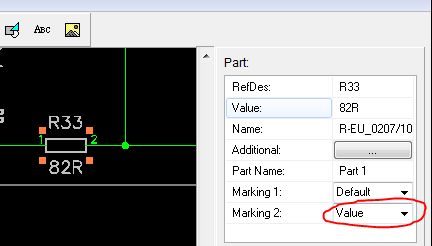

regarding your question, there are probably several ways. here is one:
as an example, i want to show a value for R33.
in schematic, left-click on component R33.
you'll see a part info screen in the upper right screen.
change the circled "Marking 2" selection from "Default" to "Value".
mlloyd1

so far I like DIPtrace for schematics. very easy to use. can't figure out how to have components values show up next to each component tho..
DIPtrace is nice.
mlloyd1
I was just about to make this post. You did a much better job. Excellent post.
