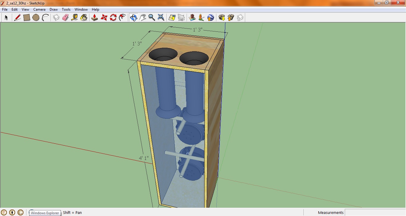

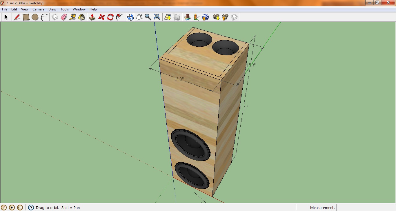

Looking for advice on this enclosure
I'm considering this design for my living room. My goal is 120dB from 20-30hz and 130dB from 30-70hz. Room size is 16x12. I plan on using the Sundown Audio SA-12 for the driver since they are reasonably priced and seem to have the best chances to get the volume I'm looking for while still keeping a reasonably good sound quality. I plan on building two of these and have approx. 2000W on tap. Wondering if it's even possible. Let me know if you have any suggestions for the enclosure or the driver for that matter.

From looking at your drawing it looks as if you will be limited to 10 inch woofers unless you widen the cab out a little bit. Doing that and having the option of using two 12 inch sub-woofers could get you a lot closer towards your goals.
