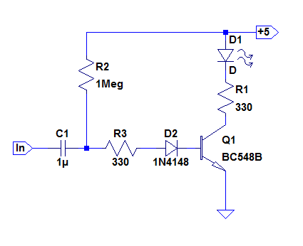

I have made a quick breadboard test of this little circuit, and it seems to work quite satisfactorily:
It operates consistently from very low levels to ~infinity, and can be tweaked on many parameters: for example, R2 sets the quiescent/average brightness, R1 the brightness of the music "flashes", C1 the response of the peak detector.
It is shown with a 5V supply, but it could be adapted for any voltage
