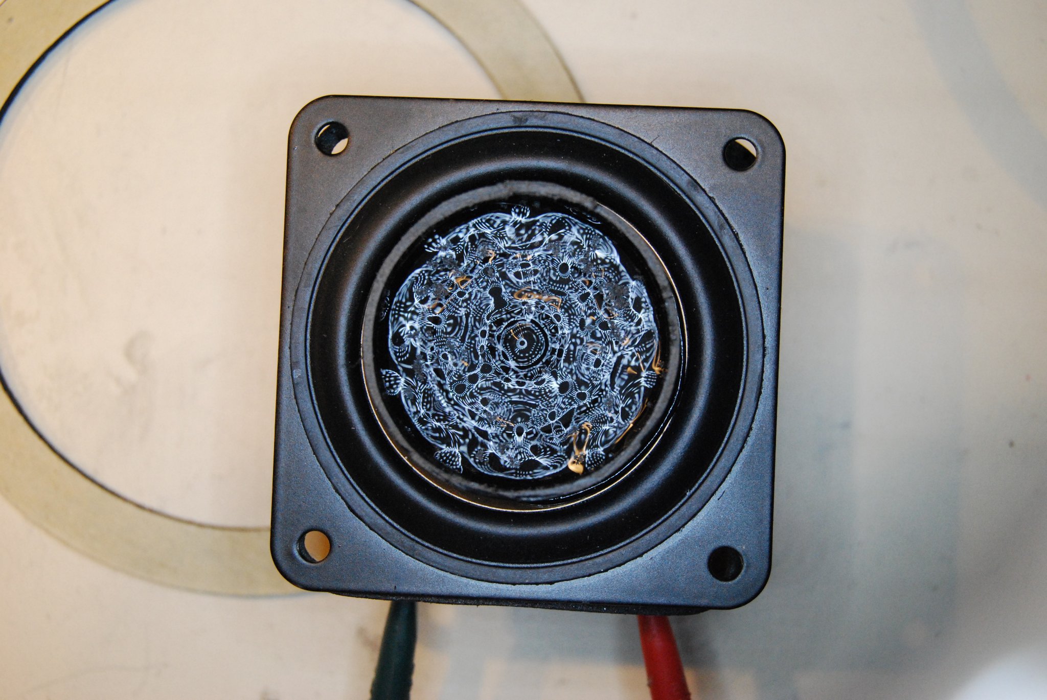

There are many of us out there doing cymatics in water using small speakers. I started out with a 2 inch woofer with a 35mm film can lid glued to the cone.
Peerless by Tymphany TA6F00 or TC6FD00 are great for this purpose. Around $15.00 US from Parts Express, I'm sure you can find vendors in the UK as well.
Water in the plastic film can lid, and illuminated with a cheap LED ring light.
The speaker is used without an enclosure, and no baffle, so you can get lots of cone extension with very little power input.
A little amp of 1 watt is plenty powerful to bounce the water right out of the cup.
And the published frequency range of the speaker is irrelevant, since you aren't making audible sound, just cone motion.
They work very nicely at 1 Hz and up!
Attached is one of the first glyphs I made back in 2007.
Happy experimenting!

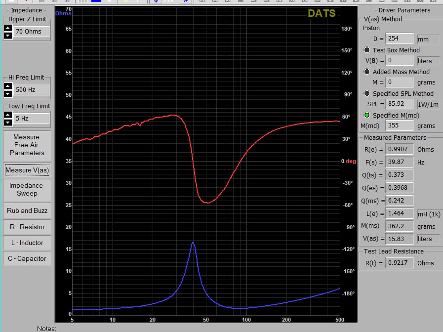

Using this 12" with 34mm Xmax as an example:
64 mm peak to peak excursion could be achieved with no lever.

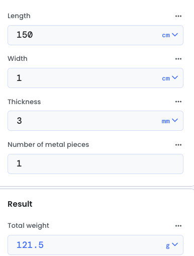

Cutting 50% of the 330grams mms would leave around 165 grams available for a lever assembly with no more moving weight than it would normally shift.
A lever made from a structural aluminum like 6061 150cm x10cm x3mm would weigh ~122 grams.
The lever weight could be reduced considerably cutting circle or triangular holes and still have plenty of strength to wave a string.
