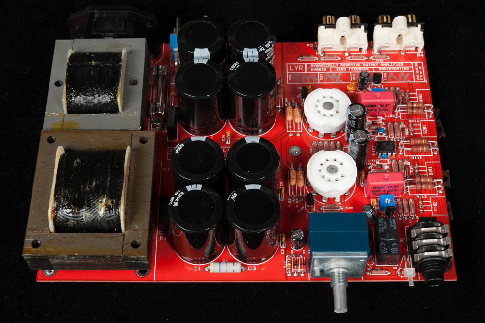

I was pretty happy when I test drove the Lyr (http://schiit.com/cart/index.php?main_page=product_info&cPath=0&products_id=3) and it was nearly exactly what I was looking for except not DIY friendly.
Any tips as to what I should search for?

There are many similiar designs posted on the internet, basically a tube gain stage with a mofset output. The good thing is a high Vrms output since the classic OPT is replaced by a mosfet output, the problem is dc servo or caps (pick your poison) and tube speaker amp level distortion. Do you really need that much power? If you do I would recommend Beau's hybrid aikido thread in the tube forum, he has tackled mainy of the problems with hybrid amplifiers.

So other than having tubes and MOSFETs, any hints about the actual circuit?
I see two twin-triode tubes and four MOSFETs and what looks to be two power transformers (high, low voltage most likely). Blurb says 6 W / 32 ohms, that means push-pull output, and it also says zero feedback. Something called "Dynamically Adaptive Output Stage" which could be a number of things ranging from very clever to the pathetically simple but end result is a transition from single ended at low output power to push pull operation at high power.
Burns 30 W, can output 40 V p-p (~+/-24V rails on the output stage)
So what are you looking for exactly? Since a tube voltage stage and a MOSFET output stage are two independent circuit blocks, you can take any MOSFET buffer (singled-ended or push-pull) and any configuration of tube voltage stage and roll your own at will.
You can be be a little clever and weld the two together, like this , but to be honest you don't gain all that much from doing so.

I pike up a Lyr, its a nice design. I think a DIY version would cost considerably more but the reward could be great. I think the tube stage could be improved upon with B+, better tube operating point, etc. And obviously a better power supply for the mosfet stage. Obviously this will cost much more money that the Lyr, so I wouldn't want you to think of a diy Lyr as being a means to save money.
Basically following the hybrid aikodo topology. Where we have a near perfect preamp stage followed by a push-pull lateral mosfet buffer. The tubmos is one option but a better one may be to use the Thor output (using the jfets just to bias the mosfets) , the jfet should be quiter than the TL431 in the tubmos.
I think the main goals of the project should be better Power supplies/transformer, betterdrive from the tube stage (operatng point topolopgy), better tubes than the 6Dj8's and lateral mosfets. Would be great to get in all on one PCB. A lot of fertile ground for the ortho owners.

I did a little probing on my new Lyr, the tube stage is a simple common cathode, resistive loaded plates with the shared cathode ccs, operating point with my less than fresh amperex orange globes is 110V anode, 2.7V cathode, which gives me about 3mA per tube . Its a good design, not some enemic chinese SRPP run 100V B+. Its quiet with Grados so the B+ regulation must be good stuff. The p-p mosfet output is well laid out. The coupling cap in front of the output stage is a decent Wima 4.7 MKP4. If I hear a room for improvement the bass seems a bit too snappy/harsh at high high power levels (fine at normal levels).
I guess a DIY version could be done for about the same price without a whole lot gained. Would do a little better with a more linear operating point, more like 125V/5mA.

Tube+MOSFET hybrid headphone amps are bit ... uninteresting. They are basically two fully independent sections, one high voltage, low current, the other low voltage, high current. Since the don't ideally share a common power supply, the circuit design quickly devolves into a tube preamplifier and a MOSFET headphone buffer that just happen to share a common chassis.
As for the Lyr, I'm sure it's a solid-by-DIY-standards design, given it's heritage. I'm most interested to know how the dynamic biasing is done:
I've seen amps with this general design claim surface a few times over the years, but never seen a circuit schematic to tell me exactly what is being done.It works by sensing the current flowing through the output stage, and dynamically reconfiguring from Class-A single-ended to push-pull Class AB.
Not all hybrids are unitnteresting, with these new orthos we need to swing upwards of 17Vrms, that equivalent to a 35watt amplifier for speakers (without has much current delivery). If you had looked at the EHHA it is not a tube stage plus separate buffer. Its a differential input-VAS-currentbuffer all shared powersupply with global feedback, just has a tube differential input instead of jfet.
Even the lower model orthos need a solid 6Vrms swing into 38 ohms which is a challenge for SET tube folks.
I think the dynamic biasing just means the output stage is push-pull biased around 100mA, and when the volume/load high enough it goes into class B just like any heavily biased class A push-pull stage. But I didn't look at the mosfet stage, the Lyr does fit your tube preamp + mofset stereotype.
