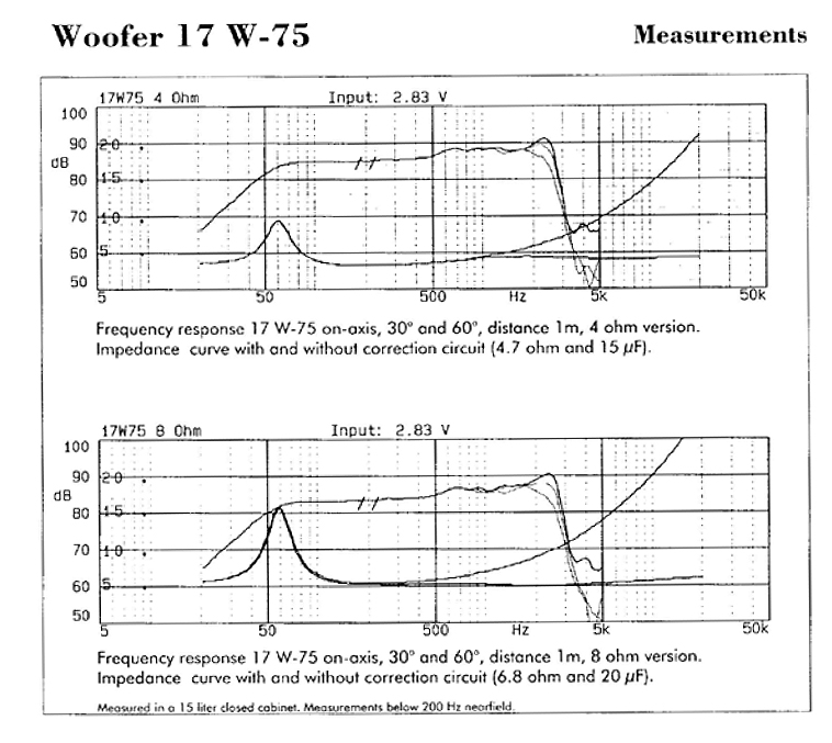

Hello everyone. I thought I would try here to get some info on the poly or (mixed poly) woofers out there. I have had in the past (Dynaudio) speakers that used poly woofers two sets of them. The thing I liked best about them was the voices but, the music was way to dull and very dark sounding or should I say laid back. Well I am out to help a friend of mine with his two way speaker project. I really have no helpful hints because I am a paper cone driver fan. So Is there a very good built mixed poly or poly cone out there that doesn't sound plastic or dull? Please help me! If you have any helpful hints that woud be great. Thanks Mr Daniel

The poly cones don't sound dull, unless person building
speakers with these, want's it so or does not know what he
is supposed to do with them. There are more than a few out
there with poly cones. Peerless and SBA are good and not
overpriced.
Check the FR manufacturer supplied for the Dynaudios.
Acoustic roll off at high frequencies appears to be already
low passed, and these are measurements without XO. When
one is not carefull with filtering this kind of driver, dull
sounding speaker would be no surprise.

I agree with you 100%. I guess I am just use to using paper drivers which is so much more diffrent then the poly cones. ( Like apples to oranges you could say). Also with the dyanudio's I wish I could have heard them with the right set up? ( I did call the company and tell them that my drivers were sounding over lapped ( working or pushing againest or fighting agianest one another if this makes sense?) They told me that was the way they made them so I sold them. Well again thanks for your help. Mr. Daniel

Nevermind the binding posts. They are never an issue.
There is no such thing as sound of plastics or paper
or metal cones or whatever. I have made enough speakers
with different cone materials. They always sounded the
way I thought they should be. Transparency above all.
I use Dynaudio drivers, bass, mid and tweeter not because
they are so special. Nonsense, there is so many fine drivers
nowadays. I bought mine for a reasonable price and I like
the cool looks of one piece molded poly cones with the
addition of not having to build notch filters.
You can use whatever brand and materials you prefer and
get excellent results.
