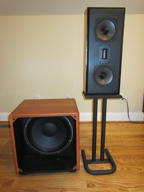

I'm experienced with active speakers for the last three years using the GroundSound DCN24 and now the DEQX. To date I've been using the NHT M60 and M80 speakers. This will be my first attempt at selecting my own drivers and building my own speaker. Using the prebuilt enclosures will give me time to evaluate the drivers and crossovers before deciding on the final 3-way drivers and full range cabinet.

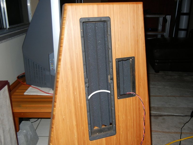

I auditioned and measured about a dozen different cone drivers from arrays of 2-3" mini drivers to high sensitivity full-range units to things like the Scan Speak 15W and a Lambda TD6 before settling on the Neo10. There's something about a good push-pull planar used correctly that has an immediacy and snap to the sound that I've heard few cones get right. My implementation is an OB with the rear wave of the Neo10 semi absorbed. It is an attempt to blend the rear radiation pattern to more closely match the Raal above and OB loaded woofer below. I think in a closed box, you will have better luck running the Neo10 a little lower, but make sure to have a good amount of Bonded Logic or other quality absorption inside the box, but spaced behind the Neo10 surface by at least a few inches.
Oh and a word of caution, IF you do try the Neo10, use crimp terminals on the ends of the wire. Don't bother soldering directly to the tabs. The diaphragm is somewhat gentle and if you are not quick or remove the wires several times, you may damage the driver from transferred heat.

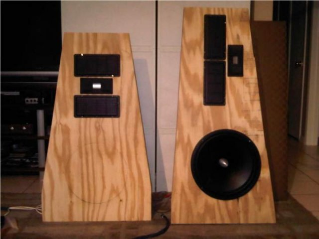

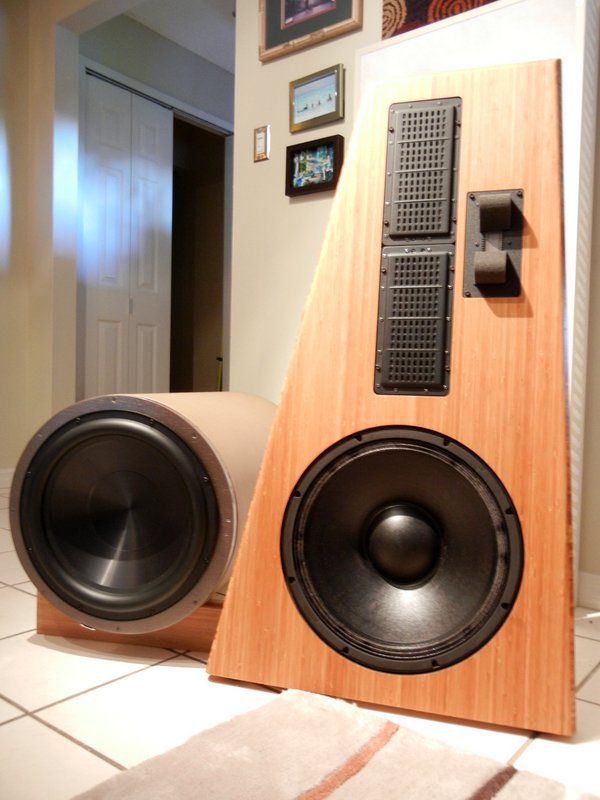

Great minds think alike. I have an open baffle midrange with PHL Audio 1240s in an MTM and Aurum Cantus G2 tweeters. Eminence 3015LF Neo Kappitalite woofers in H-frame mounts handle the lows. The 3-way crossovers are via a DEQX PDC2.6 HD at 175 Hz and 2500Hz. I'm using 96 dB/octave slopes.
My MTM baffle came from a P-E Dayton Audio 1 cubic ft box.
With these higher sensitivity drivers you have extra dynamic range which provides sound with body. I like it!

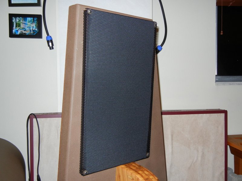

I like the look of the two Neo10s alongside the RAAL. Any concerns with them interfering with each other in the crossover band? One of the reasons I've chosen the RAAL is to get larger soundstage. My room has an abundance of absorption material (for bass) and the NHT M80s I'm using are very directional. The combination of the two has created a very tight soundstage.
I was thinking the center would be a horizontal MTM. Would I still want the Neo10s that close to the RAAL? Perhaps I could do a WMTMW for the center if I build the right enclosure.
Do the Neo10s need a capacitor for protection with the DEQX? My understanding is that the RAAL is very fragile to clicks and pops and must have a protection cap. The DEQX HDP-4 has an annoying pop when the digital input sampling rate changes (from 44.1 to 96khz for example).
I started out with the Raal using a large value cap(30MFd) for protection, but after the Digmoda amps proved to be dead silent on turn-on/turn-off, I've since removed the cap with no problems. I never had a cap on the Neo10. That's a tough one if the DEQX pops. Better to use one then to be safe.
You are correct about dispersion being a possible issue. The Raal will be very wide at crossover, while a pair of Neo10 side by side will be equivalent to an 8-10" driver, so at 3KHz, their horizontal dispersion will be narrow. As you can see in my set-up, it kept the Neo10 stacked, so they are more like a smaller 4" midwoofer in regards to horizontal dispersion. These are all things you could test and play with yourself. You can buy additional PE blank baffles for cheap to use for prototyping.
If you really feel ambitious and like the idea of narrowed dispersion, then maybe the side by side Neo10 would suit you if you could narrow the Raals dispersion. I wonder if you could create some kind of the large foam waveguide of sorts. Or you could try something radical and mount the Raal horizontally which would make it's width about the same as the Neo10 and do an MTM that way. I did something similar during prototyping with BOTH the Neo10's and the Raal sideways, but in this case maybe just the Raal?
