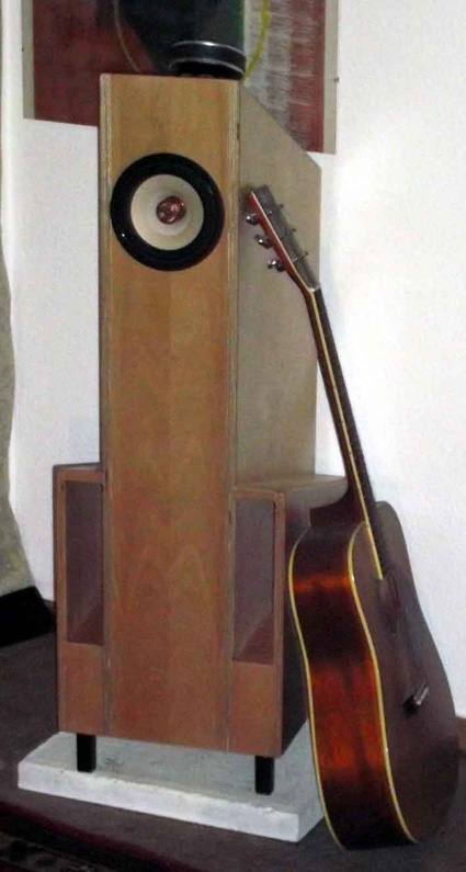

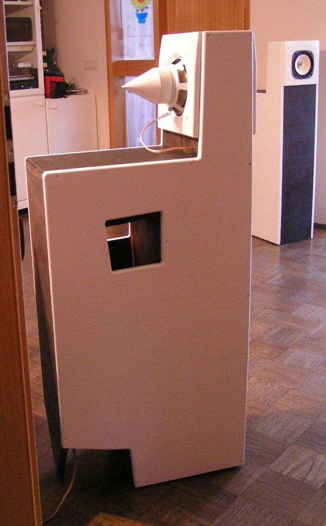

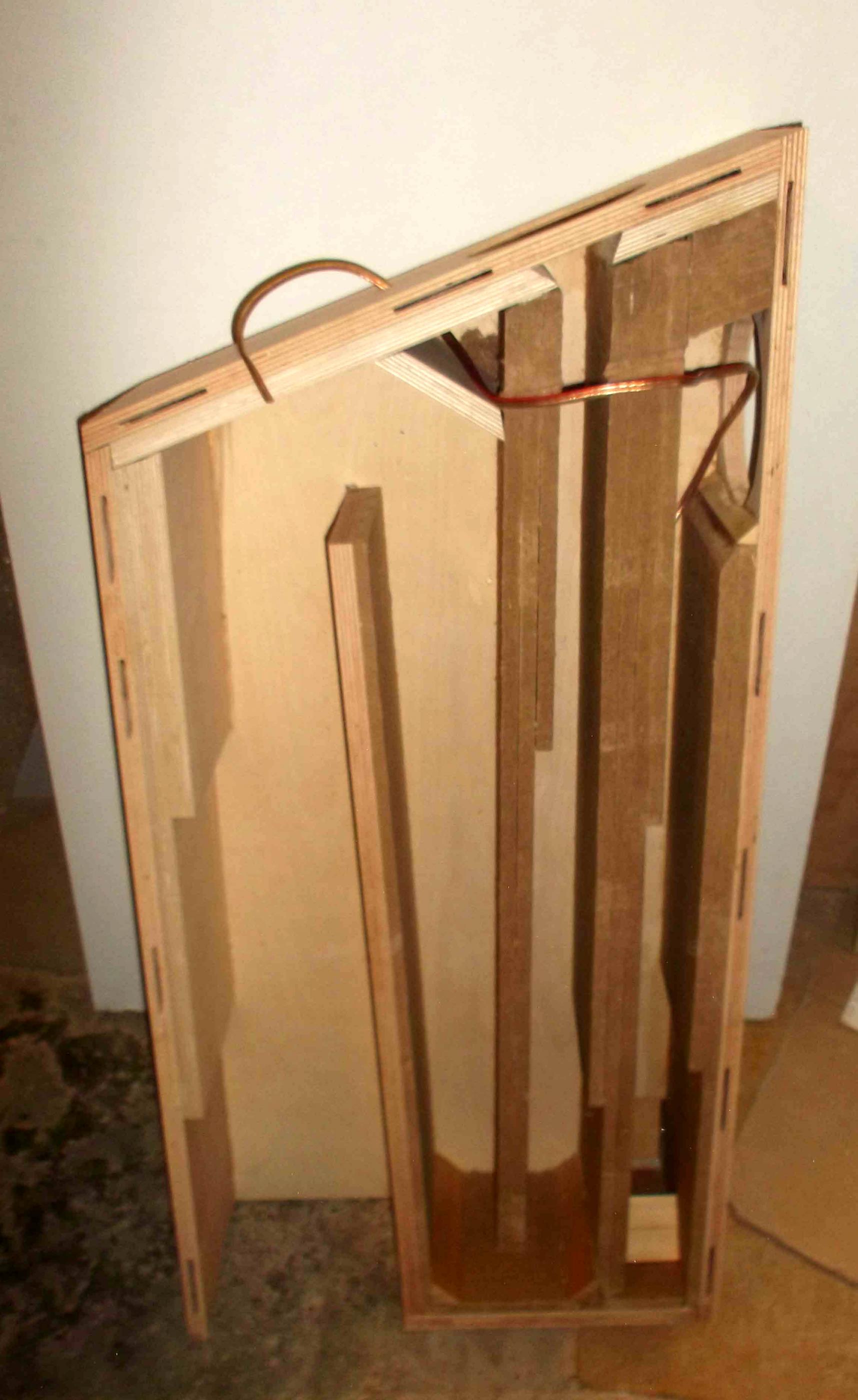

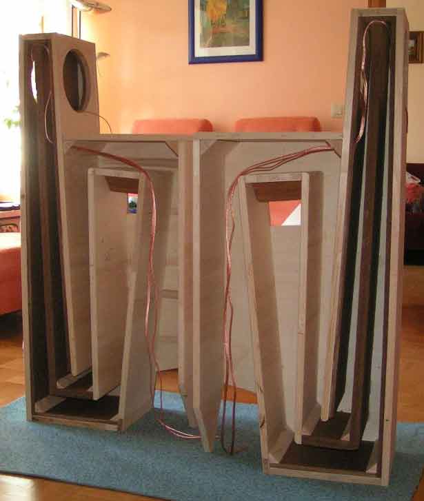

6,5" double horn KANGLING
http://www.diyaudio.com/forums/full-range/245962-kangling-double-horn-technic.html
take a view with measurements kangling
or the POSAUNE posaune
